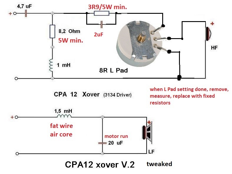

We have talked about it in the thread, I think several times. The only value I changed and played with was the 2R2 series resistor for the tweeter. Bewtween 2R7 and 4R are more fitting values for home use, IME. But needs adjusting to taste and room. Obviously, higher values will attenuate the tweeter. The max limit will be when the highs seem a bit muffled. Once there, back down a bit on the value, and you are there.

So you didn’t add a parallel cap to this resistor and a limiting lpad like here?Bewtween 2R7 and 4R
I did use an Lpad too at one point. But I never added a parallel cap. Not sure if I have seen that specific schematic. What is the purpose of the parallel cap?
ever heard of Newman compensation?

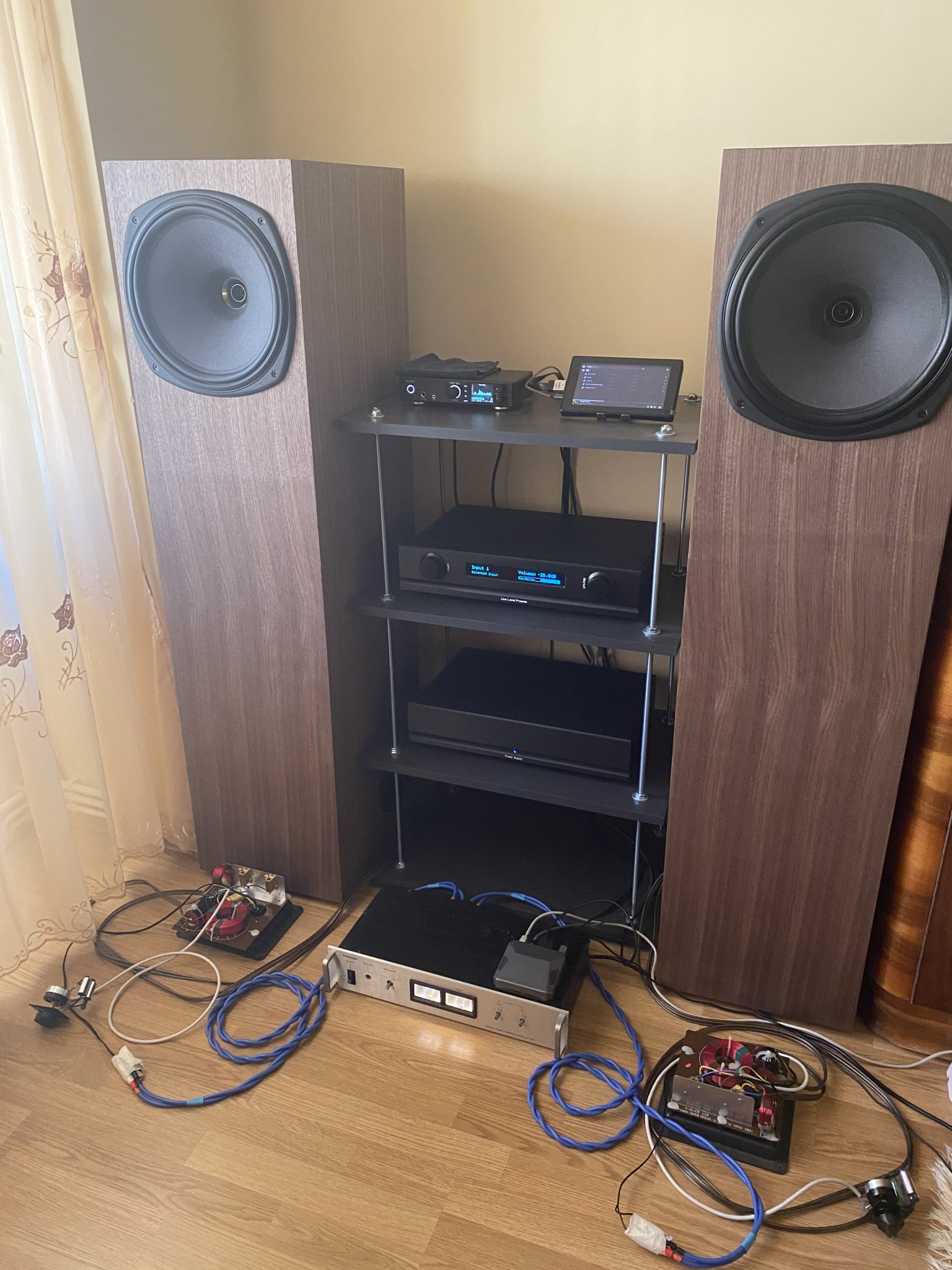

This morning they look like this
The bass seems it’s coming from a subwoofer with these enclosures.
The soundstage was good already with the small enclosures, with the mltl it gained something more in the vertical plane.
Now it’s time for some music. My back had enough for these days 🙂

At the moment using an hybrid crossover, done with components I had on hand following CPA12 schematic.. will also try to implement this above xover in due time..So you didn’t add a parallel cap to this resistor and a limiting lpad like here?
Is the series resistance value of 8,2R resistor + 1mH inductor resistance known? i.o.w. should this sum be 8,2R or 8,7R or more?
not that critical
judging by pics, Rdc of that choke is in range of few 00 of mOhm
Sch can measure that, but wrestling with DMM residual ..... who cares
