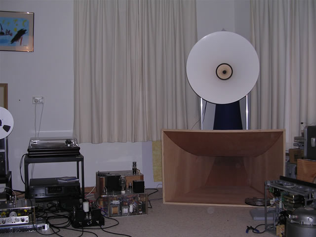

Good means the good, as in opposite of bad... Driver model is the TB 1772. Horn is the Azura 204. Desired peformance is to load the "low end" (down to cutoff freq) to compensate for the rising response, and maybe some directivity controll. (?)
That's because you didn't use the right horn for the job, though if the driver sounded like crap to start with, a horn isn't going to do anything but tonally balance its response over a wider BW than a simple baffle.
Hmm, unless the Azura was either designed for the TB or a driver with very close specs, then it's not up to the task. I guess I'm not understanding the situation. I mean either the Azura meets the needs of the app or it doesn't.
One thing though, to load down to cut-off either means some throat distortion/beaming or an incredibly large WG, especially if there's any directivity control (DI) to a low frequency. Anyway, based on published specs, this driver only needs loading to ~233 Hz, so if you're planning on a higher cut-off, then it will be strictly a WG.

Though I can not be 100% sure, the combo should be very good.
I've had a period of experience with Lowther PM4 and Oris 150, that combo was very good. One of the best sounding home use speakers I've heard, within a certain SPL, of course. (oh, and you'll need something for the bass section... )
Any other low-Q, up-tilted response widerangers should also be similar.
Talking about Seas, I think of years ago I once played Oris 150 with Jordan Watt 6"er alu cone fullranger. That speaker looks like this:
http://audioart.audionet.com.tw/141/images/1/a.jpg
That Jordan Watt Flagon has a very warm sound, somewhat colored and thicken mid to midbass. This couldn't be a good candidate for horn loading, but I tried it just for fun.
The horn throat was for 8"er so didn't match the smaller Jordan very well. And lacking of any mating hardware (and also in a hurry), I just "put" them together. Horn mouth lip touched the floor, flagon and horn throat on a stool, they sang, beautifully! LOADS of details and so much improved dynamics. What a shock! And much to my surprise was that the range wasn't any narrower than the original speaker! I think it's the floor helping in the bass and nearfield listening helping in the high. Great fun!
