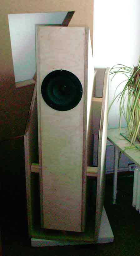

No BCS, No EQ. The driver is in an MLTL, not on an EIC baffle.
The 4.5kHz notch only starts to appear in the 30* plot, so at normal listening angles -- 10-15* -- it is probably not an issue. The 6.5kHz notch coincides with the sibilance peak in most pop recordings. The effect is softening of the "s" and "p" sounds. Interestingly, this notch appears in every driver I have converted to phase plugs. I have to wonder if it is not the effect of the phase plug in THIS driver. The HF peaks are so narrow in terms of octaves, that you will probably not hear them. Look at these peaks as a continuing of the general rising FR.

Well yeah. I was hoping for something with less of a peak in the 4k to 7k range, and a little more efficiency than the B200 that was the same dimensionally yet was close enough in T/S parameters to drop in my aperiodic boxes. Hope springs eternal.
