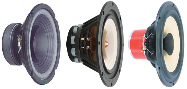

There are many more but here are three full range drivers sure to please ranging in price from around $30 to $900... I must admit I have been enjoying the B20 without dustcap for the last few weeks even without a tweeter and they are very satisfying. Not perfect, but enjoyable and musical. I like how this driver is tweakable... the TB looks fully tweaked already and the Seas i wouldn't dare cut up.
