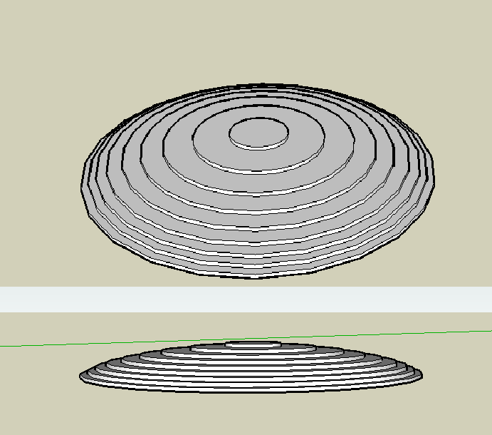

Actually, from the woodworking point of view it’s not that hard to make. Granted that I have a shop and a 5hp 220v 3ph shaper. The expensive part would be a custom made knife for a shaper head. Due to the out rich of this knife it would be done on the specific type of shaper head that is if I am not mistaken called Colete head (I do have it just don’t remember the name). Then a couple of templates would give the external radius.
I am not at all saying that the work is not good, it’s just not impossible to do and other Diyers that are crazy about horns could have it done.

My guess is that it's turned (on a lathe), not cut with a shaper. Yielding 3 (maybe only 2) sections from a blank.

See if you can find Yuichi Arai's old webpage as that had a lot of useful photo's and tips for building these. Mine were made by a LOT of hand sanding.
I had swivel head one a few years ago that you easily turn a 24"blank on. It needs to be a fairly substantial unit, not the $150.00 local hardware store model.

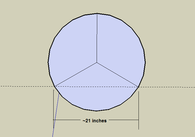

Illustration below shows 3 from one 24" blank, with the maximum width of the part 21".

1446 is the one I have. It’s a heavy duty one and weights a lot. It’s limited to 23 on the paper so you could do 24-25inches. It would be a bit scary, spinning a heavy piece like this. All thou a laminated Baltic birch plywood, would insure uniformity in the spinning mass. I think a template would insure consistency of a shape.
I will repeat MJL and advise anyone from using a cheap home center lathe.
