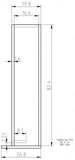

Hi guys, I’m doing a folded version of tabaq for faital 3fe22. I’m wanna ask if Its ok to fold the line in this way. I attach the profile of the folded transmission line to see if it’s ok that the offset part of the length in the line is behind the speaker and not under o upper the speaker.
As nas3000 says, should be no problem to fold this way, although I would not do the rounded internal corners you show. Do it like nas3000 drew it, with square inside corners. This keeps the overall internal volume the same no matter how you fold it, as long as you keep the length the same, measured along a line drawn at the middle of the profile, with square corners.
Someone who understands this more than me can correct me if I'm wrong, but I have read elsewhere on this forum that rounding the inside corners of a TL is detrimental, and by my calculations, as I said, it changes the internal volume from that of a straight line of the same length.
