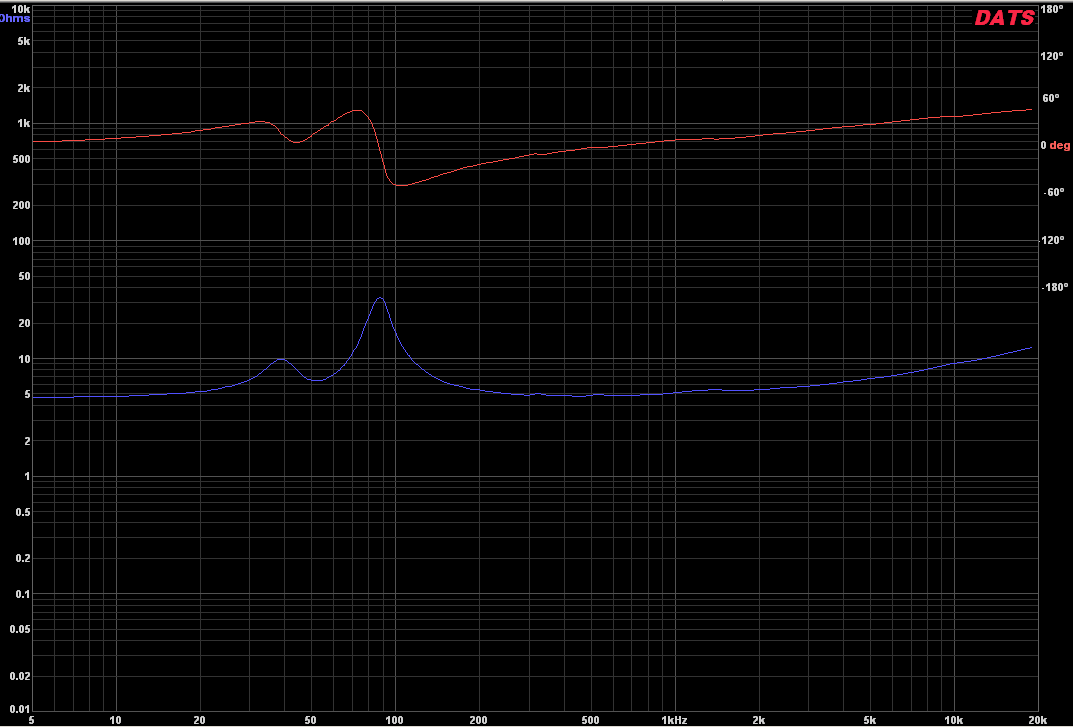

I have done some sims to see if it is possible to increase the mid bass by adjusting the design.
The answer is Yes, you can - but you loose the low bass.
However, this might be an idea if you are looking for a speaker with more punch - suitable for your taste of music.
Please take a look at the dokument attached. It is based on a 4 inch driver.

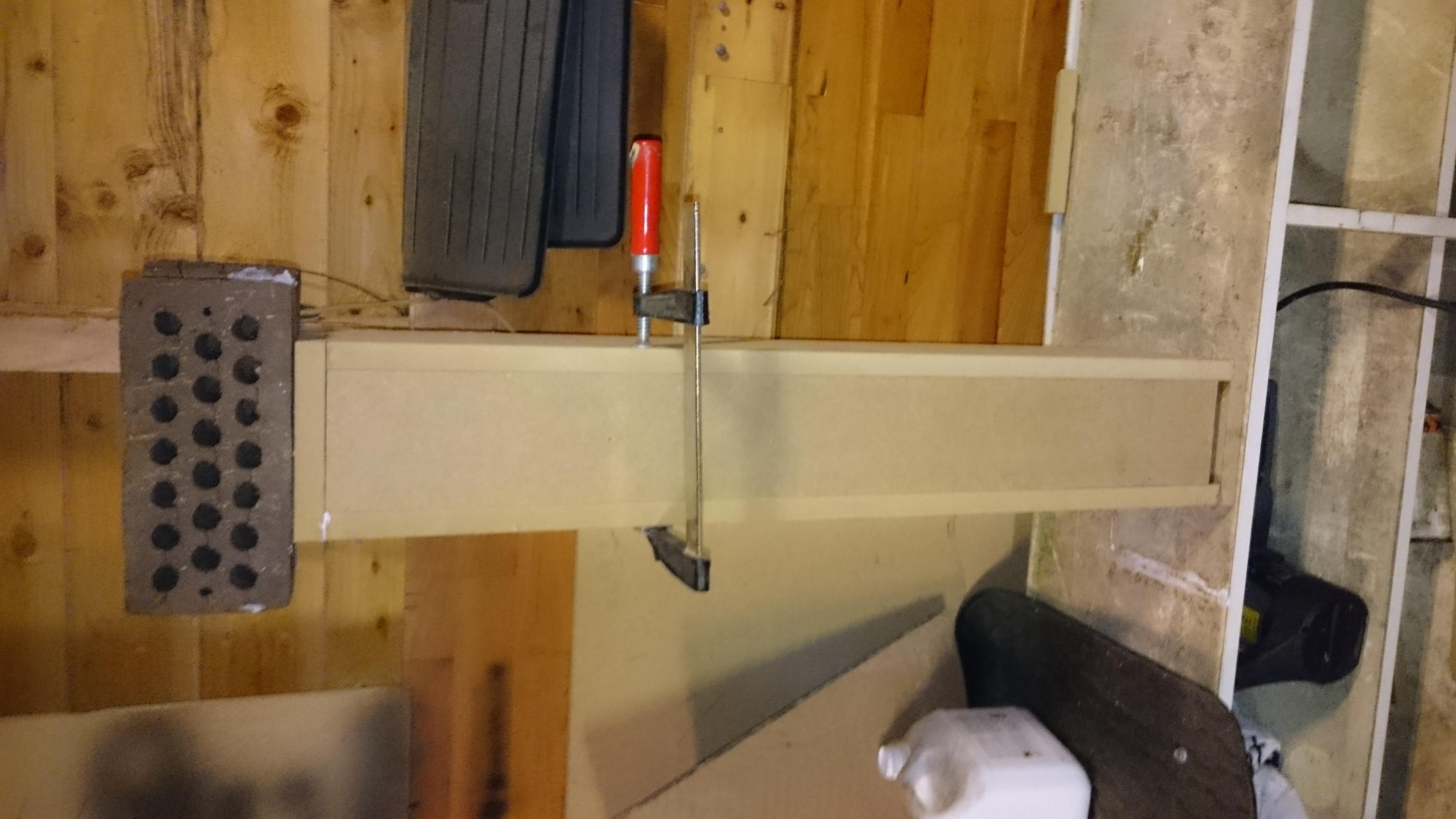

The building have started. 🙂
I was surprised how tiny these are. They look larger in pictures. Looking forward to hear them sing.

Sorry... not much to look at. I'm using blue foam boards to make a few tryouts. So far, I have a 0.37x Karlsonator, and a folded TABAQ. Will have a head-to-head test tomorrow!
There always seems to be some leak when I use hot glue on the foam. I think the glue is melting parts of the foam, unlike the gatorboards (foamcore) which is laminated with paper on the outside, protecting the foam from the hot glue. So, I have to tape all joints.
Not pretty, but it works.

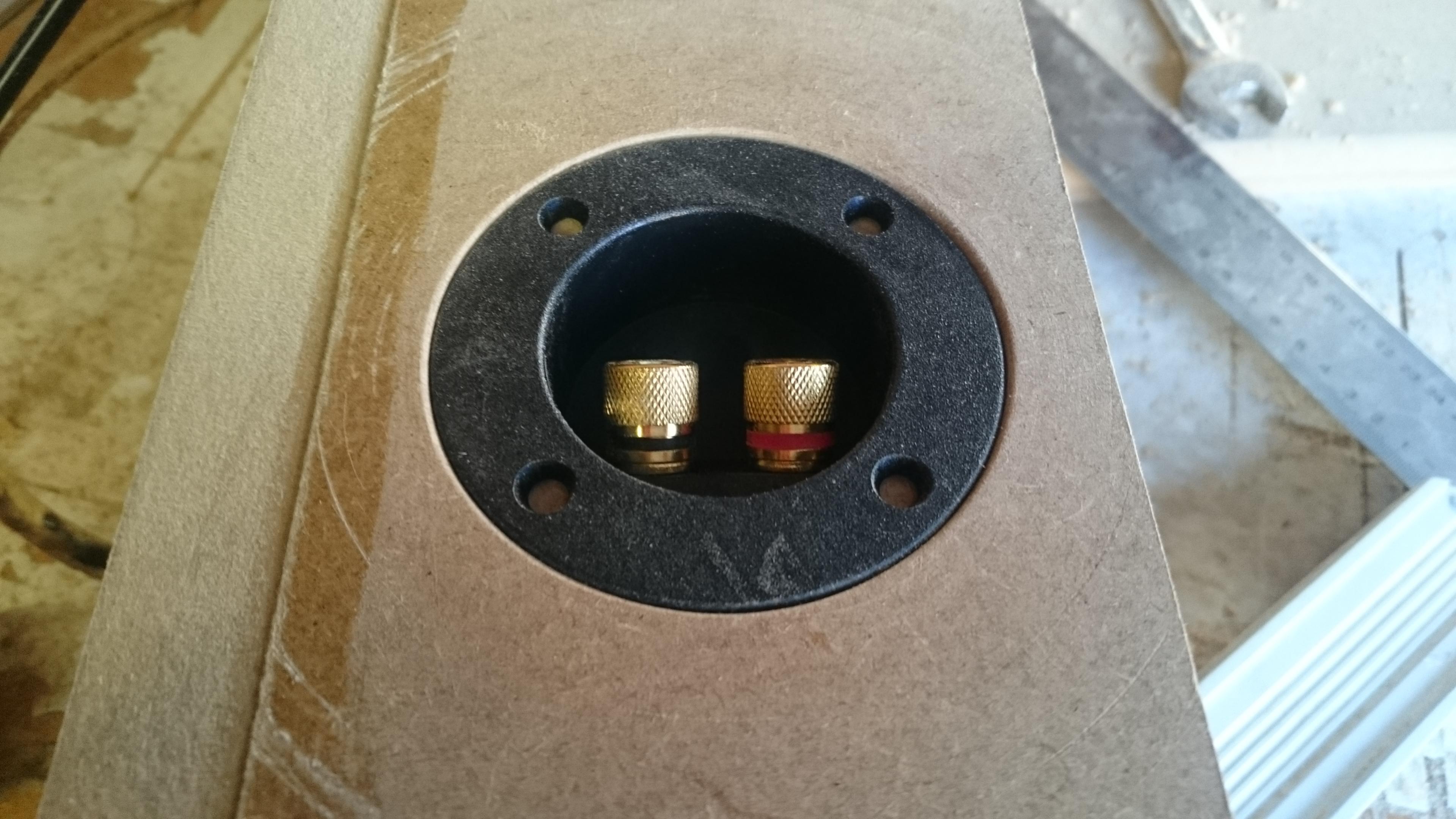

Sand paper will take a lot of time I installed my speaker binding posts today using a router. On speaker no 2. I used the wrong bit for the recess and didn't notice before I finished the hole. It took me 30 min with sanding paper to enlarge rhe hole.
I included "carefully" as if using a power tool with high grit paper, the MDF might melt away quickly if the job is done too enthusiastically.
