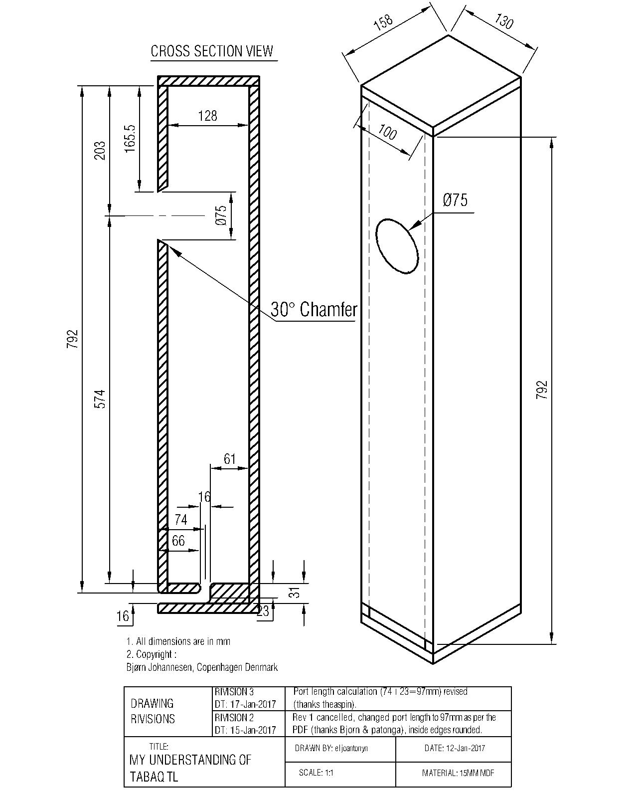

OK guys, I'm gonna start the build today !
And before I start, I just want to confirm my drawing is correct or not !

Look, don't worry too much and begin your build. The Tabaqs are a pretty flexible design and tolerant of minor changes so go ahead and start building.
Why would you want to spend extra money on exterior grade MDF? You're going to have some kind of finish on the boxes, aren't you? Whatever that is will come later. Start making sawdust! 🙂

In terms of perfectly following the concept, it's still wrong. In reality.... It's very much close enough. 🙂

NOOOOO 🙁In terms of perfectly following the concept, it's still wrong. In reality.... It's very much close enough. 🙂

No-one has yet spec'd the parts for the rear "L" of the "reshaped" port - that I am aware.
Need a rear part to the main enclosure floor and a 15x16x10mm part for the "rear port wall".
In my drawing, the port length of the front =Horizontal distance 74mm + vertical distance 23mm = 97mm. In that drawing, the center of the port is placed 59mm from the front panel's inside wall.
If we do a port on the rear wall, the total port length would be
Horizontal distance from center of port to back panel backside 84 + Vertical distance 23 = 107mm.
So, port in the front and the back would have different lengths.
But, if we move the port to the center, then the port path length would be 102mm for front and back, ie., symmetrical !
Would that work ?

No no no no.... I am not suggesting any changes to the format.
The "blob", rectangle, at the back on the floor of the enclosure. Parts are not defined for this. It could be a block of wood or layers of MDF/wood, or it could be two pieces of MDF at an 90 degree angle . Whatever it is, it's not in the parts list.

Do you think that the difficulty eljoantonyn is facing with his box dimensions is primarily arising from the fact that he is using 15 mm thick MDF? It's adding 3 mm to his baffle and also 3 mm to the vent shelf. I had another look at the altered dimensions you posted in Post #1501. It looked fairly straightforward to me.

I think it's straightforward if one has access to tools and a workshop/shed type environment.
If getting parts cut by order, you'd want to be precise.

There is no port at the back - only at the front.
The revised port is due to the fact that the actual build has a port that is just a little longer than the sim.
The alteration was just to make a port 100% equal to the sim. For 3 inch drivers I would use this outline of the port. Not with 4 inch drivers.
It should be straight forward to make the correct port lenght using material with thicker dimemsions.
Yes the part in the bottom right cornet coould be a piece of wood or several pieces.
