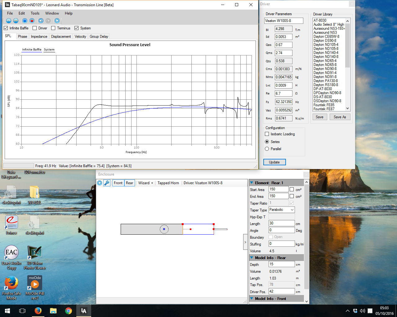

But only 0.5mm Xmax... Wouldn't that limit the low end that could be reached? Especially for the TABAQ.
Only one thing for it then.... Make it into a FAST Tabaq. 🙂
Visaton W100S-8 or maybe Dayton ND105-8 as the woofer will net you an F3 in the high 30s to low 40hz range. It does need to be sim'd as "everything" changes, albeit slightly.
As I've thought about the above, it occurs to me that these enclosures are slyishly narrow.
The FR driver would have to be in it's own compartment at the very top. (Try to fit it lower would block or mostly impede the line).
Speakers would stand over a metre high.
Hi Jerms,
If I'm reading your enclosure specs correctly the cross-sectional area of the main compartment is 150 cm^2. The original TABAQ has this at 4 x Sd, so would increasing your csa to more like 200 cm^2 improve the sound as well as giving you the space to squeeze the larger driver in? You could also then shorten the enclosure to maintain the same internal volume.
Rob.
Rob.
