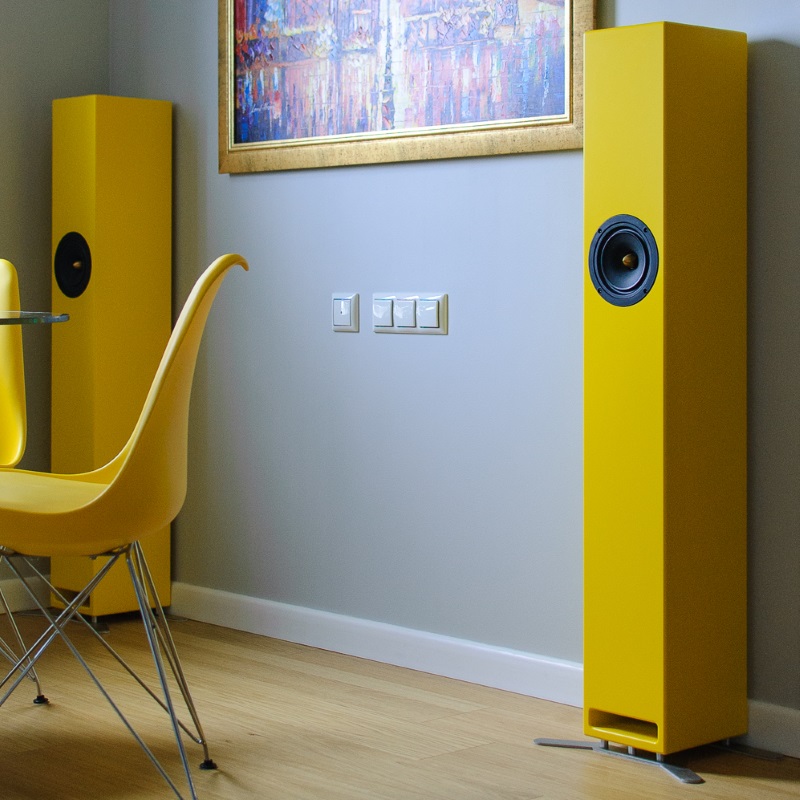

Try to find a 3" or 4" driver to put in the TABAQ. You'll probably get better bass than with that 2.5" driver you mentioned. That's the magic of the TABAQ with its balanced extended bass. Plus, that tymphany has a ragged response above 10k which would probably annoy me enough to cross it to a tweeter.
Here are my large TABAQ's with W5-2106. Not truly DIY as enclosures were made professionally 🙂
Even though their placement is far for perfect they sound very nice with more than enough bass. I'll post some measurements later.
Many thanks to Bjørn for providing the build plan!
