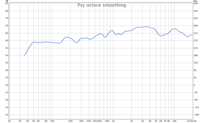

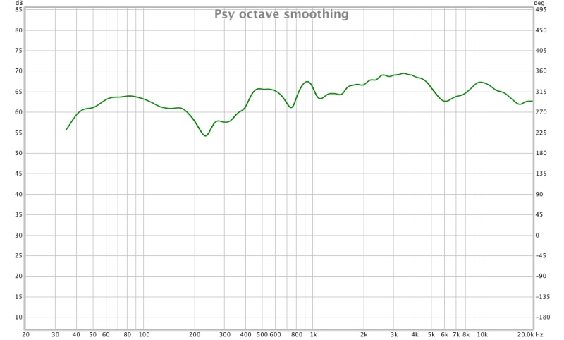

While trying to measure another driver/enclosure, I have noticed the same drop above 10k... which I know to be impossible because the combo is able to get to 20k easily, so please discard the previous measurement sweep I posted...
I need to find out where the problem is and what causes the huge drop after 10k. Then, I'll re-do the sweeps with hopefully more accurate results.
Sorry!
Ha!
This is more like it. The blue line is taken in free air, mounted on a stool 45cm off the floor, 1 meter off the wall... so no bass boost from wall and floor in this measurement.
The green line is directly one a wall and floor. There's almost 5dB gain but room nodes causing a dip around 230Hz.
I usually tame the two "hills" at 2.8kHz and 10kHz via EQ on my iPad music app (EQu) and it sounds quite good.
