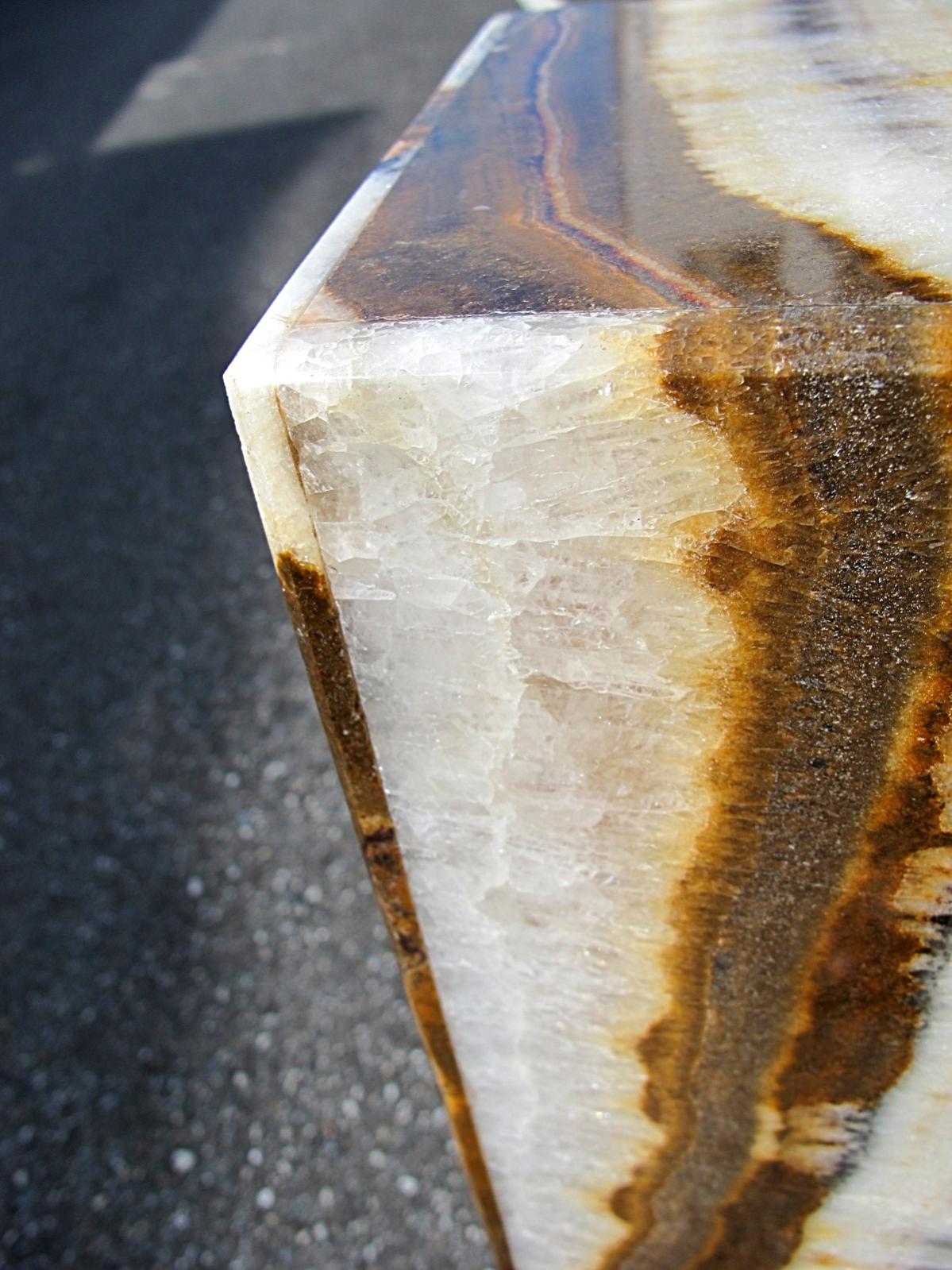

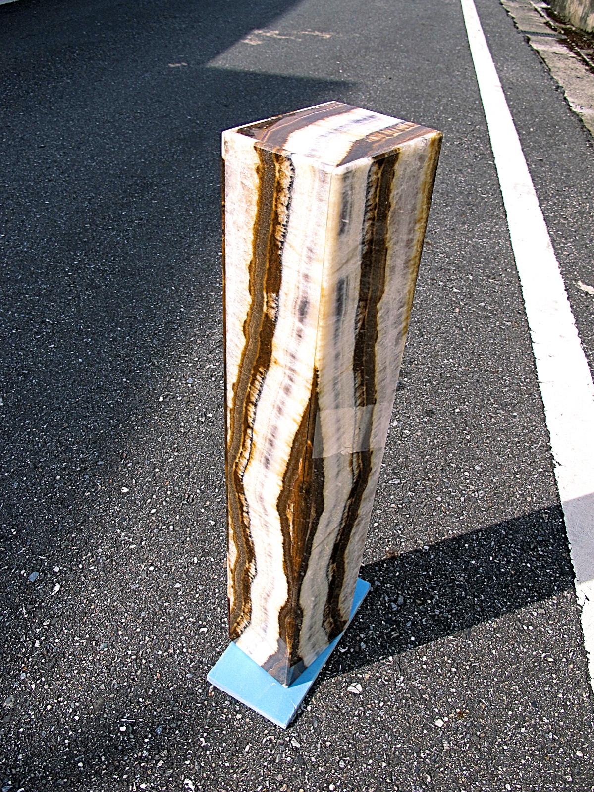

A friend of mine wanted me to build him a set of TABAQs, and since I needed a project for a prototype I needed, I combined the two.
Result is quite stunning. It's a stone called onyx.
I still need to add a baffle, and get a pair of drivers for them. The Tymphany 830987 is out of stock at the moment.

Wow! Beautiful speakers man!!
:cheers:
Thanks!
Now, I've got the end-user breathing down my neck... I'm not sure he wants to wait all the way till October for the 830987 to be available.
What's the next best one I could get?
I've been looking at MarkAudio, and a bunch more.... There's always a catch I don't like about them while looking at responses.
Most new TBs have a very low Qts, and not sure how they would sound in this now.
Suggestions?
