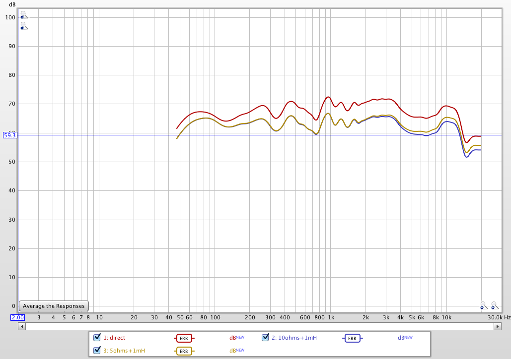

I finally found some little parts locally. I found this little inductor, 1mH, for less than a dollar, and some resistances.
I tried to apply 1mH + 5 Ohms, and 1mH + 10 Ohms.
This is the effect without anything else and the Aura driver in the TABAQ.

Great find! Sure beats paying $10 for an air core inductor of same size! Sounds fine doesn't it ?
With BSC in place the bass is a lot more present and powerful.
Yep!
I always felt the bass was there, just subdued by a "screeching" of the driver higher up. Now, it feels a lot more balanced.
I would still apply DRC to them if they were my main speakers, they really shone when I did, but they are doing classroom duties at the moment.
But... I found it so hard to solder with the tiny wires on the inductor.... I hope they will stay put!

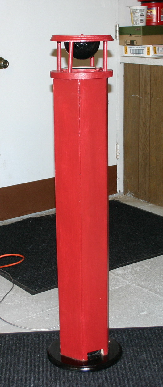

Here is my Omni version of a TABQA. The Hex shaped tube is 37.5 inches long and is stuffed with 4 ounces of polyester. The driver is the infamous RS 40-1354 5.5 " full range. (If a manufacturer would reissue this driver it would be a great seller.) The omni reflector is a 4.5" hard foam hemisphere. It produces a very airy yet firm 360 degree sound field with an F3 of 46 Hz and is down 8 dB at 35 Hz. No bad for a 20 year old rubber surround driver.
Always coming up with some cool sh&t! What is your complete sound impression? What ID is your omni. Those could make up for a nice surround speaker that would fill the room with effects. Sure must be nice with music as part of a 2 or 2.1 system, but with it's F3, personally, I wouldn't need a sub for most music material.

The sides are 5.5 inches wide, (139.7 mm). The internal volume is .5 ft. cubic (14.1 ltrs) . The port is 2 sq. inches. (12.9 Sq cm)
