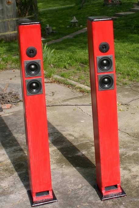

There you go!

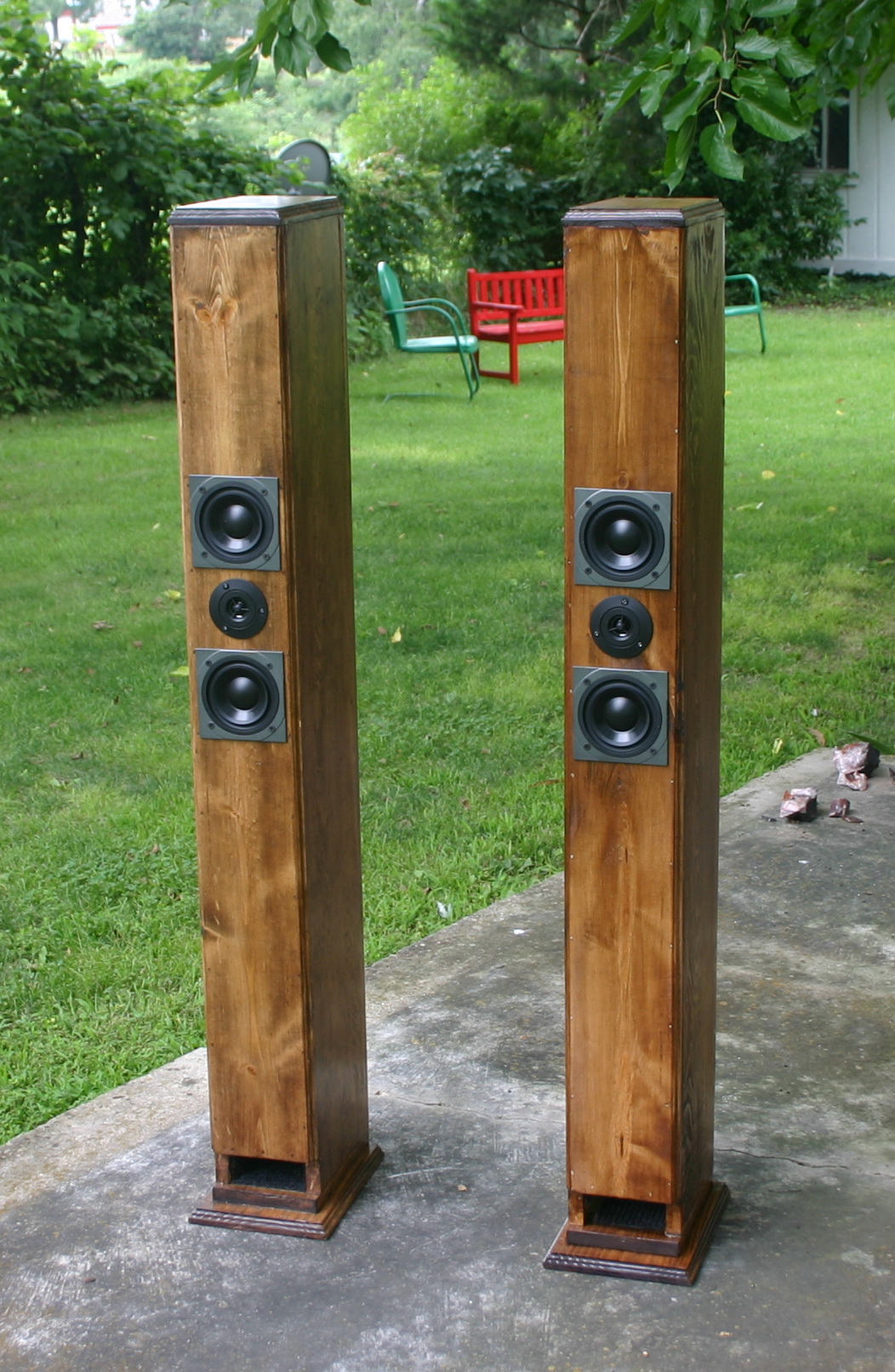

Dual plus tweeter. Did you change the dimensions from the original design?
How does it sound?
How does it sound?

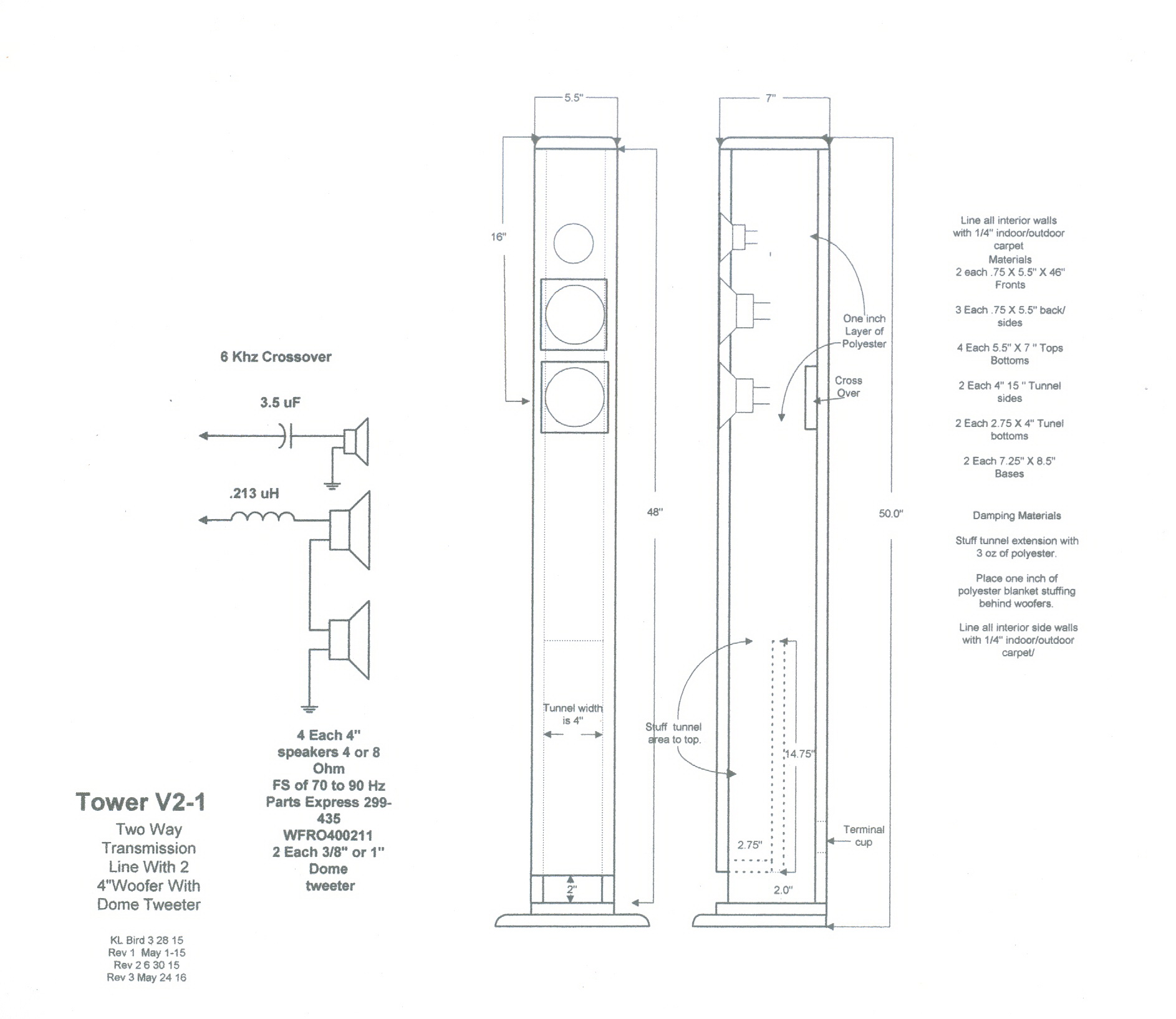

The key in this design are the drivers which are no longer available from Parts Express. Here is a drawing for comments. It measures in the room with an F3 of 50 HZ , and has great imagining.

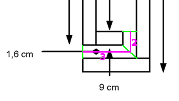

Dimensions for modelling TABAQ in Leonard TL Software
I'm currently trying to model the original TABAQ design using the Leonard TL software, so that I can adjust the design slightly.
I'm not sure about the dimensions to use in the model for the port. What I've got from the drawing so far is:
Section 1: 12.8cm x 10cm x 78 cm long
Section 2: 3.8cm x 10cm x 2cm long
Section 3: 1.6cm x 10cm x 12.1 cm long (open ended)
These lengths of sections 2 and 3 are calculated by taking a diagonal dividing line between the sections from the bottom corner of the port "shelf" piece to the back bottom corner of the cabinet. Are these section lengths correct for putting in to the simulation?
Thanks!

TABAQ Geometry
Hi robskillz - and others!
I have enclosed the "master data" of TABAQ, which is a little different if you make reverse engineering from the construction plans.
I hope this will make it easier for anybody wanting to do their own adjustments or use it as inspiration for other designs.
Regards
Bjørn

Thanks Bjoern! (Hope that spelling is OK for your name 🙂 I can do most accented letters on my keyboard but not the stroked-o 🙁 )
It's interesting how the single port from the model is translated to physical dimensions. In the model it's 9.7cm long but that translates to 10.2cm + the back corner area. Does anyone know of a tutorial for folding TL's (and ports) and adjusting the modelled dimensions to work with corners?

In a folded line the length is measured in the center of the line all the way.
When constructing a cabinet from the model's internal measurements you sometimes make some small adjustments for practical reasons. Small deviations does not make much - if any - difference.
You still have tuning options like stuffing and BSC.

I am confused regarding ports and port lengths.
Everything I have read suggests that ports usually end up far shorter than the lengths calculated by any (!?) of the available box calculators.
What seems to be the case with Tabaq is that the port is far longer physically than calculated.
Clearly there is some voodoo magic going on that I have not mastered.
