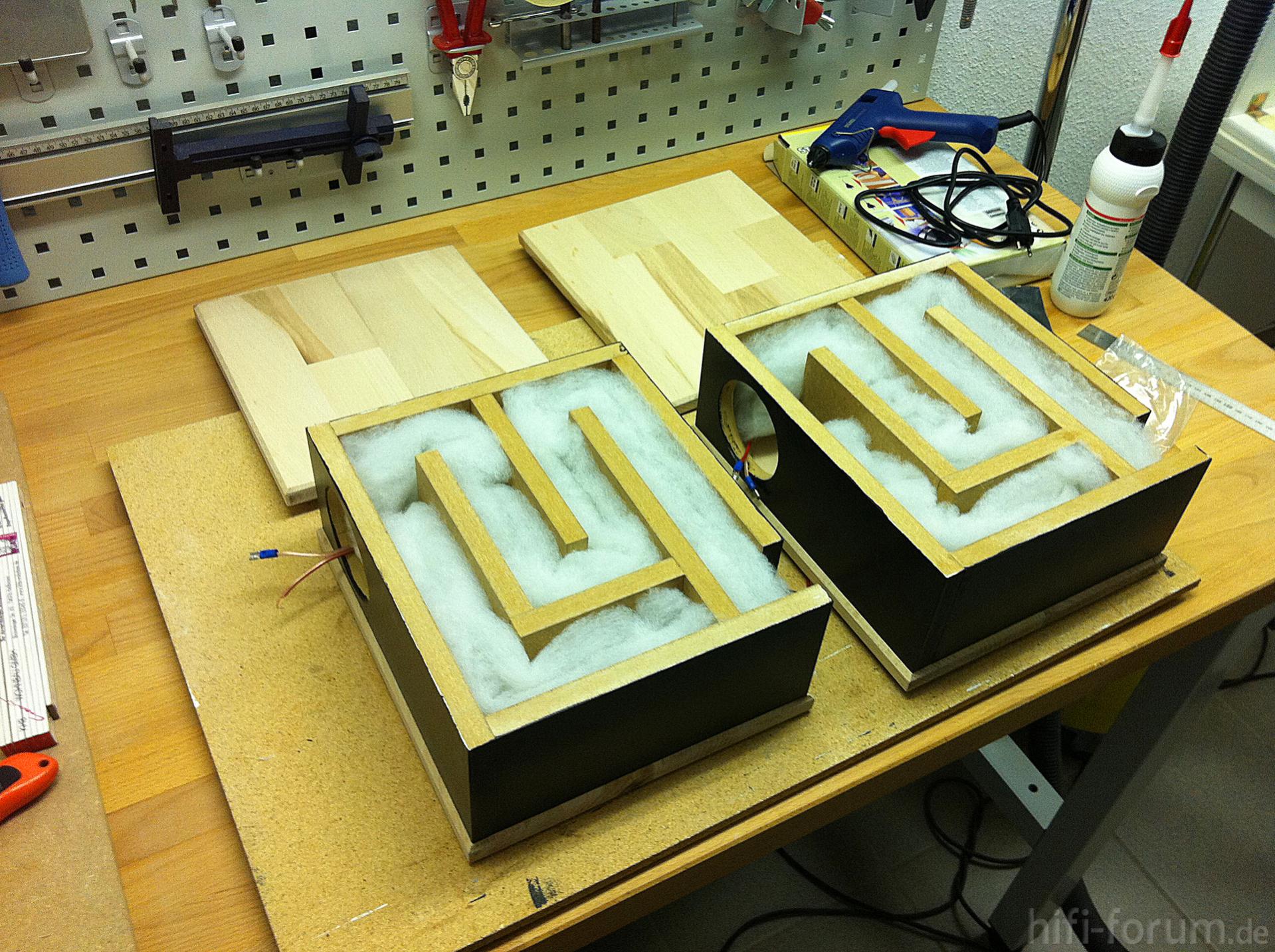

On the desk I would try to move the port to the rear panel instead of the top/bottom. You simply extend the top to the rear panel outer surface (1,3 cm + wall thickness rear panel) and shorten the rear panel (1,3 cm + wall thickness top). I have done this with the "Ten Öre" (see picture). With 10 cm distance to the wall behind my desk it was okay.

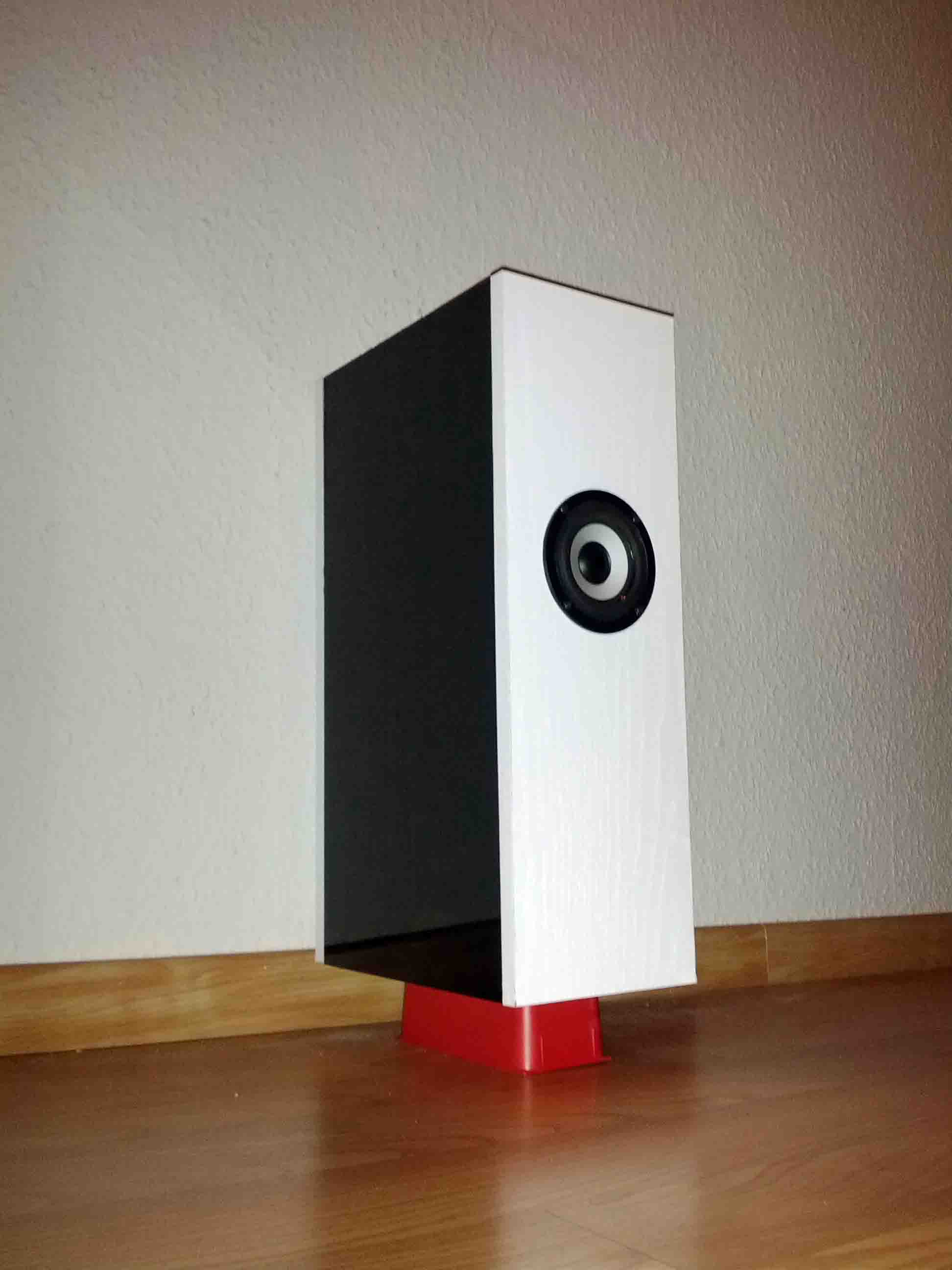

What kind of advantages can one expect from a 2x3" version of the TABAQ? (a tower with double the volume for 2 drivers/tower... a pair of this) what happens bellow 100hz?
Has anybody tried it before?
I don't want to be too insistent but just in case it was overlooked by anybody, I'm still looking for some input. I've heard many people trying to get away with the same volume for 2x drivers but that's not what I'm looking for, I'm "doubling my money" but I want to know what are the typical effects that come with this; i know the low end extension is the same but what about the overall sound... I've heard you get a little line array flavor even if you only have 2 drivers per channel.
You mean a Tabaq with the tang band w23-1287SI!?, that would be interesting, I have two of this drivers wich I wanted to use them in a sealed little box tunned to 200hz for a center channel... But a Tabaq design with this little driver it would a very interesting project...
Hi skirmit, my original TABAQ is now playing with TB 4", so i can not do a direct test. However, the folded version with the 3" sound a little better in the treble. The 4" has a higer SPL and a more tight bass (like i like it).
You will not be dissapointet with the folded and the 3".

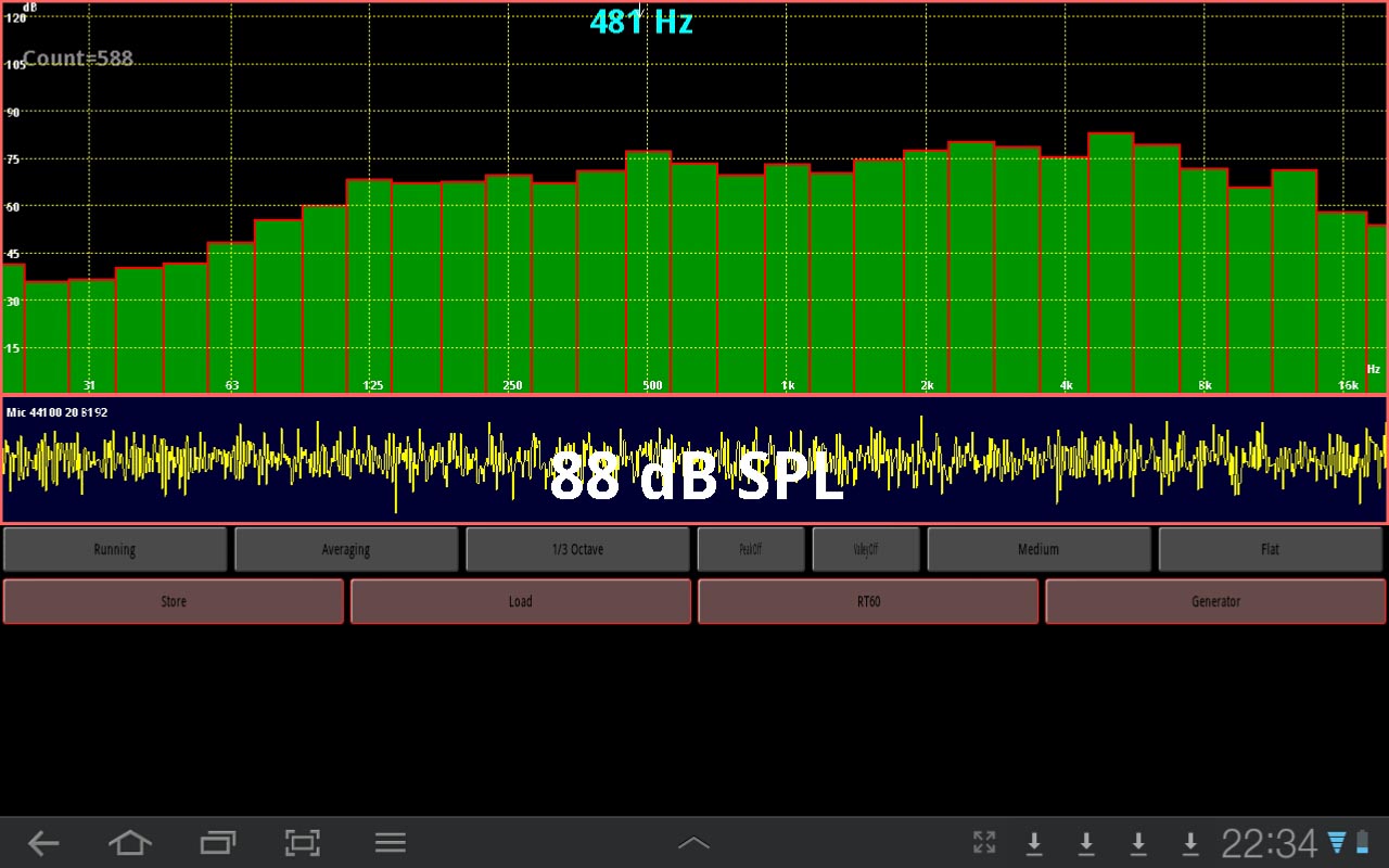

I have enclosed a measurement of the foldet TABAQ. Please note: This is an App on Android (AudioTool) and i get different readings on the smartphone and the TAB due to the build in mice.
No real array effect will be present with only a pair of 3in units per channel, unless you're planning on listening with your ear about 6in from the box, or you mount them a good few inches apart (not a good idea). You'll nominally double the powerhandling & get another 6dB of dynamic range, something all boxes of this type are chronically short of (in absolute terms). However, IMO, if that's your requirement for the end speaker, you'd probably be better off building something for, say, a 4 1/2in driver, which has roughly the same cone CSA as a pair of 3in units, than a doubled TABAQ.
Thank you Scottmoose, but I think there may be other advantages - related to driver placement, one firing up for example, lower distortion for same SPL, more headroom for excursion for same SPL ... but that doesn't tell me how it sounds... I'll find out when I get there.
