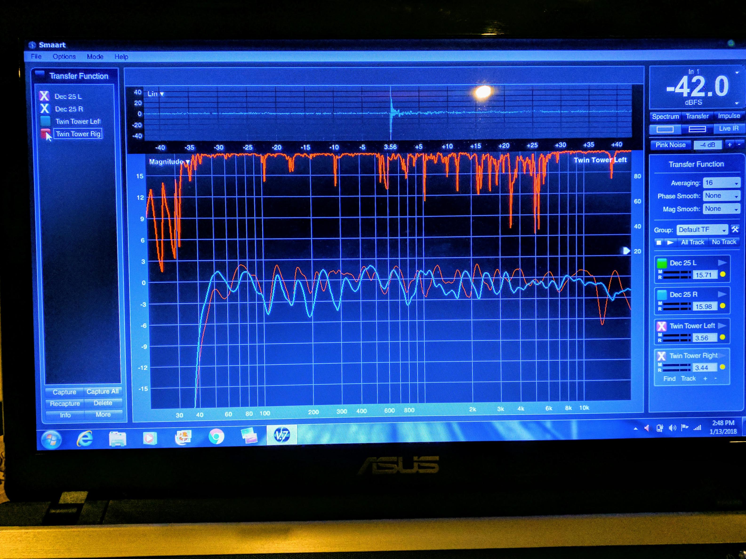

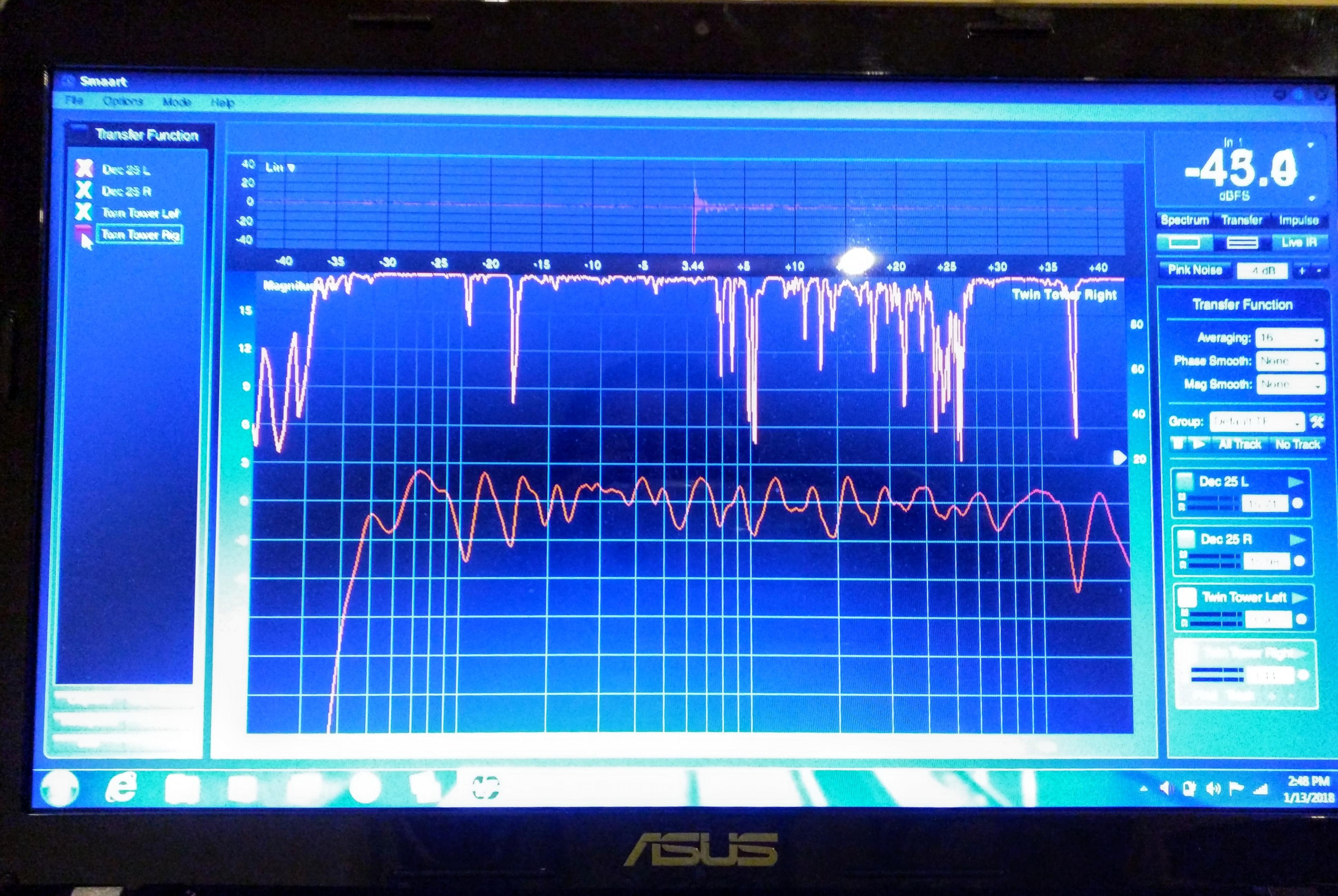

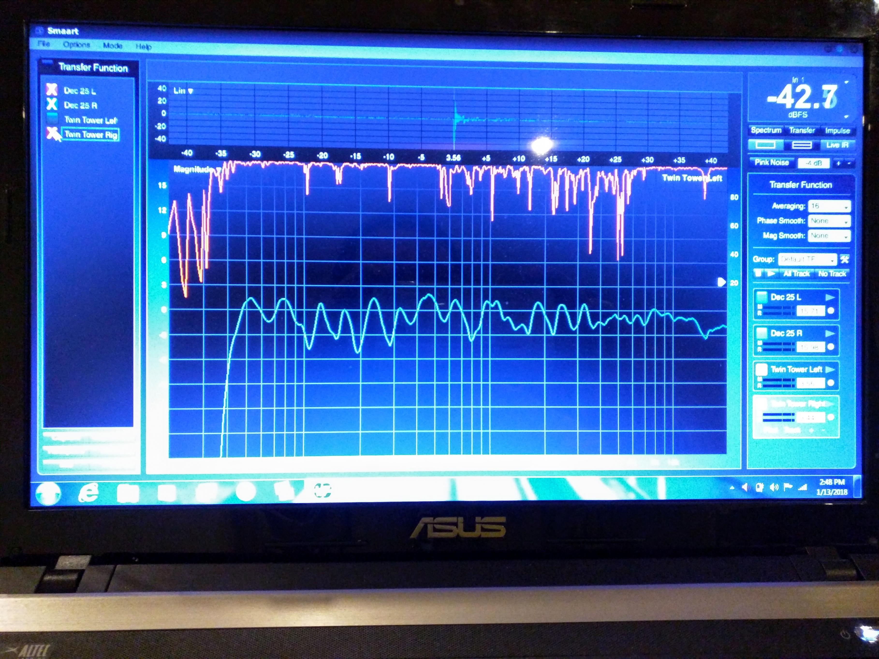

Dayton RS100-8 + TC9
See picture for my new experiment with the TC9 on top. Guess what? It turns out pretty nice and I'm happily listening at the moment.
Measurements will be followed.

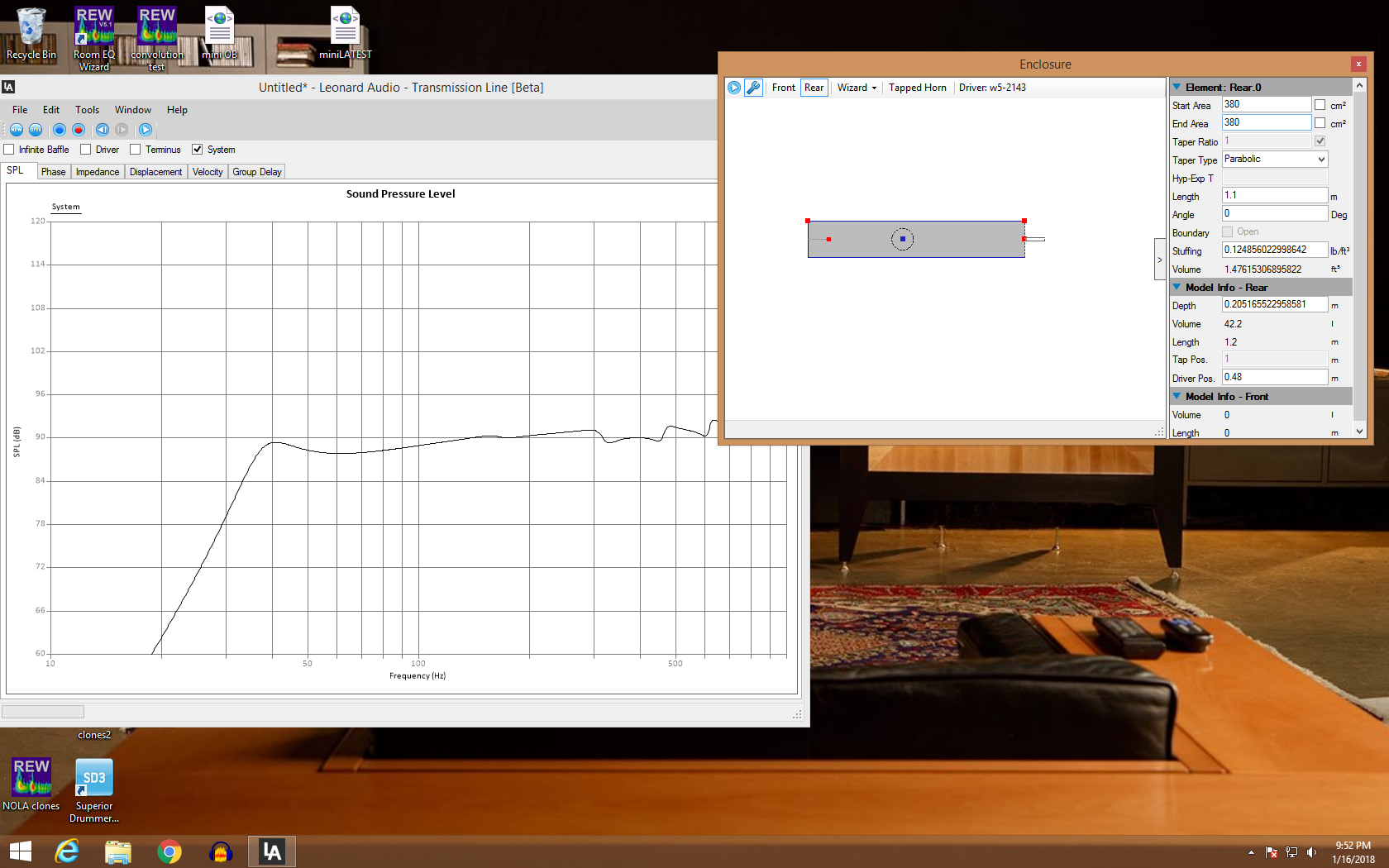

Bjørn, if you are listening...
I know we kinda dismissed the W5-2143 earlier, with its low Qts.
Actually it's not that simple, because I know of two different measurements and they are not identical to the published specs:
Qts=0.45 - by user XRK871 - Decware DNA Horn
Qts=0.65 - TB SPEAKERS W5-2143 (Full-range 5", 8 Ohm, 60 Wmax) (image located in the lower part)
After playing around with the different data sets I realized it will be a 30-40 liter enclosure tuned in the 46-55 hz interval... maybe a little higher if that Fs is really above 80hz. The reviews report a disappointing bas performance with bas reflex enclosures but no bad word from TL designs, in fact I believe I found a japanese source that reported excessive bas from a TL (note:google translate is not perfect).
I believe tuning higher is the right strategy for this driver, in the sense not to push it as low as possible, the rest is TL magic as you go lower plus the Sd is much larger than a 3 incher or a 4 incher (Sd=92cm2 - measured by me with 1/2 surround minus phaseplug).
Hmm... now, that's some disparity between measurements.
My TB 4" were not that far off... but the Visaton B80 were.
I guess we could take a chance and pick the middle ground which would be X's measurements... until I get myself a pair, if I ever decide on a 5" driver.
