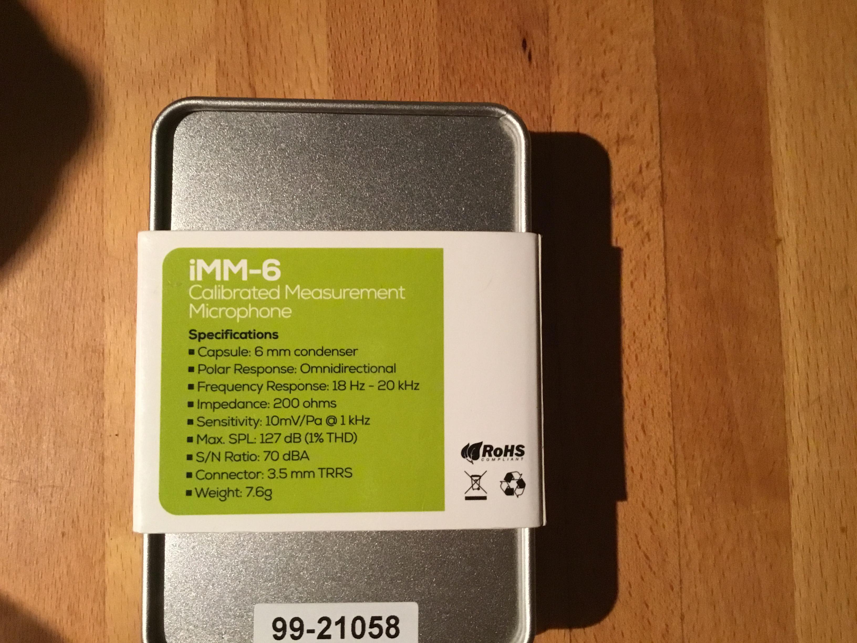

If you continue indulging yourself in the DIYAudio world, I suggest you invest in a measurement mic. It is a very valuable tool, and it tells you exactly what a speaker is doing, within your own room.
Trying to design and place speakers without one is just shots in the dark.
Umik and others like it are good enough for the amateur hobbyist, and really, a must, should you decide to build more speakers.
I have one measurement mic (photo) not sure if it’s sufficient or not. I’ve used both with my android and iPad using the appropriate apps. But I haven’t used it a lot, need to to understand how to use it best way possible. I will look into the mic you suggest also. I intend to make many speakers, which scares my wife. But she likes the finished products. So much to learn. Thanks for your help and skills, opinions. It helps a lot.
