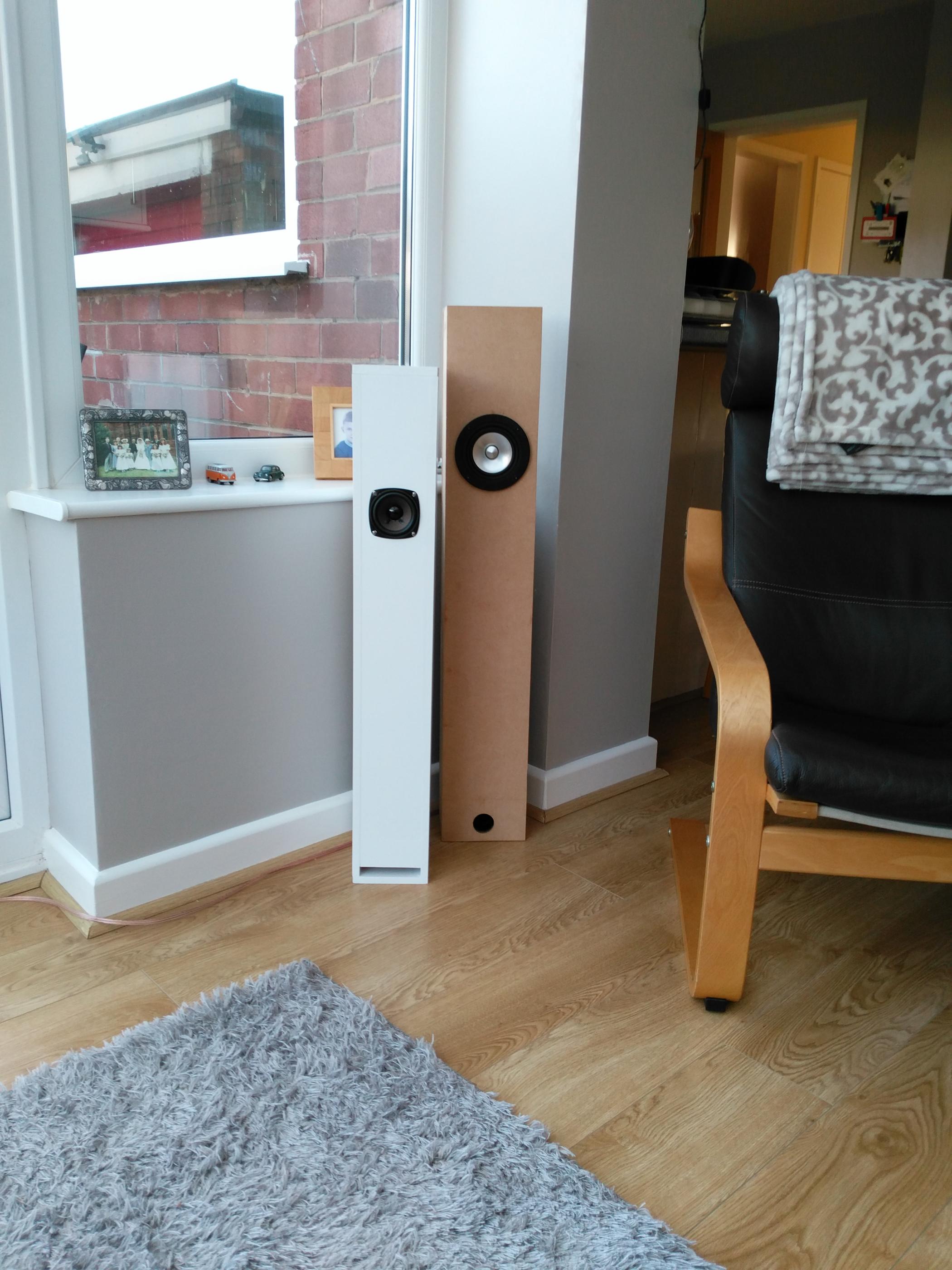

Hi all,
Happy new year!
I just thought I'd show my Tabaq's with revised port for Mark Audio CHR70 gen 3 drivers.
I'm currently breaking them in gently as per the manufacturers recommendations.
Not sure how I'll finish them and a base will be added, but the initial sound is very promising!
My original design Tabaq is shown to give an idea of scale.
As ever, thanks to Bjørn for the sim on this driver.
Regards
Chris
Happy new year!
Regards
Chris

That's quite like the Tabaq prototype.
Hi Jerms,

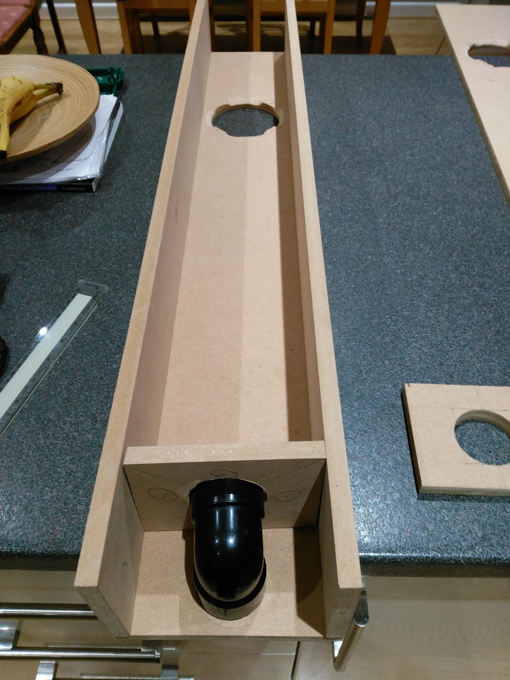

It was Bjørn's prototype with the pipe insulatoin that gave me the inspiration!
As mentioned in my previous posts, I was going to mount the port on the side of the enclosure (which has also been done before), but it got too fiddly for my poor woodworking skills!

Bjørn gave dimensions of 10.6 sq cm for the port opening with a 12.7 cm ength for this driver.
I have used tube with an area of 11.3 sq cm and 12.5 cm length, so not exact but from what I have read on this thread and others, slight variations don't make too much difference. (I could be wrong being a complete novice!)
Chris
Chris
Hi Chris
This small deviation will work fine. It will just raise the tuning a few Hz. Nothing to worry about.
Regards
Bjørn
Chris
Ummm, you sure on that 10.6cm^2? Original Tabaq had 16cm^2 (10x1.6). With a 4" driver, if anything I might expect the port xs to grow rather than shrink. The original was about 50% of the driver SD. With the CHR70 and 11cm^2 you're more around the 20-25% mark.
Although, you'd probably have to play it very loud and bass heavy to get any port noise.
Also; port length. if you need it longer (lower tuning), it can poke up through the floor into the cabinet a tad.

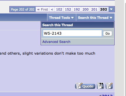

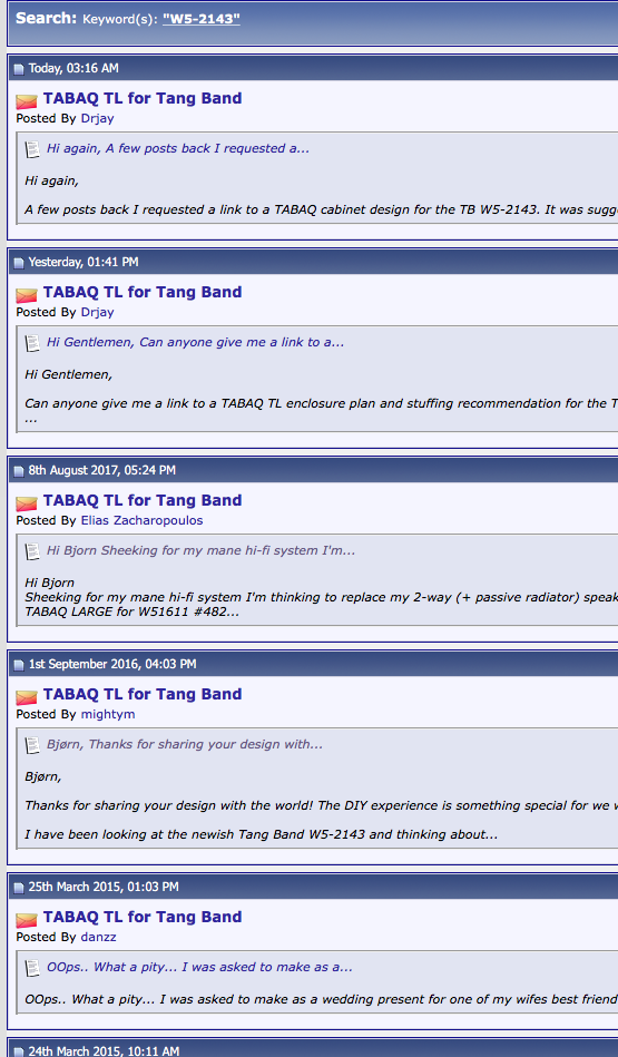

Hi again,
A few posts back I requested a link to a TABAQ cabinet design for the TB W5-2143. It was suggested that I "try searching". Well, before posting the request, I had tried searching using google since I am not familiar with the DIY audio search tool. I have since tried using it by entering the driver designation and have not come up with anything.
Because I have a pair of TB W3 2141 on hand and remember that there was a discussion of a slightly modified cabinet for that driver, I also tried searching using that driver designation and got nothing related to the cabinet design discussion I remember.
I obviously don't know how to properly use the DIY audio search function. Could someone give me some coaching, please.
Jay
Jay
Top of the page, you have to click on the "Search this thread".
Enter the driver's name.
Click Go.
A window will open saying it is searching for you.
Then, it will open a page with many posts including the mention of your search term(s).
To see a particular post, click on the blue link to the right of the little post image logo, not the title of the thread.
Hope that clears things out.
J.
DOH!
Maybe I should put my brain into gear before posting!
16 cm Sq not 10.6!
I'll let the drivers break in before deciding on any changes to the port.
Thanks Jerms and thanks Bjørn
