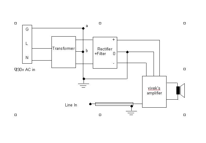

Navin,
I intend to try using a different amp and try it but I did not try my setup with a different receiver. But back home, I removed the earth wire on the amplifier mains plug and it became very silent. I will have to research further.
Hey...!
Do u mean there's a direct connection from the Ground/Earth on the mains plug to the ground on ur amp ...?? 😱
I mean starting from the Reciever output, Does the sheild(ground) of the Line out have a direct path to Mains Earth.?
The mains ground, the centre tap of the transformer and the junction of the positive and negative of the power supply filter caps are all connected. All this is in the amp I made. But the receiver has no connection directly to the mains ground/ earth.
Is the attatched figure correct..?
And is it true that removing a-b solves the problem.
If yes, that shpuld be the way it is.
It is NOT advised to connect a-b directly...If at all required it has to be through a high value resistance bypassed by a capacitor. But it is not recomended.
