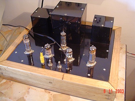

Hi Ashok,
Don't apologise. The amp looks very nice. Except for a few people it is hard to get something done looking nice on a one off basis.
This one really looks nice. Trust it sounds as good.
How do you like the sound of the EL84 SE ?
What kind of bandwidth does it have? Delta audio transformers ?
Can you compare it against any other amp?

Tarun: your brahminical analysis makes eminent sense 🙂. I'm Brahmin and DIY’er. Unfortunately, I ain’t good in either !
In a word MAGICAL. I listen to it around round the clock. Can’t detect even a bit of hum or noise even if I stick my ears into the speakers. Stargrounding and short leads all around. No fancy caps. Generic MKP's and Carbon resistors. Wirewound Pots. BEL EL84+ECC82 and Mullard EZ81.
I don’t have the equipment to measure bandwidth. But I think its limited only by the speakers that I have. Very open and relaxed sound. You can clearly make out each instrument and their placement. Dynamics are captured fully at least for the kind of music that I listen to.
A few weeks ago I had almost 30 people over for a bash. This amp played thro the evening aided only by a flimsy Polk Audio sub flinched from my wife's HT setup. It was never short on power delivery.
Output transformers are nos Phillips. I fabricated aluminium enclosures and potted them with industrial grade resin. Earlier I had used Hammond 1628SE. A few months ago, I started on a 6V6 project and the Hammond is now powering the one channel proto. But I find the EL84 slightly better sounding. Delta is a good, but they only have PP. I have used Delta in the past and quite happy with them.
Thanks for the complement !

Do you listen to hard rock or any other type of music which has hard drumming with sharp attack? Does this amp handle that kind of music accurately? I've once heard BAT monoblocks through Dunlavy speakers, but I didn't think it would compare with good solid state on this front. Same reaction to Cadence valve amps played through Cadence ESL-hybrid speakers. Maybe I was wrong...
And I love that wood finish. I think you valve guys have cottoned on to this idea of wood for cabinets much earlier than we solid state types. 🙂

Is this point-to-point wired, or did you use a PCB? Never having done this point-to-point thing, I find the idea scary. Is it very difficult for a beginner?corbato said:Stargrounding and short leads all around. No fancy caps. Generic MKP's and Carbon resistors. Wirewound Pots. BEL EL84+ECC82 and Mullard EZ81.

This is what I made for myself a few months ago. Cost me very little. I know I know..the wood work is horrible![]()
Ashok,
The amp really looks good. Do you still get the high wattage carbon resistors. In the early 70s I used to purchase the components from a shop in Sakchi, can't remember the name, fat guy with specs. Which shop do you buy your valves from.

..Is this point-to-point wired..
Yes p2p. Much easier then PCB. Gurus at the tube forum swear that it sounds better that way.
...hard rock...
This amp does'nt handle that stuff well. Jazz and classical sounds just great.
...wood for cabinets...
I'm collecting parts for a JLH Class A. I want to give the same wood treatment. Something like this.

Except the power supply where I used high wattage wire-wounds, resistors elsewhere are max 1 watts. Yes I buy them from the same shop in sakchi (pandey). Tubes I buy from other shops.
