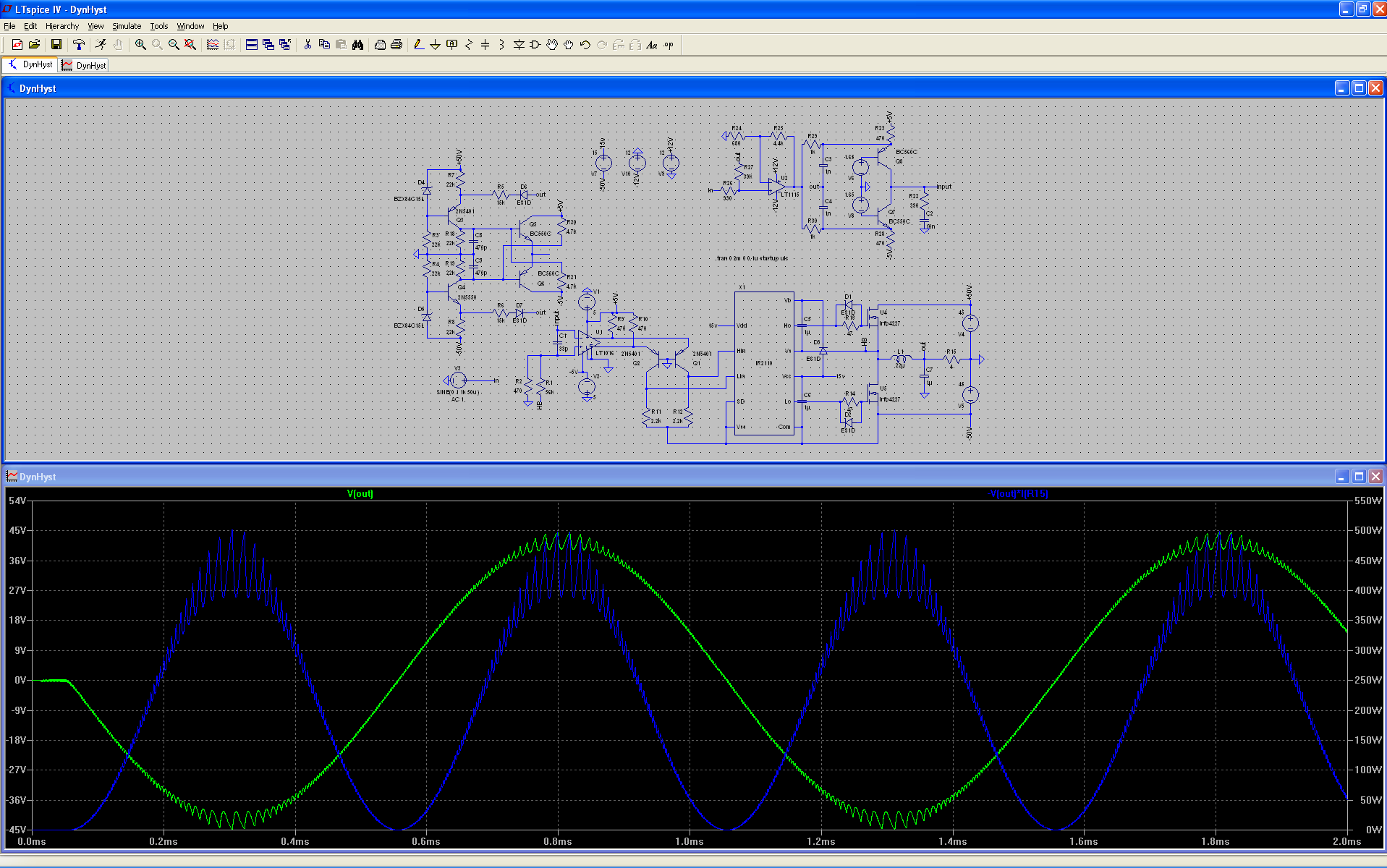

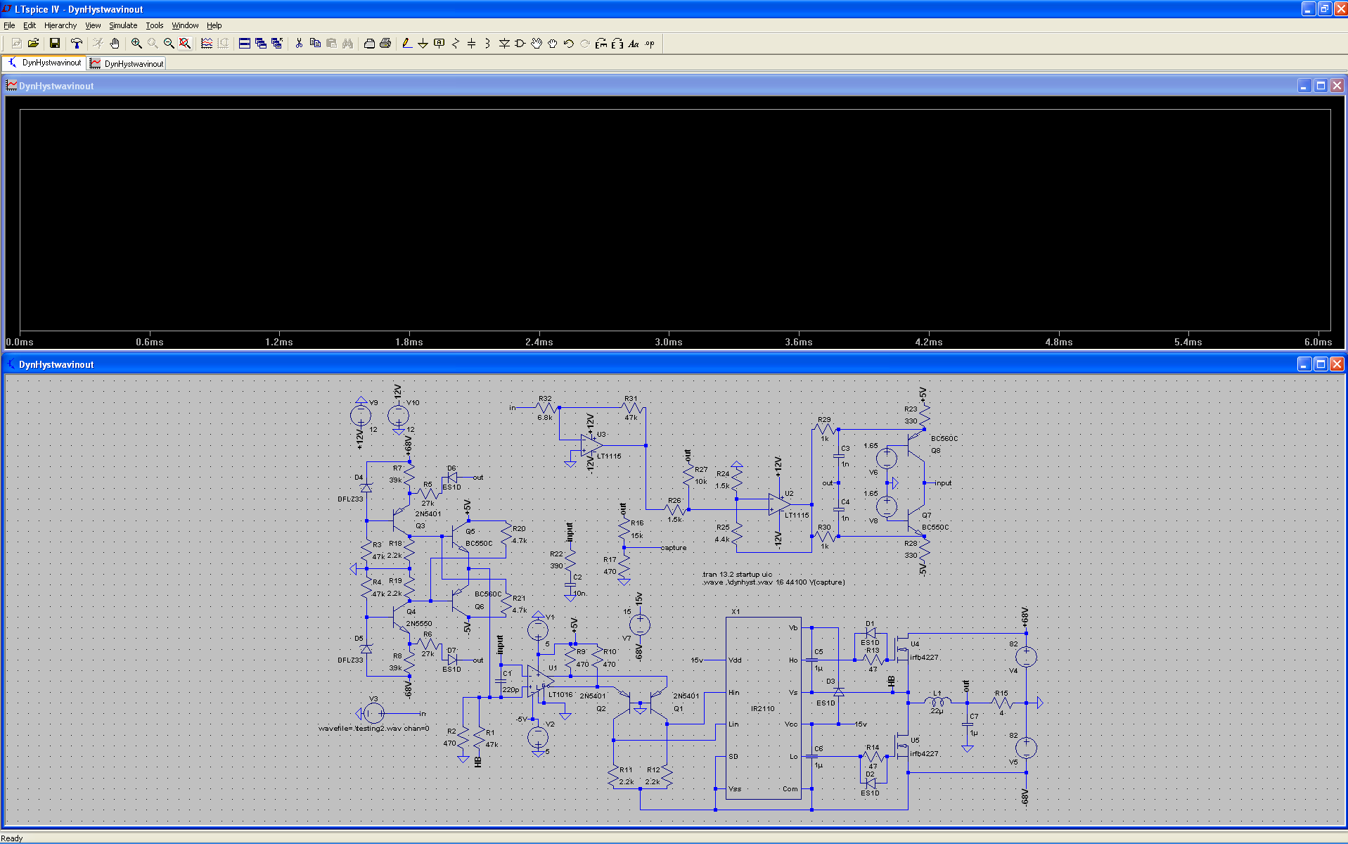

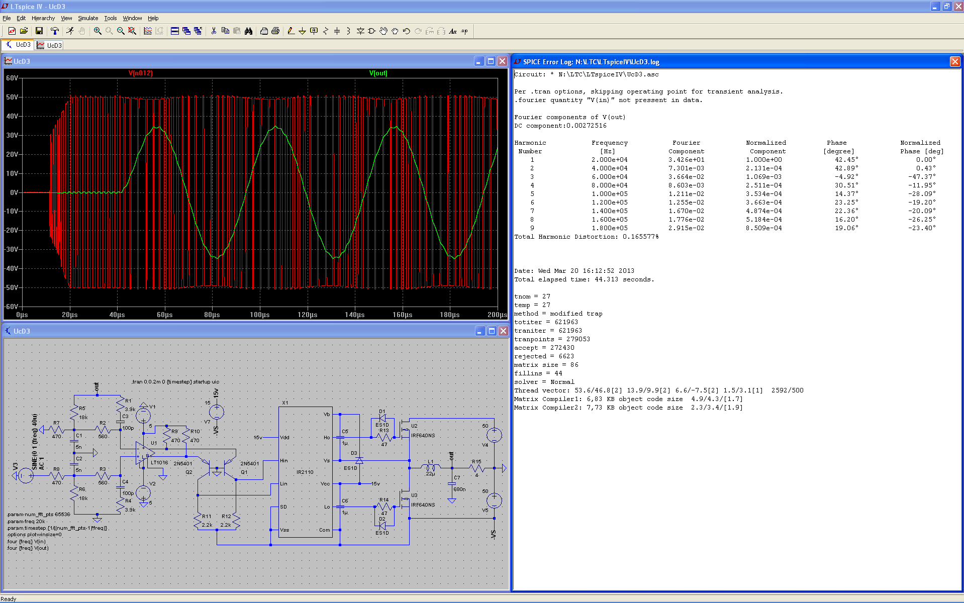

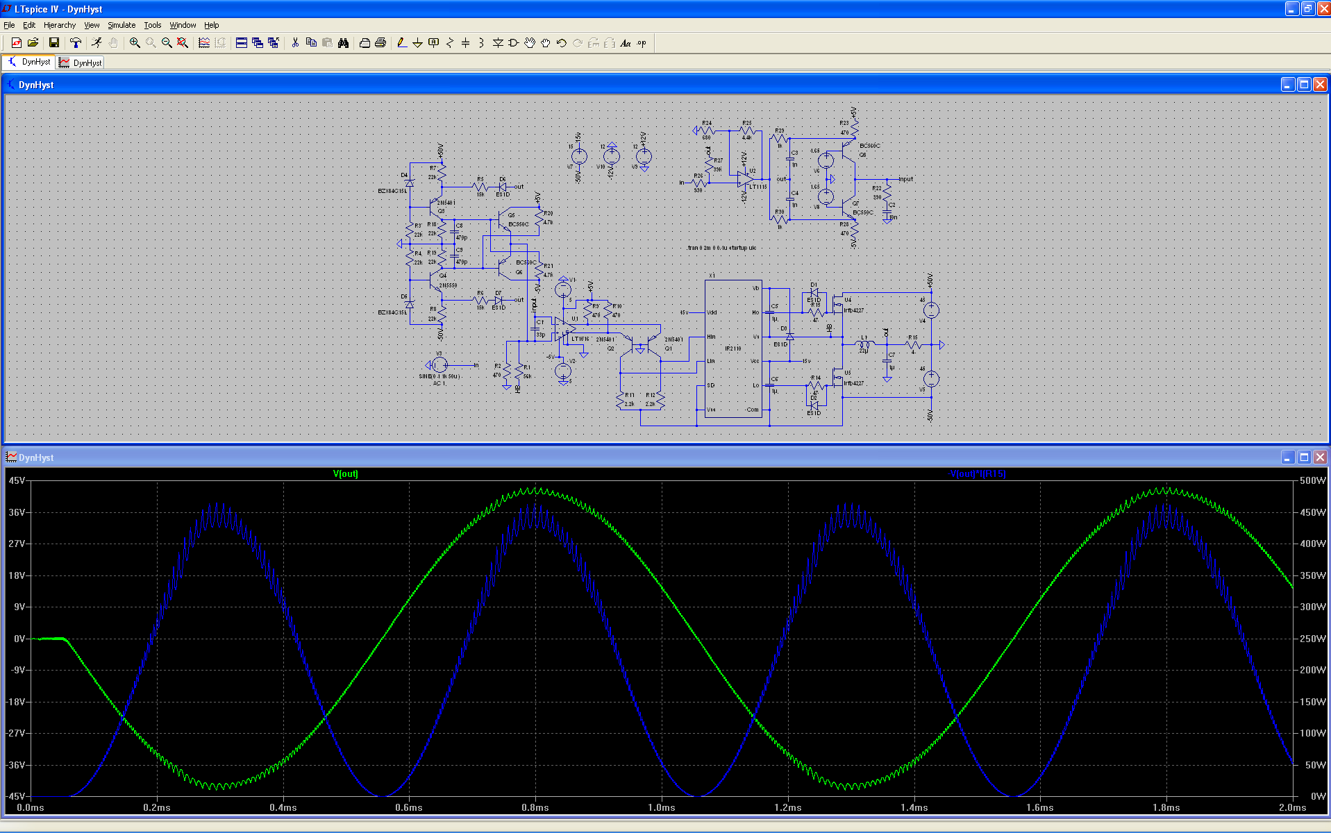

Yes, but as Choco is probably fed up of saying, is that with a hysterectic self-oscillating amp, if you decrease the hysteresis band in a controlled manner as the output gets closer to the rails, the drop in switching frequency can be made very much smaller.
Thanks Ouro...
Tekko,
you should really read the early pages with the discussion about multiple implementations of a dynamic hysteresis.
In any case... Correct - the effect of dropping frequency is not avoided, but reduced to a more comfortable level.
So far I have no evidence if the frequency drop and increasing ripple of self oscillating amps is audible or not as long as Fs remains far above the audible frequencies.
-From cosmetic point of view it is ugly.
-With respect to switching losses and semiconductor stress the fdrop is highly appreciated.

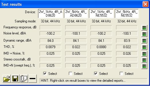

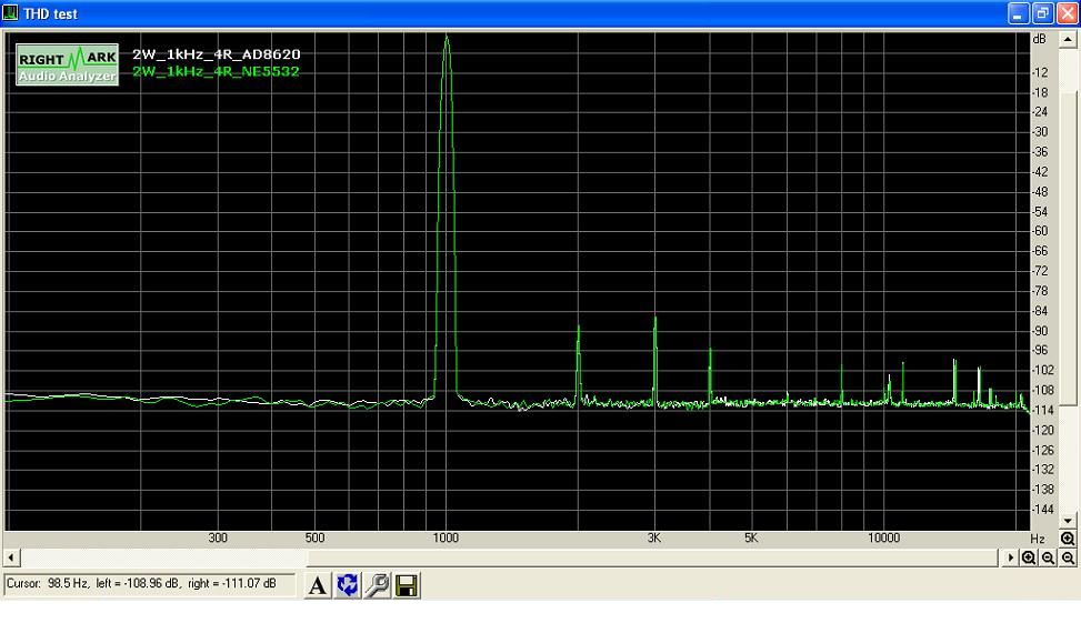

Measuring an amp is just half of the game. Listening to it is of same importance (or even more?). This design allows tons of variations of OP amps and comparators.
I would have expected that the comparators would play a dominant role for the sound, but to my ears the differences were just very marginal and sort of diffuse – still giving a personal preference on the MAX913.
The OP amps showed a stronger impact and they are changing the sonic character to the amp.
Here my ranking:
1. AD8620:
Very vital and voluminous. Impressive soundstage (despite being mono!) and surprising air. Details unlimited.
2. OPA 1612:
Also vital, but less voluminous. Less soundstage and gradually less air.
3. LT1364:
Vital, but shows no mercy with the shortcomings/harshness of internet radio and some poor MP3.
Pretty OK, when listening to a higher quality source like 192kHz flac.
4. OPA2134:
Very decent. Very comfortable. Not annoying at all. But for my taste sometimes slightly to thin.
5. LM4562:
Slightly pressed. Reducing the ease of music, giving it more a character of hard work.
6. NE5532:
Has similarities to LM4562 ( sorry TI/National guys, please don't shoot me..), but less contours.
In 1980 NE5532 must have been an amazing OP amp.
7. TL072:
Despite the fact that the amp is still working trouble free - the TL072 is the right choice to avoid audiophile satisfaction after spending a lot of efforts and money.
To me it was very surprising to find the character strongly influenced by the OP amps and less by the comparators. Also I would have expected the LM4562 somewhere in the Top3.

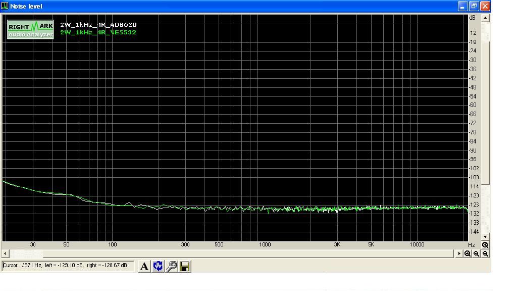

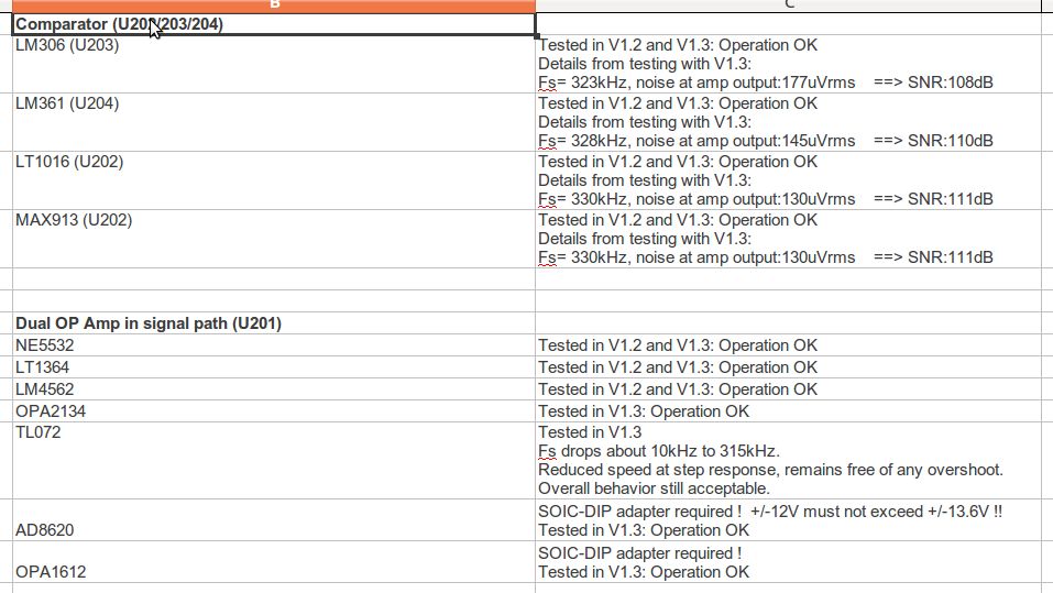

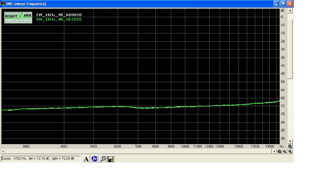

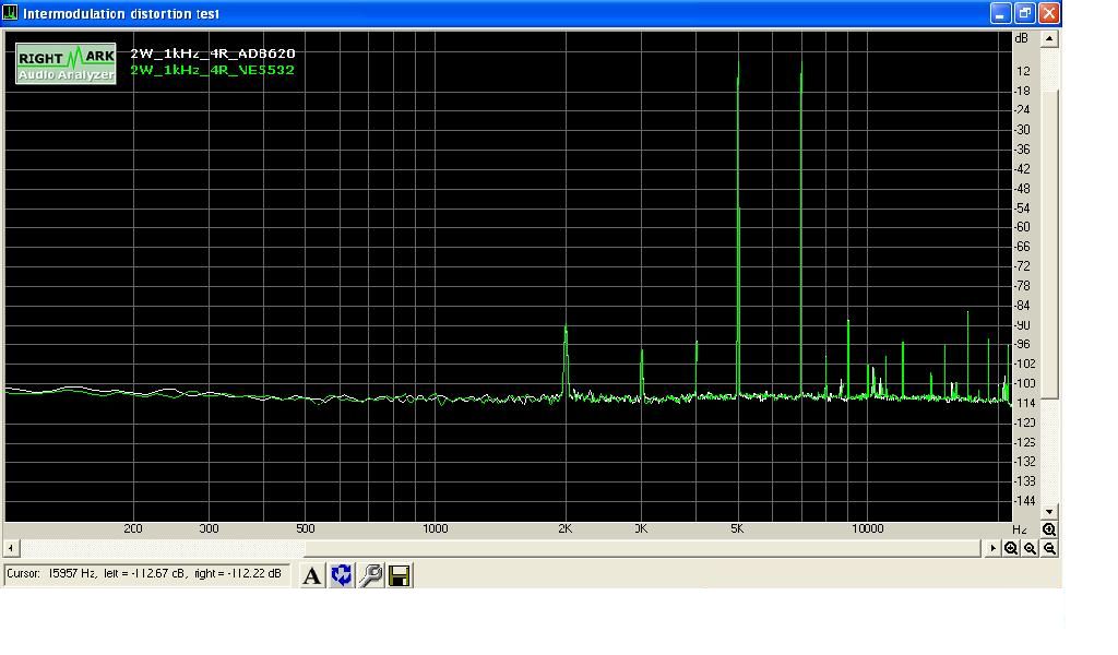

Chasing for a correlation between measurements and listening perception, I went for multiple comparative measurements of NE5532 vs AD8620, comparator was always MAX913.
To ensure that my measurements reflect a similar situation like my listening tests, I used the real speakers as load and performed the measurements at a similar level like listening ==> 4Vp.
First picture:
Again the list of alternative components
Second picture:
Spectral noise density
Third picture:
THD at 1kHz and 5kHz
Fourth picture:
Spectrum of 1kHz THD
Fifth picture:
IMD
Sixth picture:
IMD over frequency

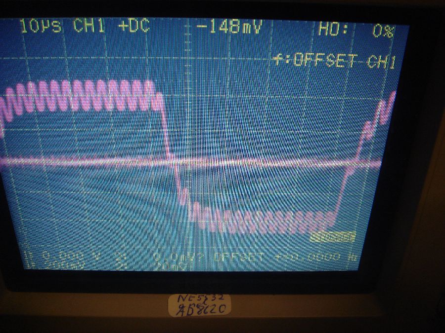

Seventh picture:
Step response.
Both measurements in one picture by using the fluorescent storage of the scope. Amazing they equal even in each HF cycle!
By the end of the day I must admit:
Either I am a believer, or my measurements are not covering all relevant properties.

Yup, I think you took it right.This is my interpretation of your Dynamic Hysteresis D-amp circuit.
Your power stage is different, so also your propagation delay (==> fs) and distortion figures may differ from my power stage. But basically it should fit.
WAV files?
You mean you are chasing music through your sim in order to listen to your sim? Playing the output WAV with your normal stereo?
That's a cool idea!!
Well yeah but its a slow process, about 100mS worth of audio takes about 10 hours.
My power stage is a little different as i only have spice models for the IR2110 and the others available at this site: ftp://kavcrl.dyndns.org/+MEDIA/experiments/ExperimentsSoft/LTC/LTspiceIV/lib/sym/yahoogroup/
I might try this out together with the UcD in my other post above and see if i can tell them apart from each other.
Hi Tekko,
yes that's the way how it should act.
Nice to see that you use the idea to experiment with your own adjustments to fit voltages, components and personal taste.
I have to admit, I did not investigate in detail which adjustment I really prefer, but just stayed with one reasonable setting so far.

I really like the idea to listen to a sim 😎

Which switching frequency do you get with your output stage?
P.S.
Edit:
