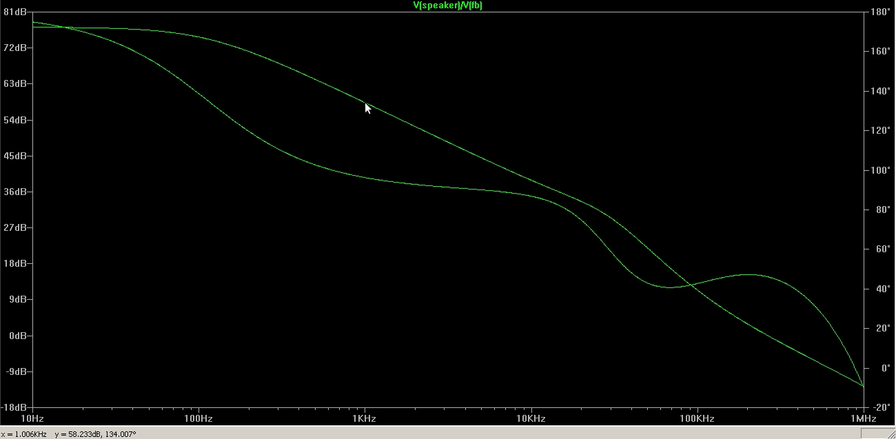

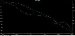

Attached the theoretic loop gain with 2R load.
The low inductive resistor during my measurements of the output impedance was 2R.

@Troels
Simply break the loop at the output, where all the feedback paths start.
Insert a voltage source for signal injection.
Analyse the ratio of voltages at both ends of the injection voltage source.
http://www.google.de/url?sa=t&rct=j...4G7It65uaFE82kgk_IwBzcw&bvm=bv.42965579,d.bGE
www.ti.com/lit/an/snva364/snva364.pdf
Ridley Engineering | - AP300 Measurement Techniques
You will find much more literature by searching for: 'loop gain measurement'

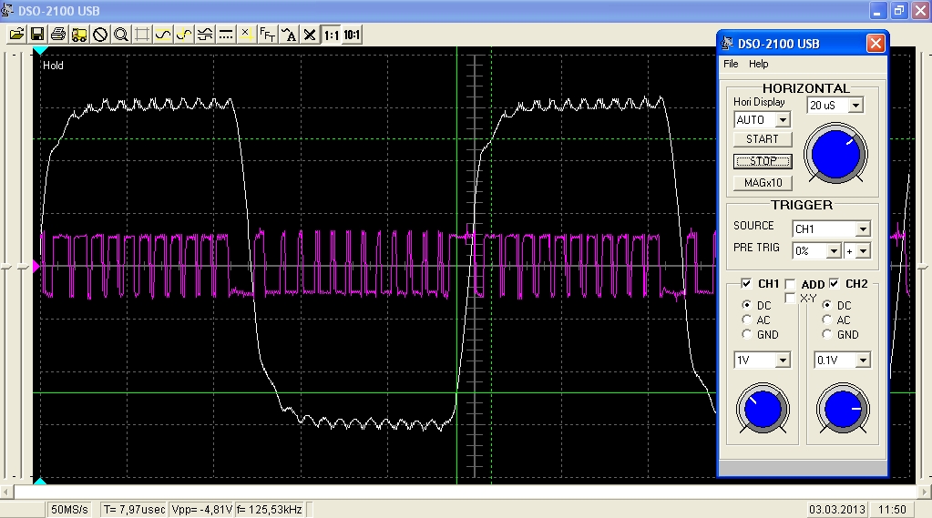

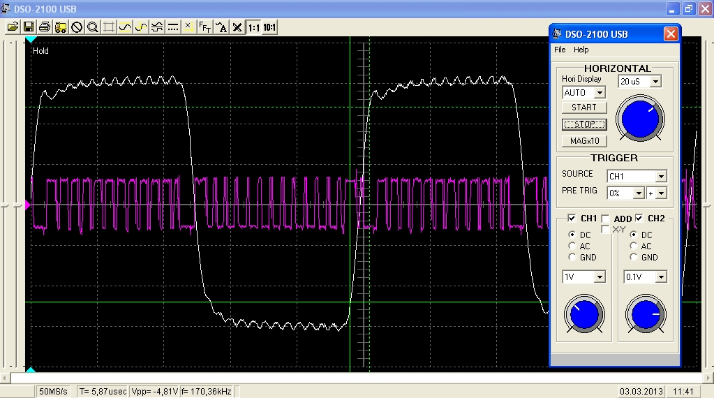

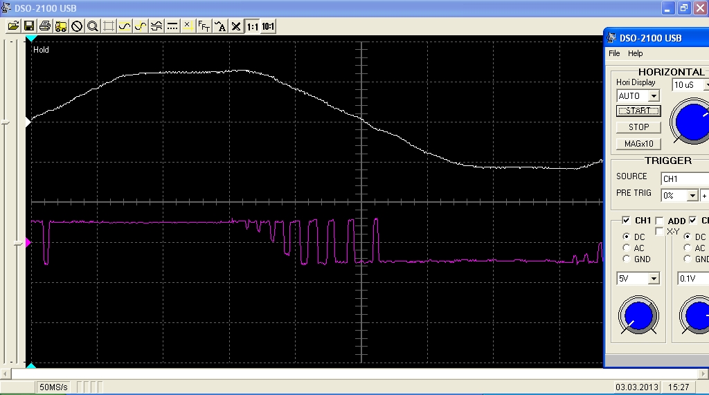

@ ChocoHolic
Then I think that you get around 620W @ 8R Load?
if I understand you properly, its much harder to make a stable D amplifier @ 8R load?
@ ChocoHolic
Eva said:Here are some hints left in 2010 by eva regarding self oscillating amplifiers
Self oscillating loops have several interesting properties. For example, open loop gain is automatically compensated against changes in supply voltage, while in clocked modulators it's a direct function of supply voltage. This makes self-oscillating amplifier performance quite independent of supply rail voltage and sagging and improves PSRR dramatically.
Another advantage of self oscillating loops is that switching frequency is automatically reduced as the output approaches the rails, while keeping constant carrier residual amplitude at the output. This results in the minimum amount of switching events for a given carrier residual amplitude. In other words, switching losses are always as low as possible in self oscillating amplifiers. Switching frequency usually drops 2:1 or more before clipping.
Clocked modulators force the output stage to switch always at the same frequency, resulting in many switching events that are not really required, as the output gets closer to the rails and carrier residual amplitude becomes smaller and smaller.
Additionally, post-filter self-oscillating recycles the extra gain due to filter resonance as open loop gain, thus reducing output impedance (and THD too). In other words, the filter can resonate close to 20khz or even at a lower frequency without compromising frequency response.
Once you have put together a prototype which takes advantage of all this (and more), you don't feel like going back to clocked modulators.
Eva said:Your main misconception about PWM amplification is assuming that a non-constant switching frequency results in non linearity.
The absolute minimum switching frequency is 2 times the maximum frequency you want to amplify, 44Khz for 22Khz audio.
The main reason for using 10 times higher frequencies (400Khz) is being able to deal with carrier residual with a 12db/oct output filter.
In clocked modulators carrier residual amplitude is maximum near 0V output and drops to 0 when the output approaches the rails (ugly looking waveform btw). Carrier residual amplitude is modulated by audio signal.
In self-oscillating modulators carrier residual amplitude is almost constant and frequency is smoothly reduced to keep it constant. There is no penalty, it just takes advantage of a "feature" of the output filter that you can't use with a fixed clock.
This reduction in switching frequency does not involve any reduction in the amount of negative feedback, so linearity is unchanged.
Another advantage of variable switching frequency is spread spectrum EMI. Variable switching frequency is now being used in many SMPS control ICs. I nearly always use it in clocked modulators too, for example in PFC.
...you have to parallel them almost 30X in order to ensure trouble free operation when pumping multikilowatt into 2 ohms load.You haven't seen them blasting and evaporating in the air. 😀
Kanwar
Hm, this is sounding like a serious comment.
2x5parallel is for 1.2kW into 2R.
For multiple kW it would be two half bridges with 2.4kW into 4R and summing up the caps to a 10x parallel structure.
The true current load is depending on the layout and the equivalent circuits for the small caps and e-caps. My detailed simulation of the switching stage is delivering a current load of 0.59Arms per SMD cap when powering 35Ap sines (2.4kW into 4R) with a 1/8 duty cycle.
Together with the 0R7 ESR this turns into losses of 244mW per cap. That's how I came to the conclusion that it is close to the limits, but not catastrophic. I fact my thermal measurements while hottrodding the amp shows no self heating of the caps, which indicates in reality less than the calculated losses.
Their temperature is following very close the surrounding temperatures of the MosFets and the heat sink above, 3-5 deg less than the close surroundings.
Despite seeing an acceptable situation from all that, it would be silly to ignore your input, especially as it sounds like you already have burned fingers.
The PCB easily allows to double stack (back pack) each cap.
This would sum up to 20x parallel for multiple kW, which is coming close to your advice.
So I will go on hottrodding the amp with just 5 parallel caps and change the BOM to double stacked for future builds.

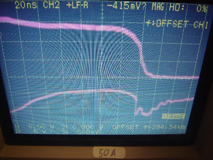

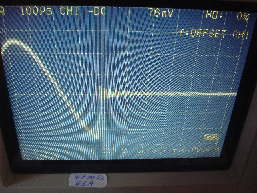

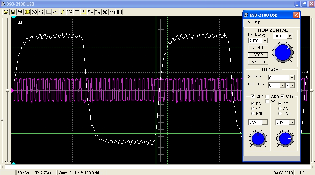

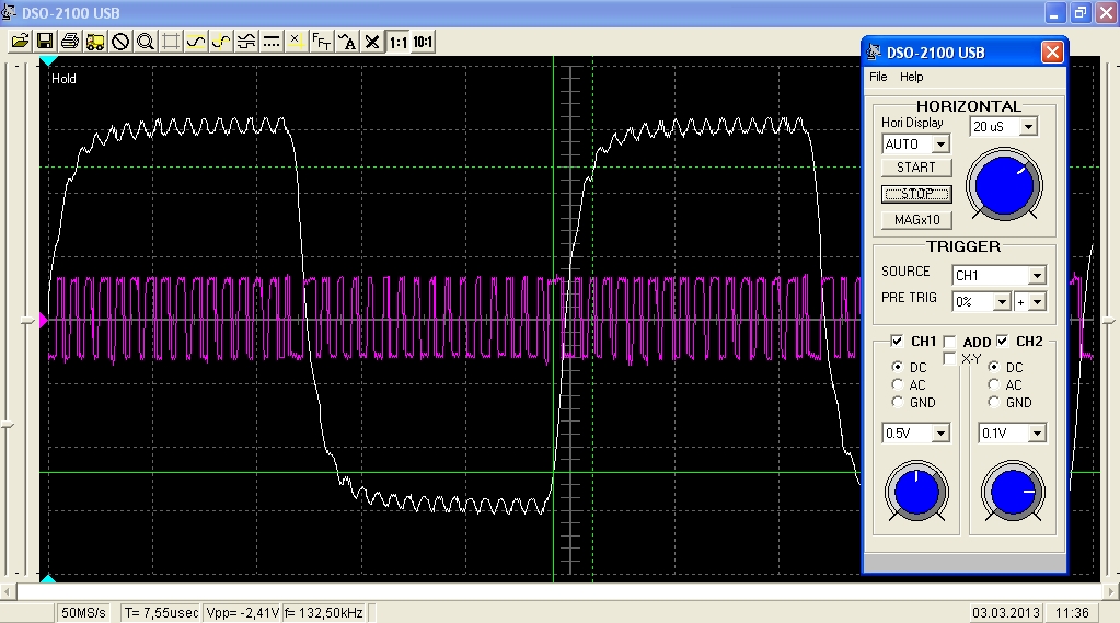

Settling and verifying the over current protection between 50A...60A gave me many more insights in this amp. In any case it was necessary to settle stronger snubbers for Drain-Source and Gate-Source in order to keep the disturbance level low even at such high currents. Also having the additional shottky inside the current detection path of the lower MosFet is not intended by the IR chip, but can be handled.
My test load was series connection of 1uH and 47mOhm.
The first screen shot sows the voltage across the 47 mOhm right in the moment when the over current protection is acting. It acts at 2.5V which translates to 53A.
How did I catch this moment? Simple. The protection has a auto reset function, so I simply let the load connected and the input signal large enough to trigger the shut down.
While the amp is continuously running into shut down again and again – you can get every shut down event with the singe shot function of the scope.
For the second and third screen shot I used the amp with DC coupled input and gave some DC input signal resulting in a DC output which give stable signals for the measurements.
The level was adjusted to 50A load current, close to shut down.

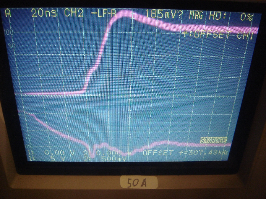

I did not chose a resonant snubber because the disturbances showed dual ringing modes at 35MHz and 125MHz. The screen shots show that these disturbances are now catched by the snubbers almost completely.
The second screen shot is showing the turn ON transition of the low side MosFet in very detail with a time scale of 20ns/grid.
Upper trace Uds: 50V/grid
Lower trace Ugs: 5V/grid
The third screen shot is showing the turn OFF transition of the low side MosFet in very detail with a time scale of 20ns/grid.
All measurements with 1:10 probes.

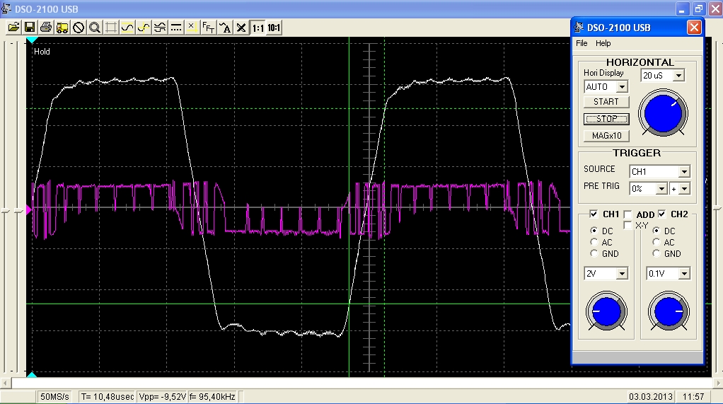

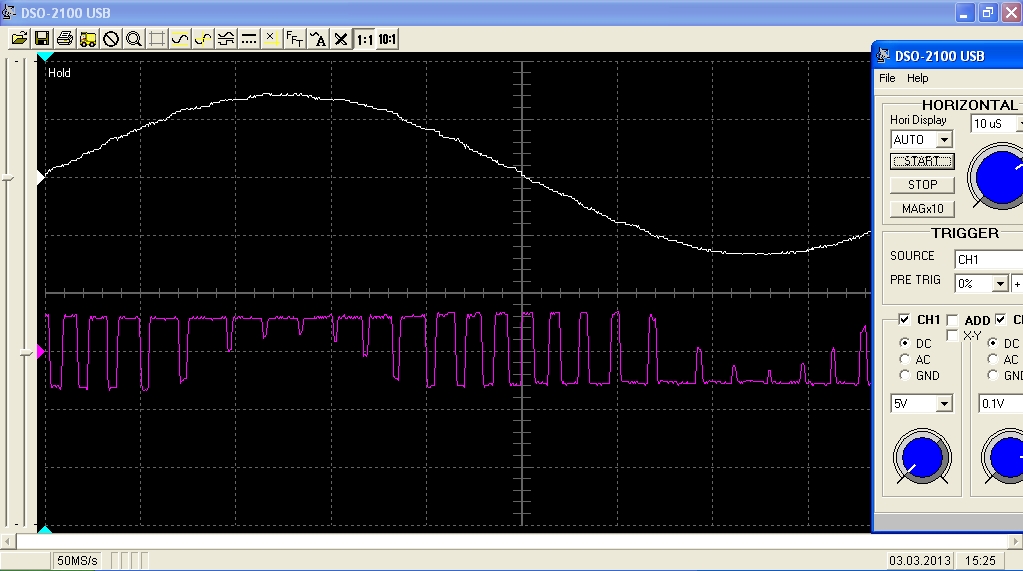

As a consequence of the adjustments for the over current protection and about reproduction of rectangles I went for new overall adjustment, whereof I will show updated measurements in the coming posts. V1.3 is born.
Let's start with the dynamic hysteresis.
Attached two screen shots, which show the output signal and the hysteresis signal.
Towards high output levels you can see the hysteresis being consequently reduced, which is keeping the output voltage ripple reasonably low.
First screen shot without load, second with 2R driven into clipping.
Upper trace: Output voltage, 50V/grid
Lower trace: Voltage a non inverting input of the comparator, 1V/grid

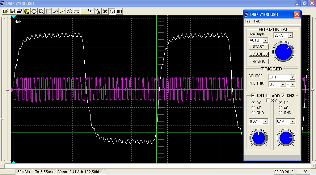

Rectangles:
The new adjustment also has a new frequency compensation.
It is the fastest adjustment, which ensures not overshoots at any load and signal level.
It is just 20% slower at lower and medium levels compared to V1.2, but I am using the clipping of the OP amp for artificially slowing down at very high levels.
Fast enough that I can accept it.
Attached 9 screen shots.
White trace: Output voltage
Red trace: Voltage at the non inverting input of the comparator, just to show again the action of the dynamic hysteresis at the 120V level.
30Vpp into 2R
30Vpp into 8R
30Vpp into no load
60Vpp into 2R
60Vpp into 8R
60Vpp into no load
120Vpp into 2R
120Vpp into 8R
120Vpp into no load
30Vpp into 2R
30Vpp into 8R
30Vpp into no load
60Vpp into 2R
60Vpp into 8R
60Vpp into no load
120Vpp into 2R
120Vpp into 8R
120Vpp into no load
