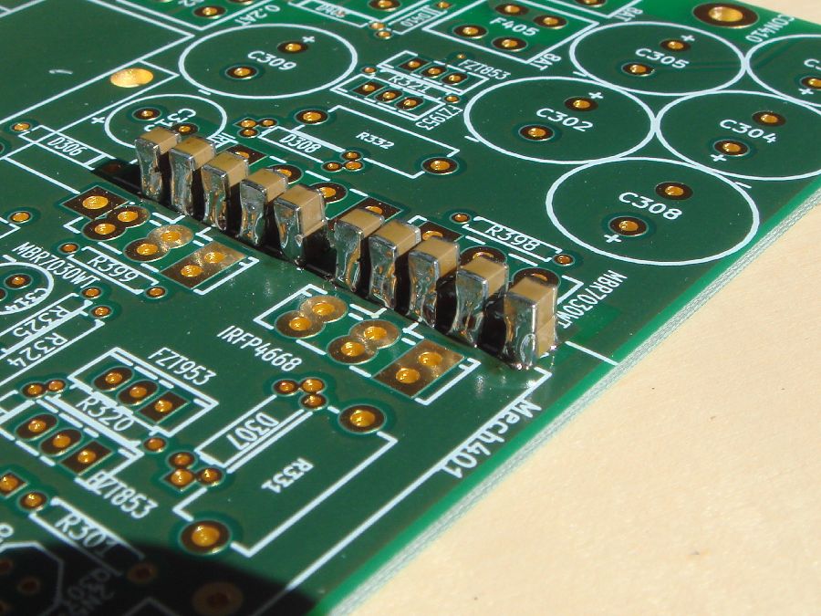

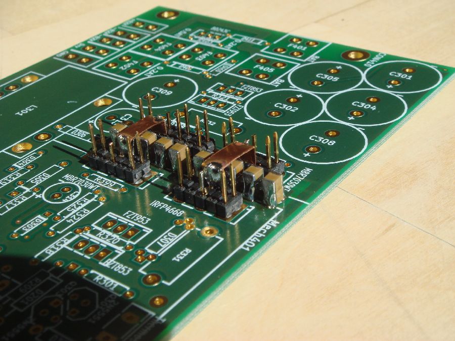

Towers of X7R
V1.3 already includes the double stacked rail caps right at the switching stage.
But I didn't have a proper picture in the Excel sheet, so I highlighted this in the BOM and the verbal description - but had to use the unstacked picture.
Now two pictures which show the double stacked caps.
Also the construction of the CuBars between MosFets and series diodes is shown. Ensure that the distance between the CuBars and any cap is at least 1mm.
Using the dual pin rows is making life easier during assembly and service.
If you use pin rows with a 2.54mm spacing make sure that you pull out the unused pins - not just lazzy cutting.
Needless metal parts in a high power switching stage are always a unnecessary risk.

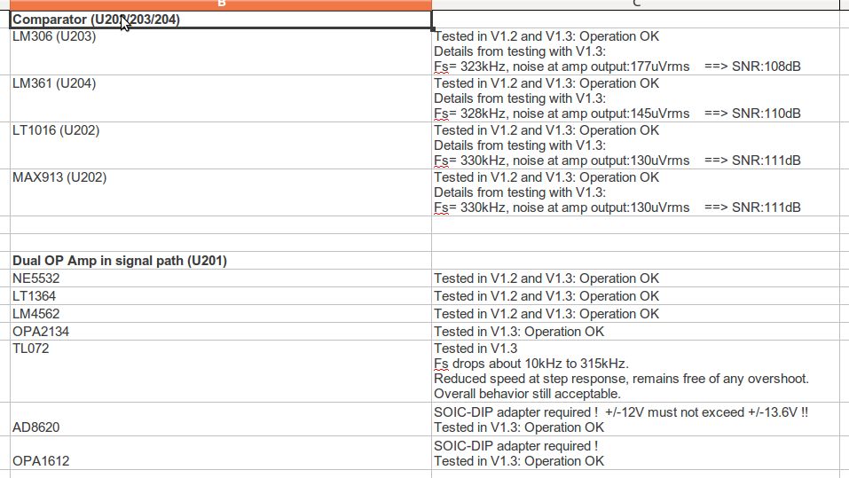

Alternative Components
The design without shaping network in the feedback of the OP amp is very forgiving regarding the OP amp requirements. Even slower types allow an acceptable operation of the amp.
Attached an overview of tested OP amps and comparators.
Since last week end I am listening to the variations - I will comment in a few days.
Also it turned out that my concerns regarding the very fast comparators were unnecessary - the disturbances on this layout and with the EMI shields are so low that even the 10ns types do not show any misbehavior.
Amazingly the SNR is even slightly better with them.
Regarding alternative parts for the power semiconductors I will go for a further build. Meanwhile the first proto is simply sounding to good - I just cannot go for mayor changes on that one anymore.
