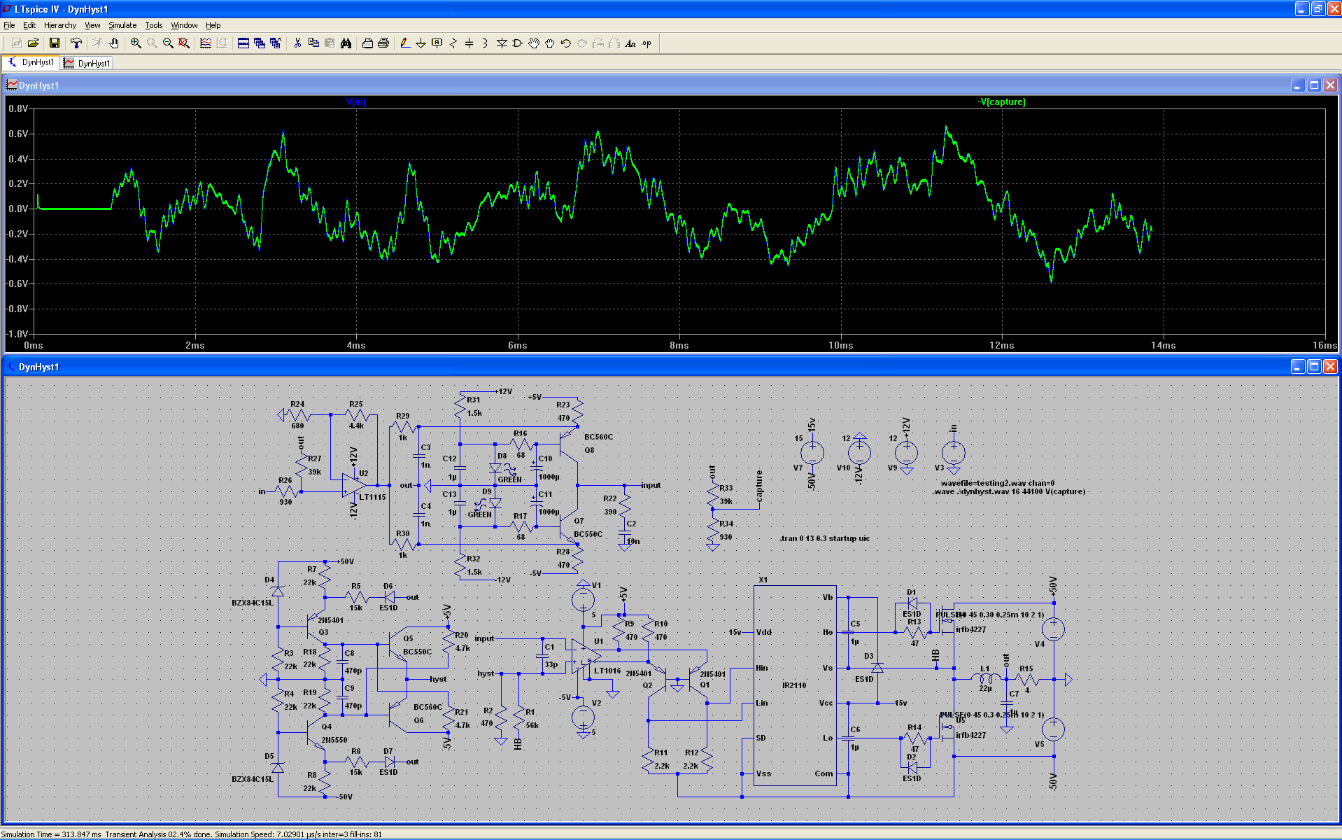

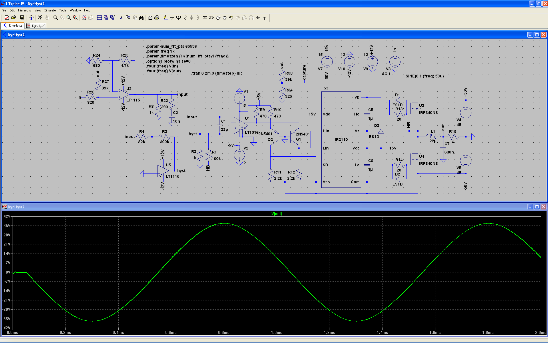

I was doodling around in LTspice to see if i could make it work without the voltage to current converter on the audio input and the quadruple transistor hysteresis window control circuit.
Now if it will work at all in real life i kinda doubt as im gonna assume choco already tried this prior to adding the transistor circuits, but its still interesting.
Why i did this is that while building the choco version, i found out im all out of some of the transistors and i still wanned something i could get together and play around with until i've ordered more transistors.
Disregard this!!! Turns out a a opamp was oscillating, making the circuit clocked rather than self osc.
The LT1115 audio opamp model seem a bit buggy.
For me its the opposite, my simulation likes to lock onto a 1.5MHz switching frequency where changing the cap on the comparator inputs does nothing until it get so large the sim slows down to a mere 100kHz.

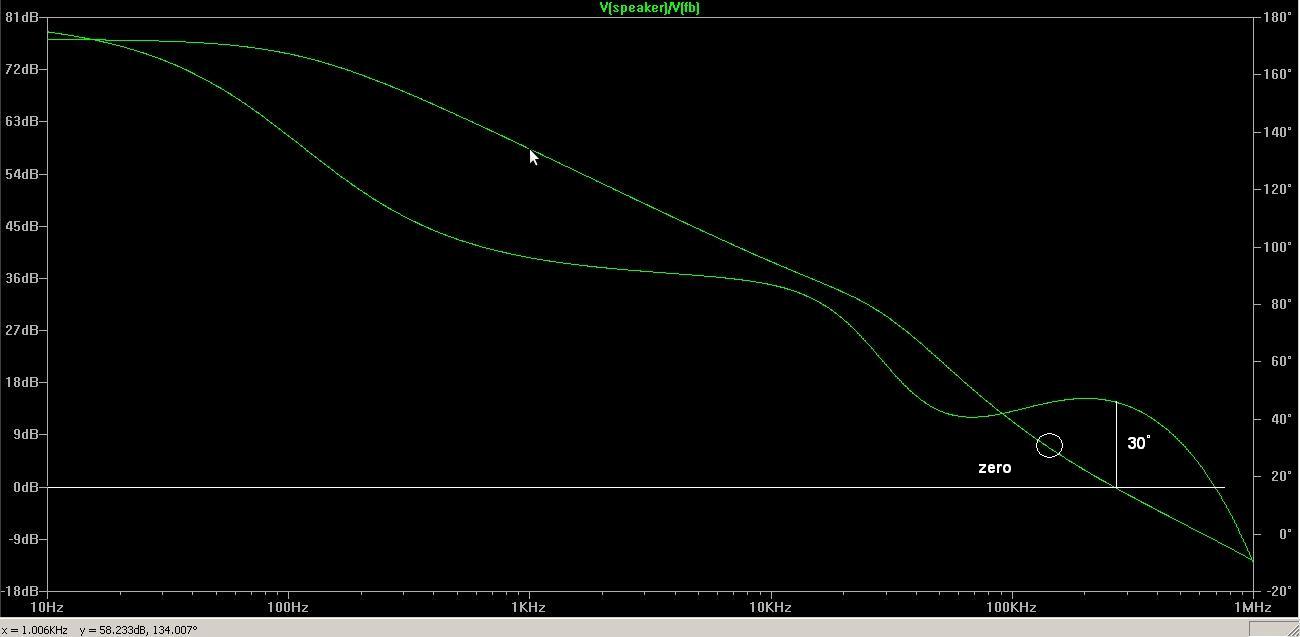

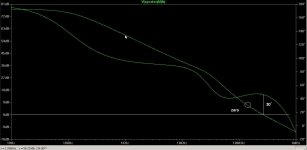

The zero is formed by the two D-portion caps in the feedback.
Means C3 and C4 in the attached sim (respectively C210 and 211 in the real schematic).
I am using the attached way of modelling.
The values are still from the earlier posted version and bode, but V1.3 will not differ fundamentally.
Take care. When simulating large integrating gains you really have to ensure a properly adjusted DC bias situation (already adjusted in the attached file).
Otherwise the sim will just show nonsense of saturated gain stages.
In V1.3 multiple values have changed, also the triangle magnitude is slightly larger. Means the gain of E1 would need to be adjusted slightly.
U1 is not inverting, Q2(Q4), E1, E2 are not inverting as well, so the forward path is not inverting? 😕
E1 is used inverting. The table numbers are non inverting, and I am feeding the signal into the neg input pin and take the output from the pos output pin.
