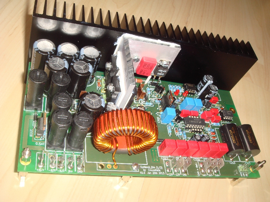

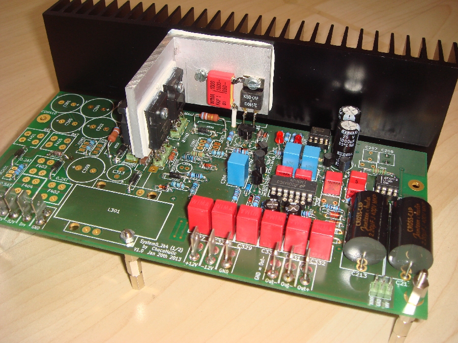

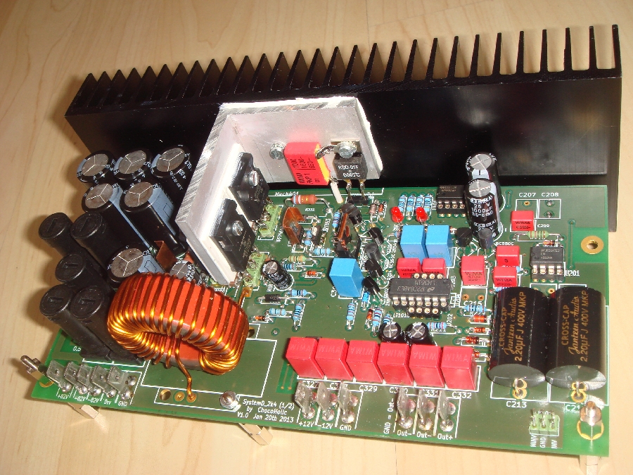

SystemD_2kW, any interest for an open design?

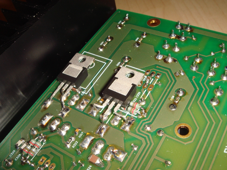

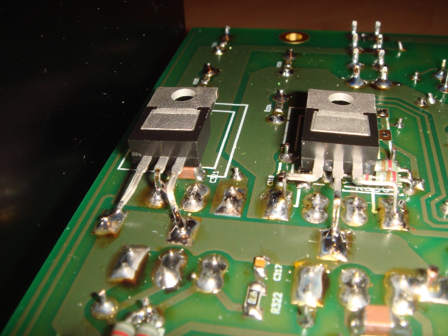

...finally... Fully assembled.

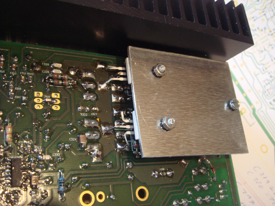

TO220 diodes for freewheeling on the backside. Required cooling depends on application.
Did you manage to switch it on with a full volatge applied to it ?
Of course it's up and running.
Pretty important thing is to change R410 and R411 to low values (50...100R), otherwise the clamping function of Q205 and Q206 is to soft and in combination with integrating gains the amp could fall into LF oscillation, when triggered with large rectangle signals.
After this, the intended fundamental behavior was in place.
Step response with rise times around 5us.
Clipping around 1.2kW into 2R, means with two amps in bridged mode we will get the 2.4kW into 4R as intended.
Noise is Ok, at least I cannot hear the noise on the speakers.
Dynamic hysteresis is also working and keeps output ripple small up to about 90% of clipping limit.

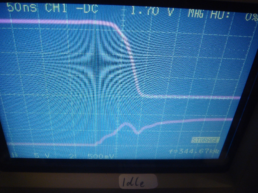

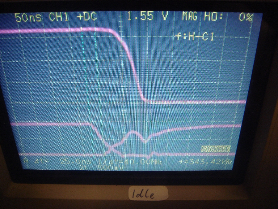

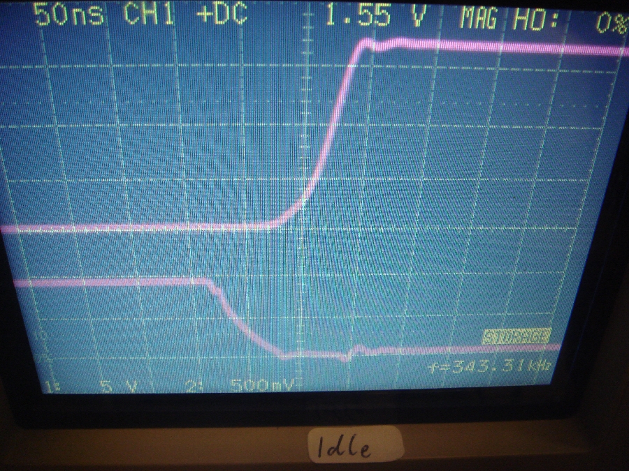

...Reactance asked for timing diagrams, so let's start with the measurements which are related to gate drive timing in idle situation.
The first two screen shots show Uds (upper trace) and Ugs (lower trace) of the lower MosFet.
Screen Shot 1 shows the half bridge sloping from negative rail to positive rail.
After the Ugs is being pulled below the treshhold voltage it still takes some tens of ns before the N-chanel becomes non conductive and the sloping of Vgs begins.
Despite being field controlled devices - MosFets have an turn off delay, which is caused by its internal gate resistance and it capacitances.
...Vds begins to slope, this is caused by the inductive current of the output filter.
About 20-30ns after the sloping of Vds has started it becomes more steep.
This is the point when the upper MosFet becomes conductive.
So with this dead time setting (25ns at the output of the IRS20957) and totem pole BJTs I am working with a forced sloping during idle.
This causes some more idle losses, but reduces dead time distortion.

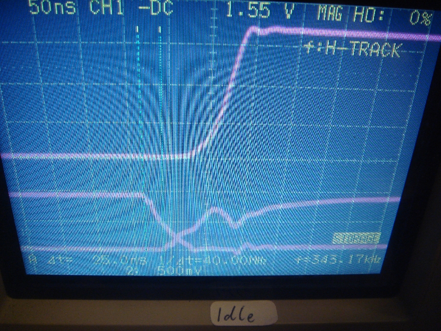

Screen Shot 2 shows the half bridge sloping from positive rail to negative rail.
While screen shot 1 & 2 are showing only truly measured traces, the screen shot 3 & 4 additionally show a third constructed trace which shows the anticipated gate drive of the upper MosFet.
All measurements where done with 1:10 probes

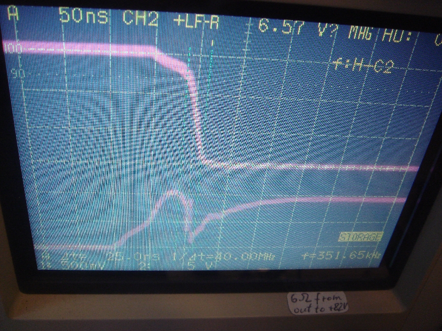

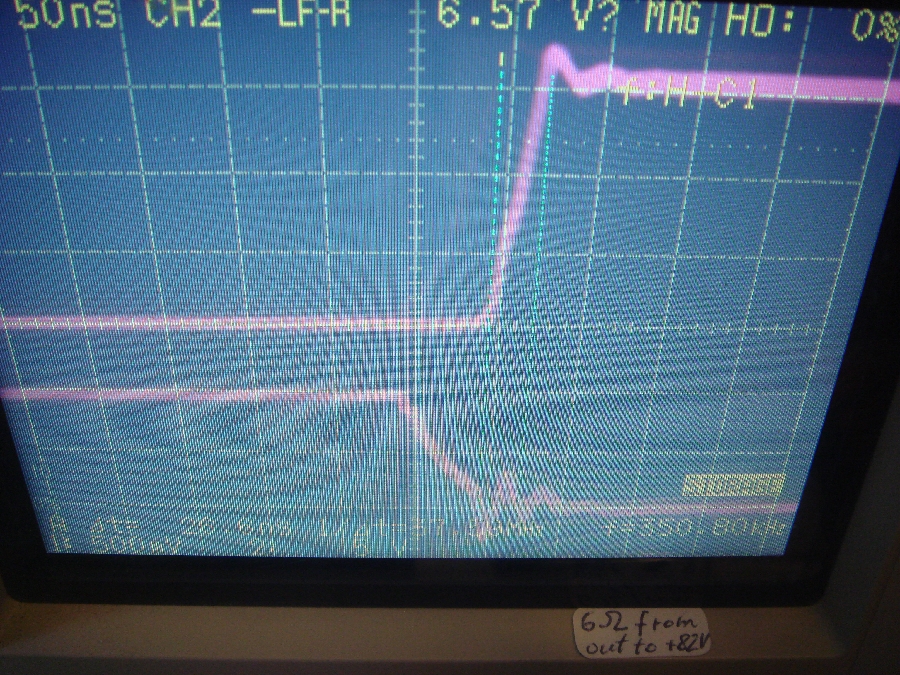

Besides timing - the measurements of Vgs and Vds of the lower MosFet also can tell us whether the circuit behaves well at higher loads or if it is suffering badly from HF resonances.
For this I am typically doing a forced hard switching test.
Input of the amp shorted. From output to positive rail a load resistor.
The attached screen shots show the behavior with 6R load from the amplifier output to the positive rail.
While such tests in amps with 40V rails are easy going.. at 60V rails the arcing becomes already respectable.. and this amp with the 82V rails really works like a welding machine..
No uncontrolled ringing. Trouble free level of disturbances.
Compared to the earlier values in the schematics I adjusted the snubber to 10R and 330p.
A more sophisticated resonant snubbering with mini torroids across the legs of the snubber resistors showed further slight improvement, but is not worth the efforts.

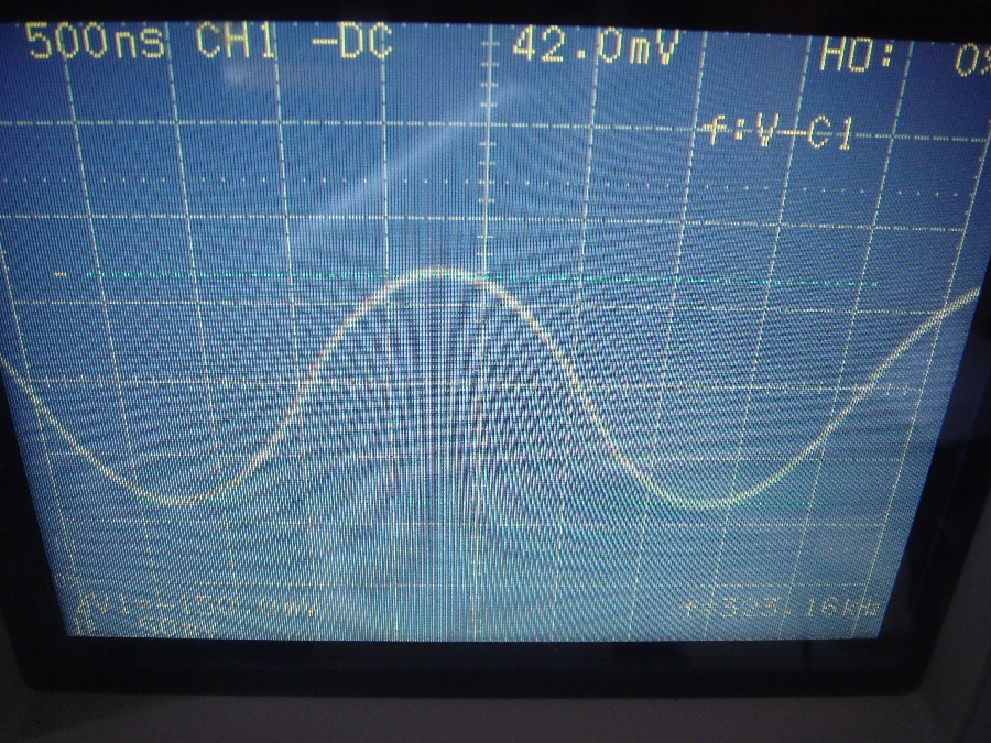

The output carrier is measured with a 1:10 probe. Means the residuals are than 0.5Vrms.
Also nicely clean without HF junk.
Thank you for going through all the effort recording timing(s)
The waves forms looks very clean a testament of the hard work you put into the beast. I think you should give a name. "Choc-D amplifier" :D
Question: with the totem pole configuration did you use a diode in reverse (in parallel) with the gate resistor, to allow faster mosfet turn off behavior during switching transitions ? or is this already achieved with the totem pole.
Yes the diode speeds up the turn off by factor 2-3 vs discharging the gates through the resistors.
This direct discharge also pulls heat from the gate resistors into the PNP BJT.
So the NPN does not need any heats sink and most of the charging losses for turn on are deposited in the gate resistors, while the PNP needs about 150mm² heat sink in order to handle the discharging losses.
...small heat sink for the freewheeling diodes.
When listening to internet radio touching clipping levels continuously, then the large heat sink stabilizes at about 60C (idle below 40C), while the diode heat sink reaches about 75C (idle around 40C).
The output choke reaches about 90C (idle around 45C).
Of course all that without any fan and ambient of approx 20C .

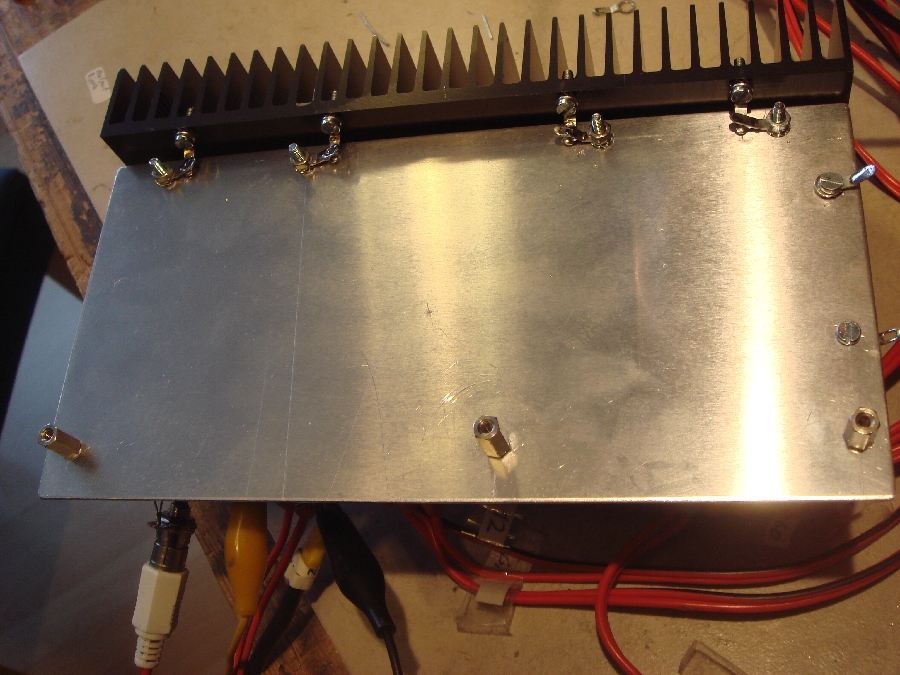

The search for the distortion mechanisms is always a new adventure.
In this case there were two effects which are worth to be told.
1. The parallel connection of the output caps provides a low inductance for the filter and the geometric arrangement in a sequence ensures lowest RF junk at the output – but the track inductance already becomes visible when picking the D portion. It makes a huge difference if you pick the signal from the output connector or from C327. After some experiments I decided to keep the layout as it is, but solder a folded copper piece on top of the track.
2. The electromagnetic fields do impact on the distortions as well, so it matters whether the heat sinks are grounded or not – and where. It turned out that having them all connected close together and ground it at the power stage and psu ground.
Attached some pictures and the THD measurements and IMD measurements for 1W, 10W, 100W, 1kW. The measurements where done with LM361 as comparator and NE5532 as OP amp.

I forgot to highlight that I slightly reduced the switching frequency during my adjustments.
Attached a screen shot from the output ripple with the settings, that I used for the shown THD.
fs is now around 320kHz and the output ripple is about 530mVrms.
