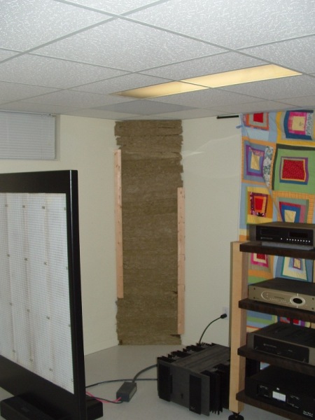

ok here are some updates
I wasn't to satisfied with the dynamics,I felt is was to smooth and a feeling of 2D instead of 3D after the electrical mods I did in the room and the panels,as if I could find more detail and kinda made the pv14 the wart of the system.
so I changed my CJ PV14L2 preamp for a CJ PREMIER 10
a 93 model compared to a 2006.
the differrence is really there!!all the smoothness of the CJ with the dynamics I was looking for.
the mids were more fuller,bass richerand the high's divine😎
and as you can see I placed bass traps in the corners made of roxul 24" wide flling the whole corner,took me the whole bag(35$)
that got the bass to me tighter,more precise,the timbres also got better cause now I have a lot less cancelation in the room,and less aggrevating echo.

I see your amp on the floor. Is that because it takes two of you to lift it onto a shelf?
Oh, and you might want to throw an old bedsheet in front of the rock wool to prevent breathing the dust.
yeah that's only one side the other mono block is on the other side they wheigh 185lbs each,but I'm planning to lift them up with a wooden shelf of about 2" thick and spikes

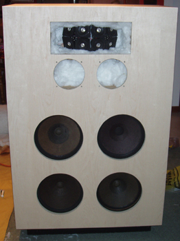

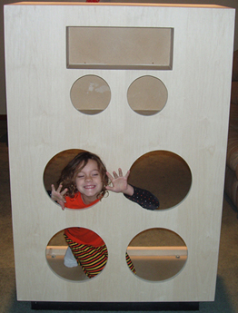

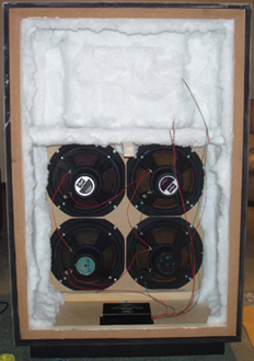

Bozak Concert Grands Completed!
First, I'd like to thank everyone on this board, not only for offering invaluable expertise, but also for giving me moral support after botching up a veneer job!
I followed Rudy Bozaks plans pretty much verbatum, but because I was not able to obtain some of the original parts I was forced to make some slight modifications - none of which affect sound. Cabinet size was kept faithful to the original specs.
The speakers consist of 4 -12" woofers (8-ohm), 2 - 6" midranges (16-ohm) and 8 - 3" tweeters (8-ohm). The N-101A 8-ohm networks are passive, crossing over at 800 and 2500 Hz 6db/octave.
Not able to obtain a second tweeter array bracket, I split the one that I had, using each half of the bracket for the bottom of the array and used metal tabs for the upper.
I was not able to find midrange mounting rings, so fashioned my own using a router and the trusty 'ol Jasper.
The woofer rings originally had provision for mounting a tweeter pair (intended for the smaller Concerto series), so using a hack saw I cut the center brackets out, then belt sanded the outer rings to fit inside the cabinet.
The heavy duty speaker terminals from Parts Express are worth every penny and then some, but because those things pertrude so far out of the back of the cabinet, I routed out a circle... you can see the attached pic to see what I've done...
