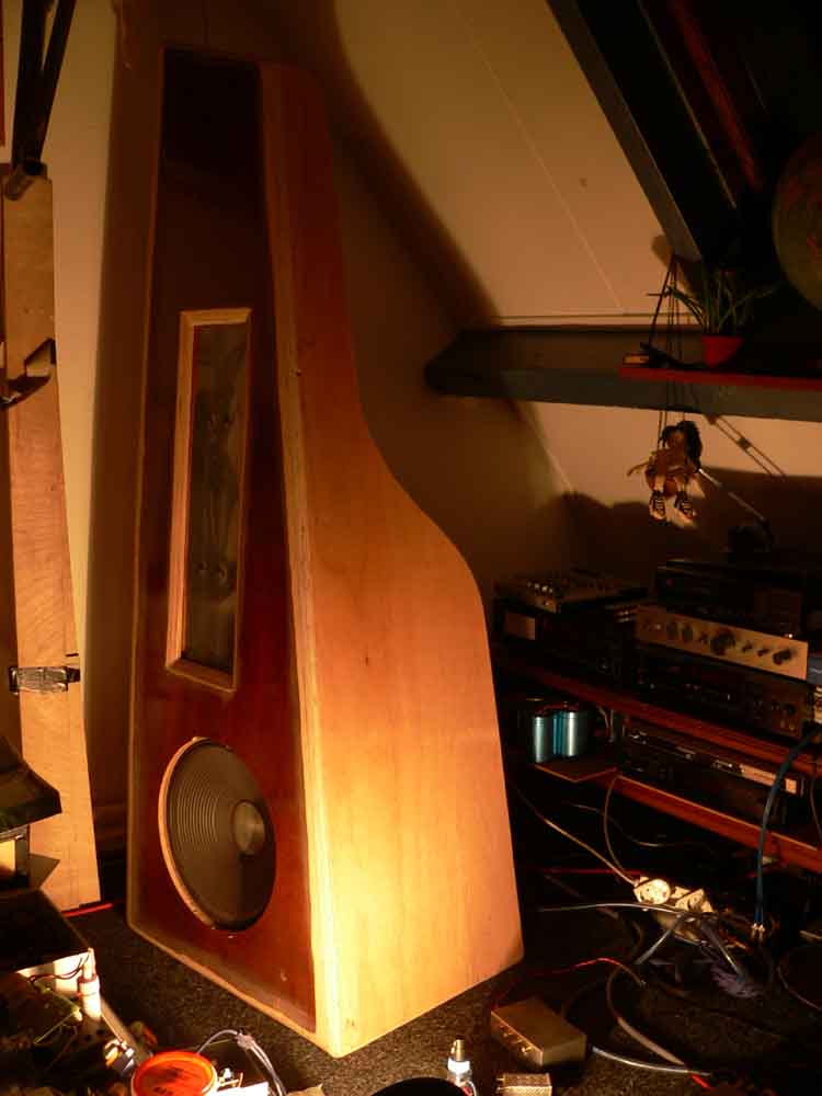

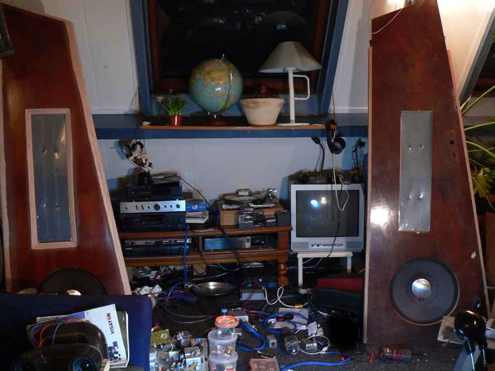

The two of them, the right speaker will eventually look like the left speaker...
They contain Quad ESL-57 treble panels with JBL 2220A woofers. Both very old drivers, but absolutely great sounding ones! 🙂
The 15" woofer has been reconed in 1998, so they perform like 'fresh' ones...alnico magnets....
This project cost me 200EUR. The wood came from an old door (the right speaker still has the holes for the lock in it 😀 , but I like the 'worn' look with these old drivers...😎 )
It sure sounds like a lot more expensive pair!
Soon I will build a more powerfull amp for the woofers...I use AMP9 at the moment from 41hz.com IMO a great little amp!
