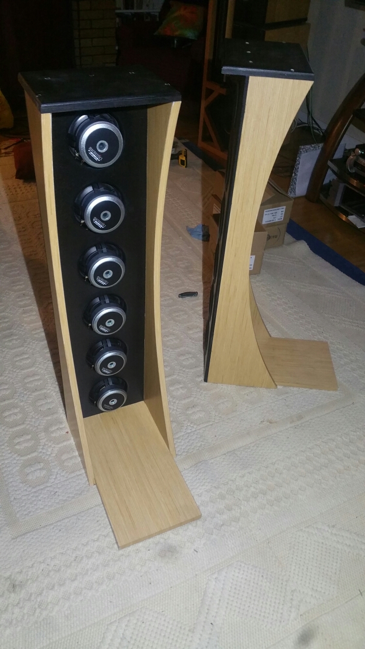

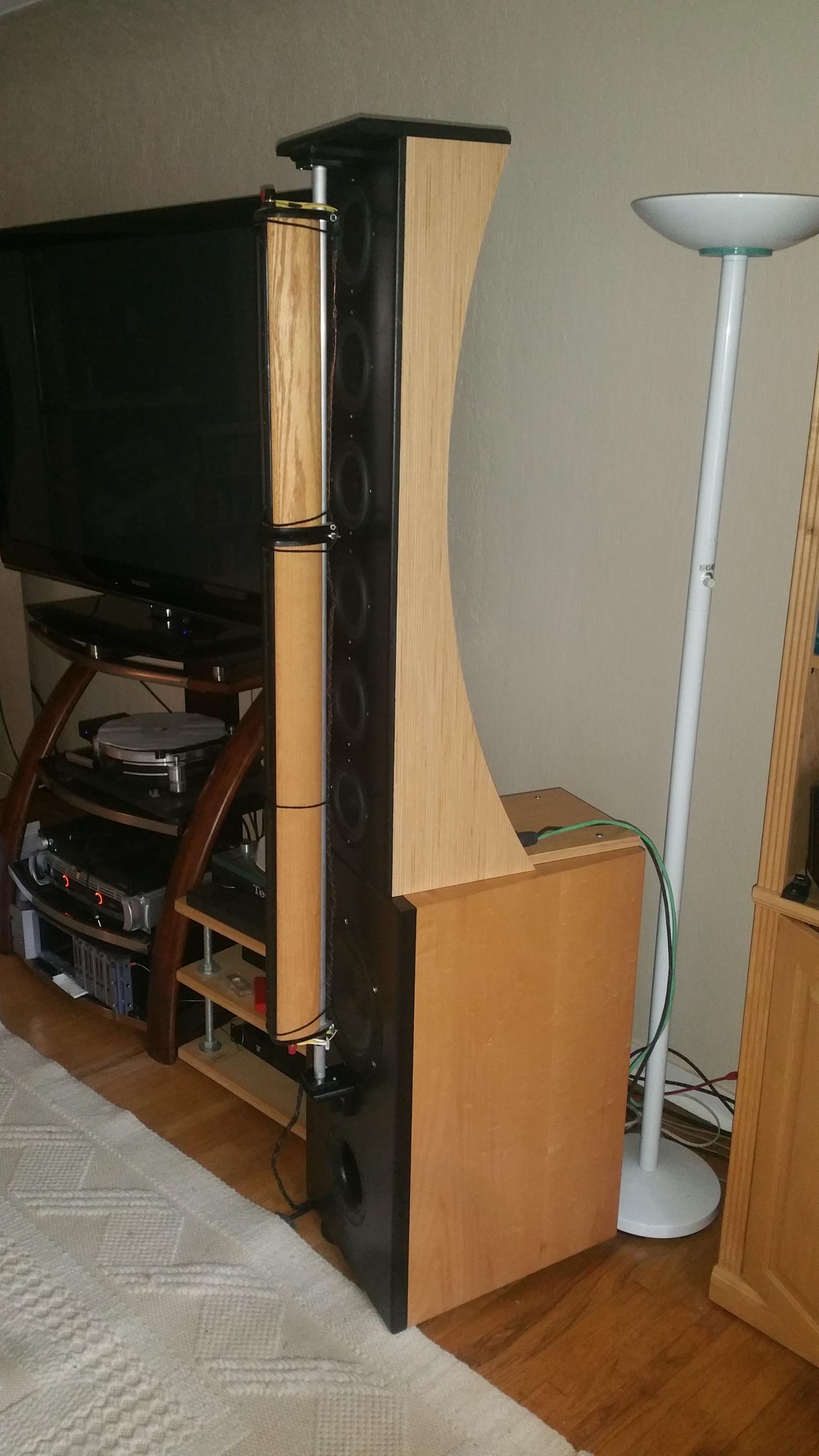

Thanks, each baffle uses 9 Dayton PT2C-8 planar tweeters and are flanked by a total of 24 6 1/2" poly cone mids. The mids are no name speakers but are the same Dayton uses in their B652 speakers. Dayton Audio T-Amp and B652 Portable Speaker System Bundle
6-1/2" Poly Cone Midbass Woofer 4 Ohm
Dayton Audio PT2C-8 Planar Tweeter
It's the mid drivers that are the open baffle part of the design. The baffles are crossed at 2500Hz and 70Hz at which point my distributed bass handles 70Hz and below.
Very nice! For those wanting to build something similar. PE has a pair of 5-1/4" Poly Woofers for $14.88/Pr. They say it's a buyout, but it is a Dynavox woofer, sold normally at $7.50/Ea. ($15.00/Pr.) by Dynavox. It has a 0.86 QTS.

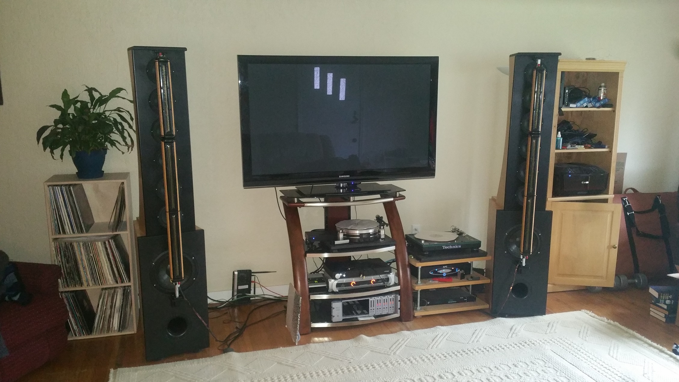

Hi Rob!
Just curious how much power do these speakers require to really sing? Also do these speakers seem to prefer either solid-state or tube amplification or doesn't that seem to be an issue? Beautiful to behold and I'm sure a pleasure to listen to as well!
I'm listening to: Dreamland by Yellowjackets
Thetubeguy1954
Hey Tubeguy,
They aren't very efficient due to the mid range choice. The mids are the limiting factor with an overall efficiency of 88.3 dB 2.83V/1m. The Qts is 0.95 and why I chose them for open baffle use. Still, just a few watts is all it takes at my usual listening levels.

24 woofers per channel with each driver at 88db. 3b increase per doubling of drivers so 2 is 91db, 4 at 94db, 8 at 97db..............if these aren't ridiculously loud with a 5 watt sett, somethings wrong! Lol

how tall are they?
bet the imaging is huge!
They are 7' 8" tall. The imaging is huge and yet very natural. The biggest downside being I won't be able to go any other route for my main system. I do want to build a couple different types of speakers but mainly I'm looking at ways to improve on the floor to ceiling variety. I really like full length line array type two way speakers with distributed bass. Variations of this theme is likely where my attention will be for the next few years.

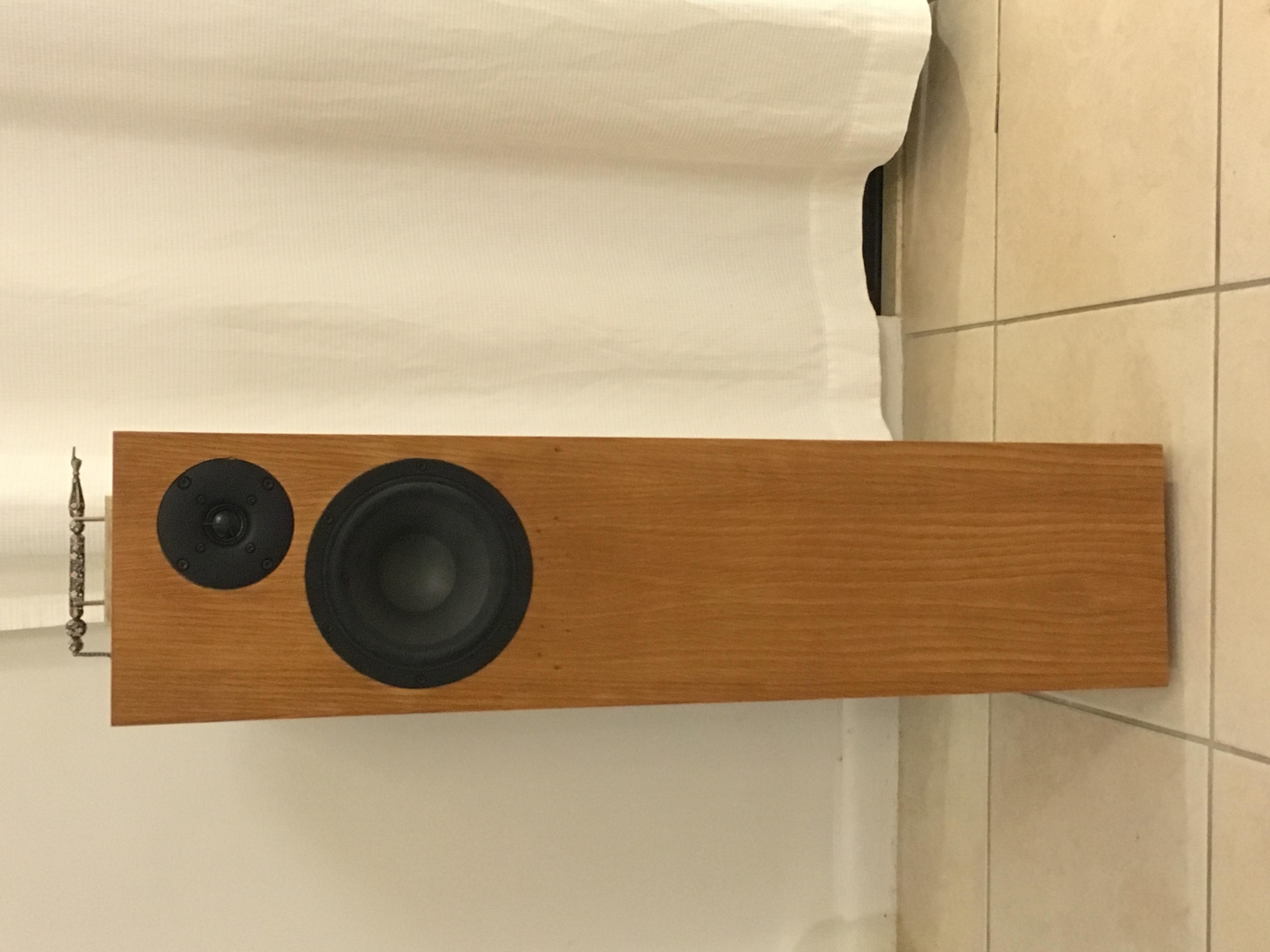

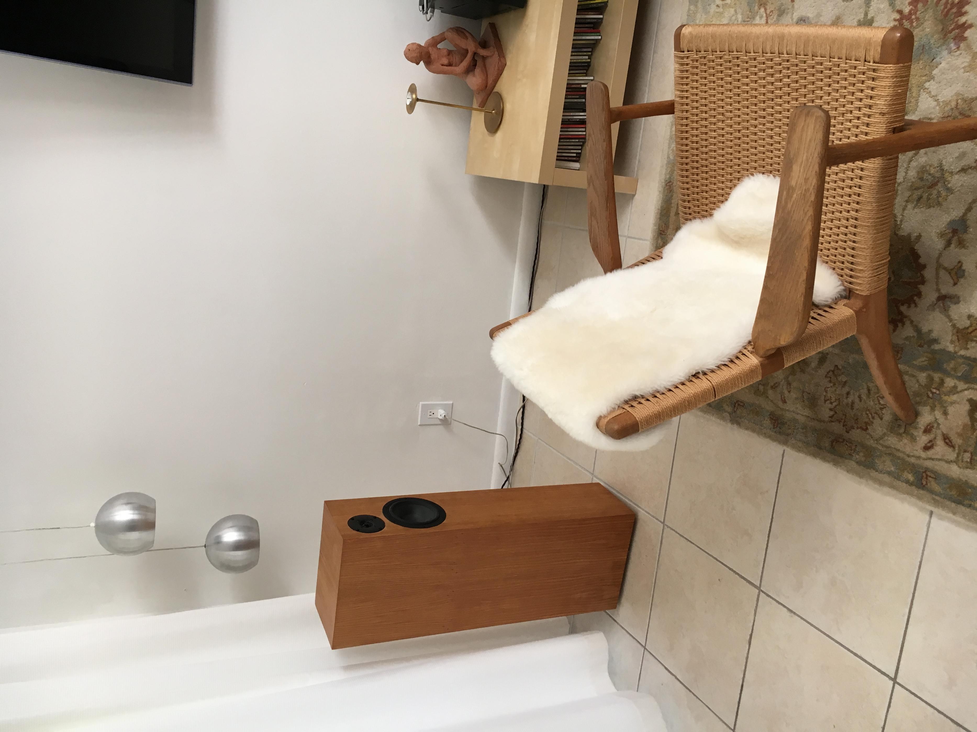

Tapered quarter wave construction of my own design. Asymmetric crossover 1st/2nd order. Nice response to high thirties. Reasonably flat response.
Can't figure out how to rotate the picture sorry.
Isn't it ironic...Great design, nice response, assymetrical XO, and built beautifully. But, can't figure out how to rotate a pic!!! Don't worry, we all go through things like that.
Yes it sure is! I can use Mathcad and lspcad but not rotate a picture. Go figure. Thanks for the kind words.
Yep, what Mayhem said. Those should be much more efficient than 88db.
You guys are both right Dennis. I've been getting brain cramps lately, lol. 88db is just a single driver. 😱
