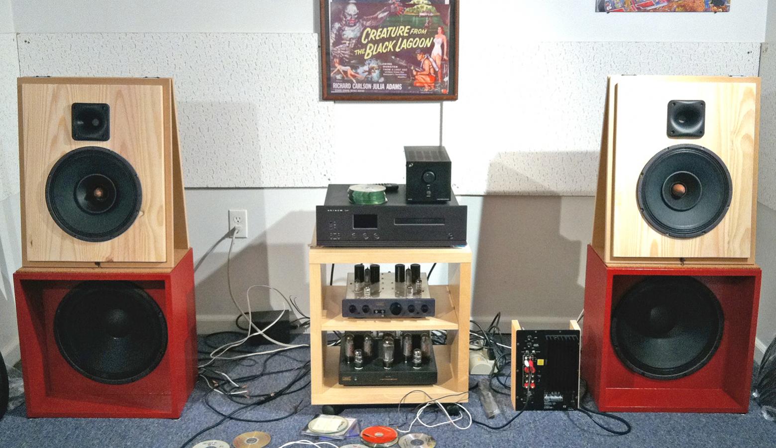

My reference system. Lost the room in the divorce but kept the system. I've been swapping out the tops trying various drivers but the modified Eminence 12LTAs with ASD1001 tweeters really sounds amazing to me. Love the H-frames fitted with Eminence Alpha 15. An all Eminence system can really sing.

Dammar-varnish them and you will see how much better they can sing ;)

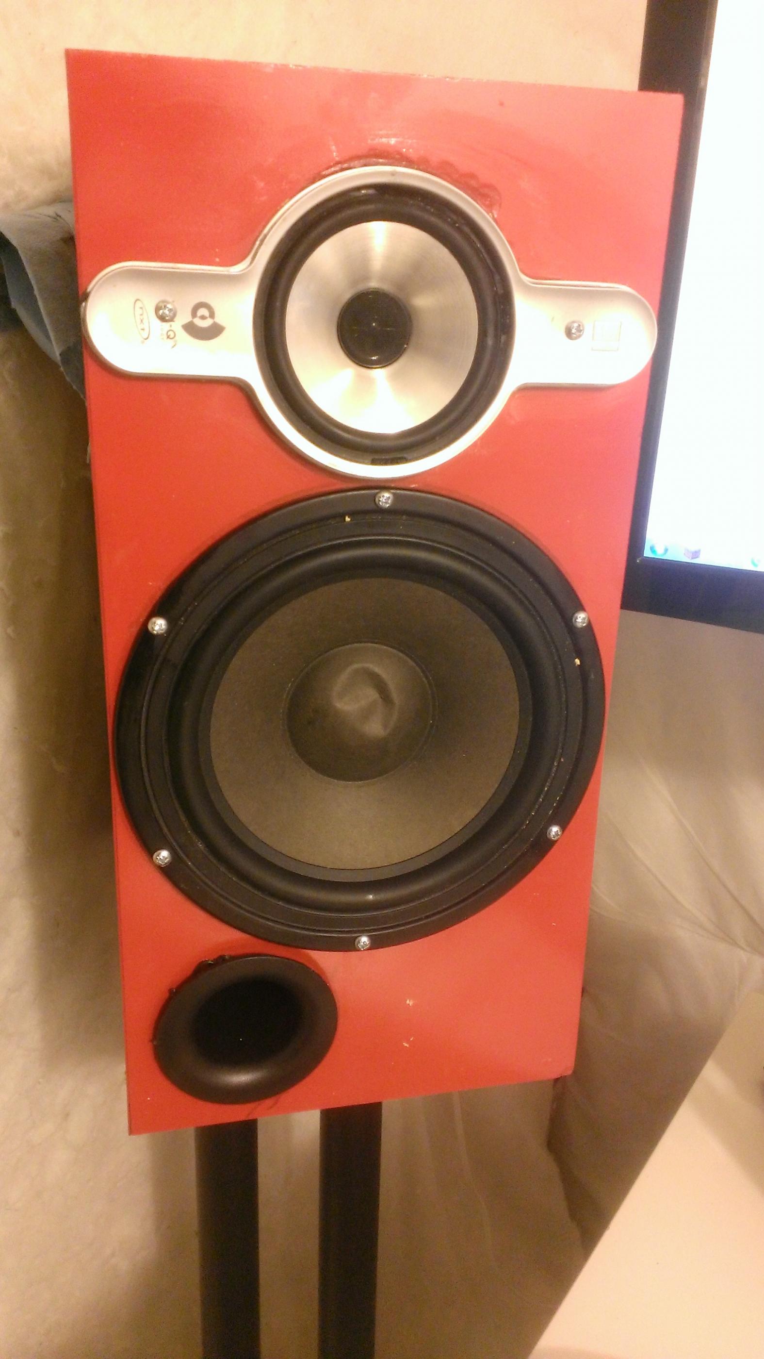

Scruffy can work!
If your new to diy don't let the finish of of posted designs put you off.
Most on here are of fantastic quality.
Im totally skint and needed some studio monitors for my cellar.
Used old chipboard furniture carcass' for this one.
front baffle dimensions determined by the 25mm thick tv stand top i had, which i basically cut in two.
the rest to make a roughly 20 lt cab
Mid and top provided by Kef egg drivers i got cheap from broken Kef HTS.Housed in sealed mid cab it uses the original crossover.
Bass ,no name 8" paper cone. lo/hi passed using cheap active car 2 way crossover.
iVe yet to measure but crossed 12db slopes, by ear 500hz to bass and a tad higher to the Kefs .
Rough and ready but pleased with the bass im getting.

looks real good. what are the crossover system & amplification?
Thanks nuconz! I miss listening to this system. It had impact, slam and nuance like nothing I've had before. Large efficient drivers rock!
The Cary Audio tube gear sounds really smooth. SLA70mk2 amp and SLP94 preamp.
The CD player is a tube Anthem CD1 - which also sounds really great.
The subwoofer amp blew recently and was replaced by a modest 100 watt Dayton.
There's another Dayton solid state amp that's not connected to anything sititng on top of the CD player.
Crossovers, from the bottom up:
- Eminence Alpha 15 H-frame powered and adjusted by subwoofer amp.
- Eminence 12LTA running full range (but modified with a phase plug which smoothes it out).
- Eminence ADS 1001 has a 1.33uf cap (maybe it's a 1uf or 1.47uf, I can't remember) and the smallest Dayton waveguide.
Pretty simple and barely a crossover at all.

and no resonance cabinet in sight, eh?
