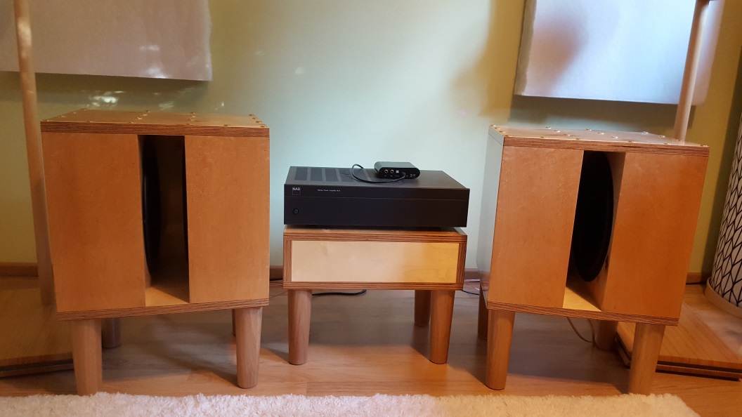

Here's my two RiPole subs along with their DIY amplifier (the wooden one in the middle)
More pictures at: DIY Speaker Set - Album on Imgur
fabulous!
The craftsmanship and design are wonderful. Thanks for sharing them with us. I am interested in how you chose this design, what considerations you made and how (if at all) this design met up with your expectations.

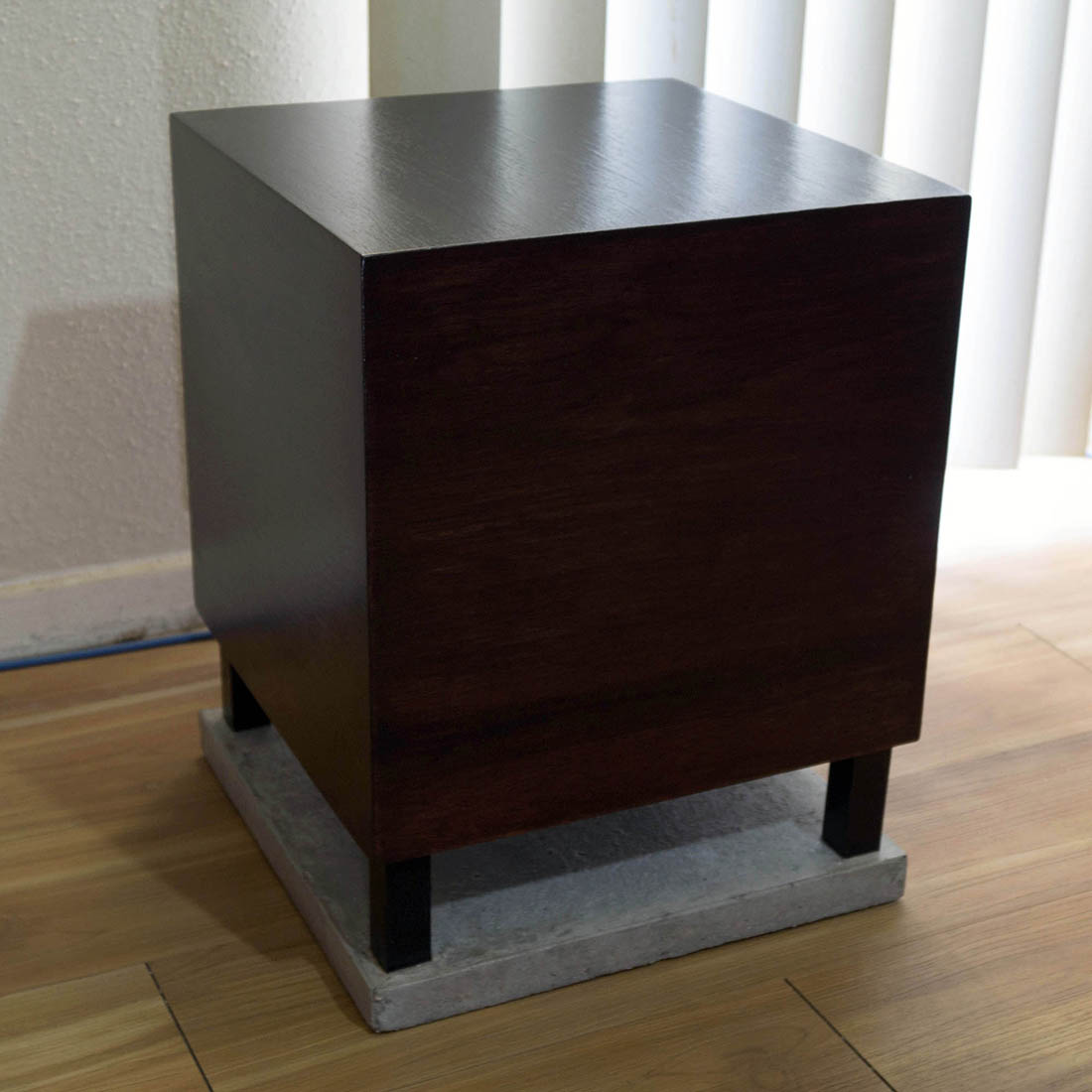

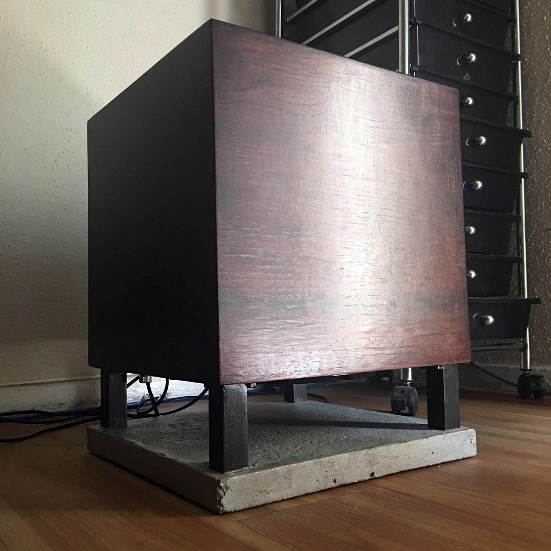

Here's mine, 2.1 setup with miniDSP, 8" Dayton Audio classic series driver. build diary at : http://www.diyaudio.com/forums/subwoofers/312374-concrete-base-subwoofer-build.html#post5188208
thanks. 😀Nice, but I prefer when the driver is directed towards me, even with a 20-80Hz channel.

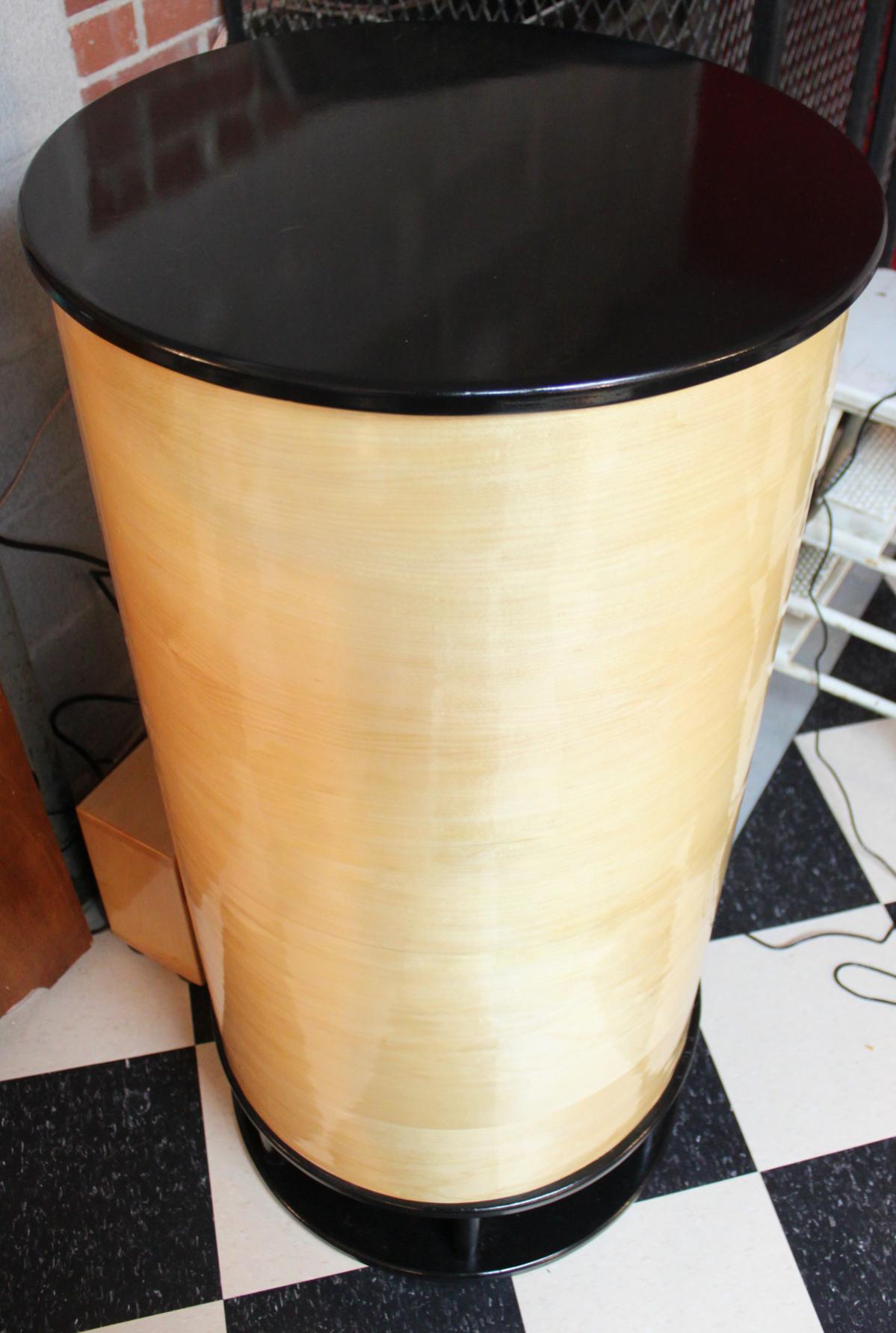

I figured I would help populate this thread a bit.
here's a sonotube sub I just finished for my home theater.
20"x36" tube with maple veneer, parts express classic sub.
After watching a few scenes from the Star Wars bluray's, I can safely say that it gets the job done quite well.
