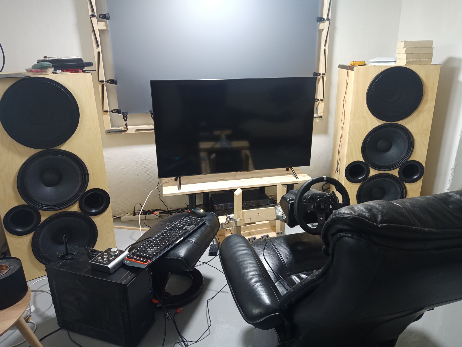

i do post on another but here is my contribution
dual-opposed sealed subwoofer, using 2x12" Infinity Kappa Perfect 12.1 connected in series, driven by behringer nu3000dsp
crossover setting : lpf 48Hz LR24 with 6dB bass boost 25Hz with Q 0.7
shake the room with very deep bass

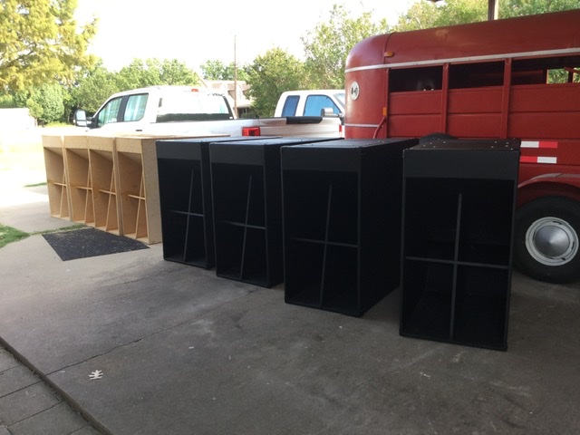

The DH horns
Four Dura-Tex’ed, and four to go.
A little bigger than a lab horn, made out of full half sheets of plywood (4x4x2 feet). 10 ft path from center of the driver to mouth, compression ratio abut 3:1, loaded with 18TBW100-8. Only 3 years since this project started.

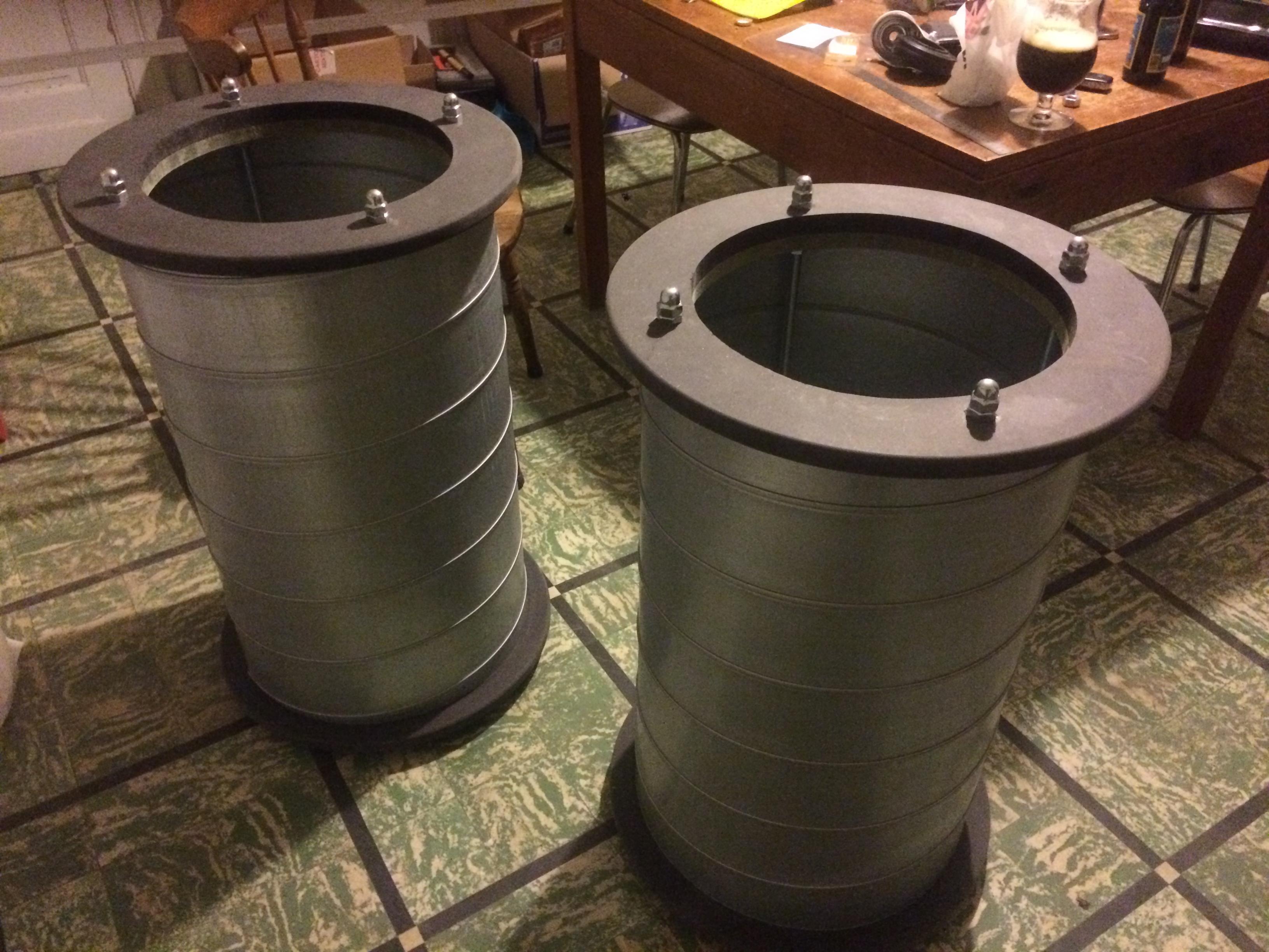

Here's my first sub build, which I finished today. Long and bumpy ride.
I'm the only audionut in the village.
Downfiring Dayton Audio RSS390HO-4 in sealed 45L alu venting pipes.

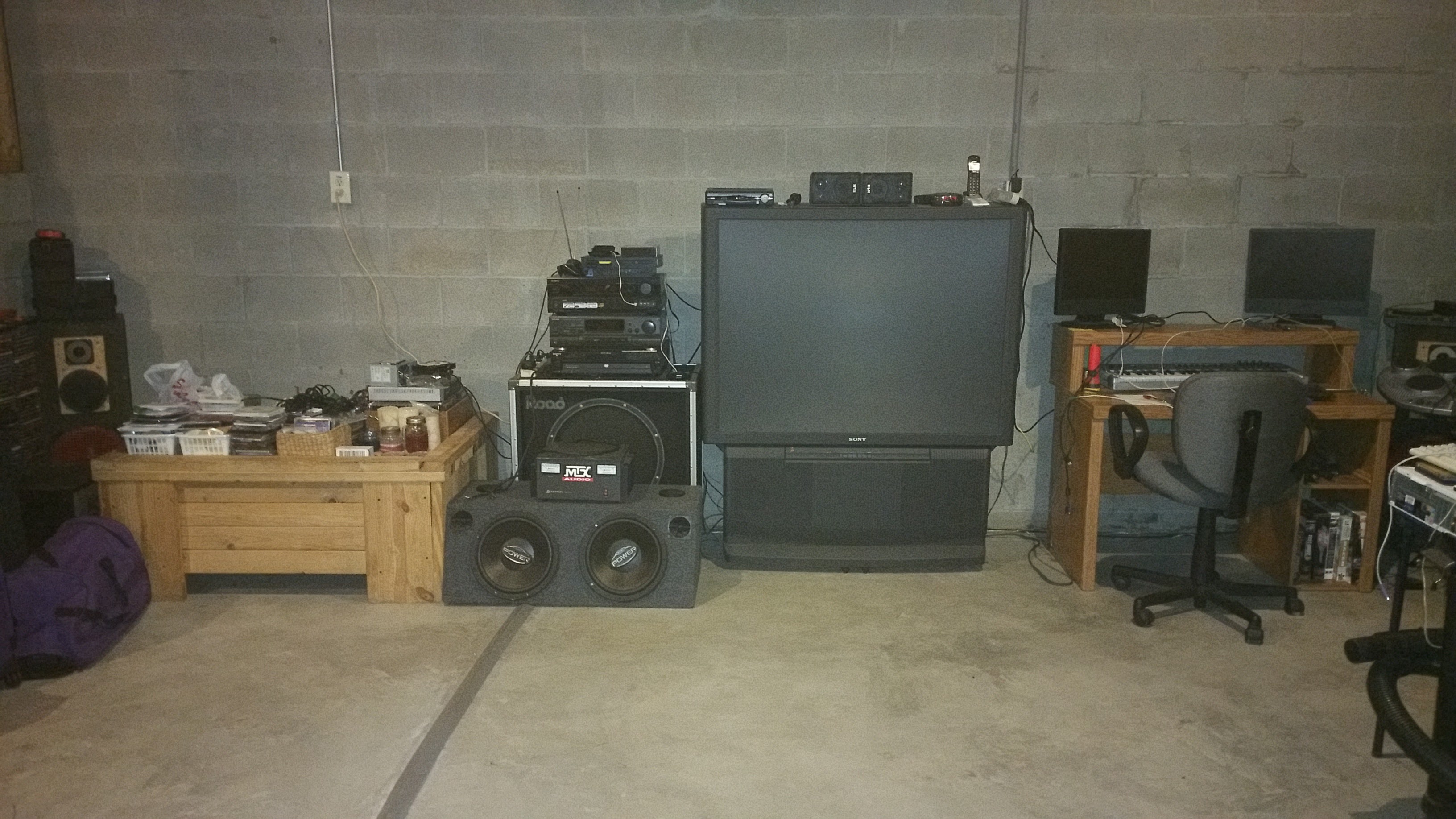

The table has two 12's in a BP4 enclosure that I built in 1998.
