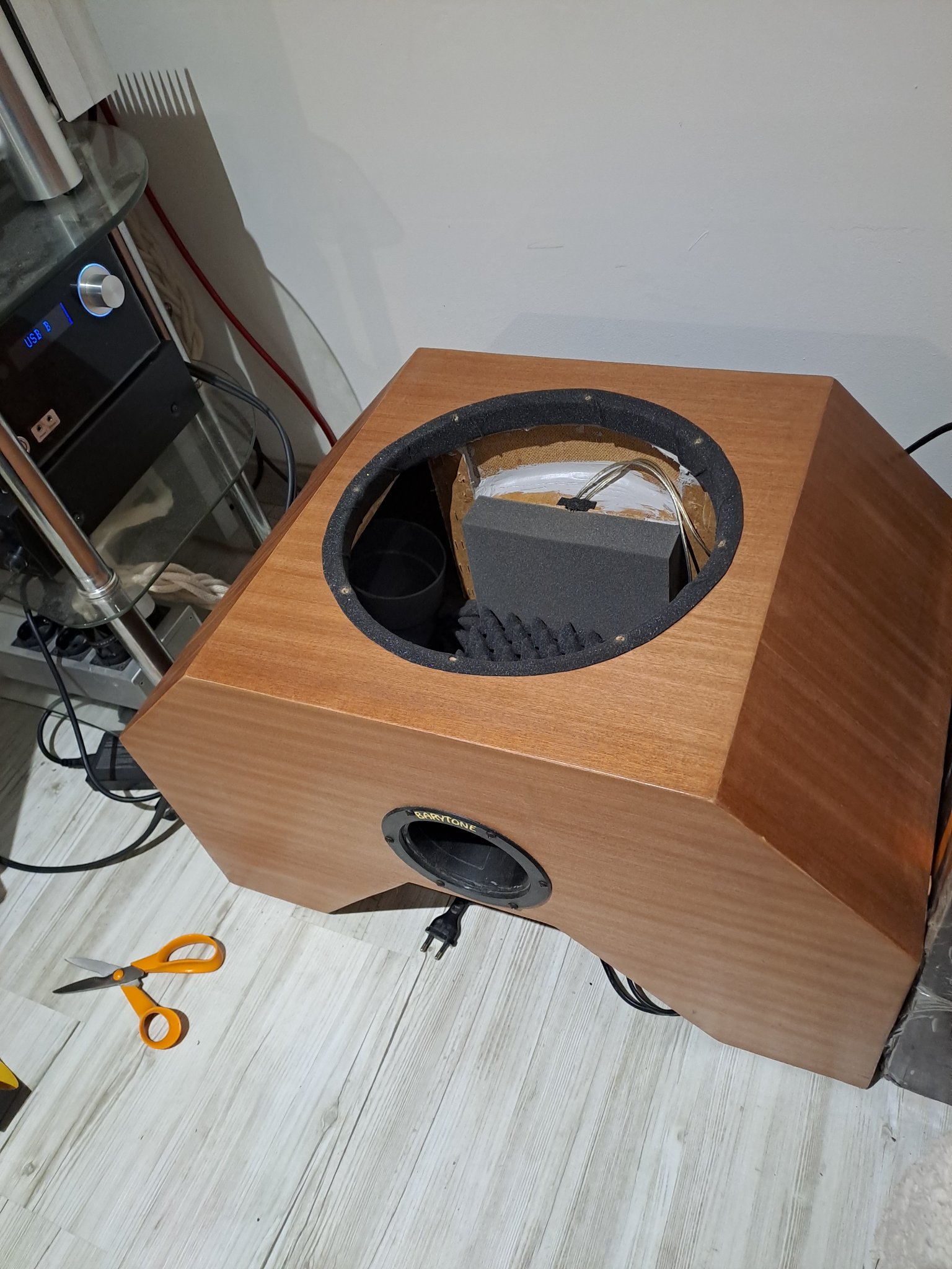

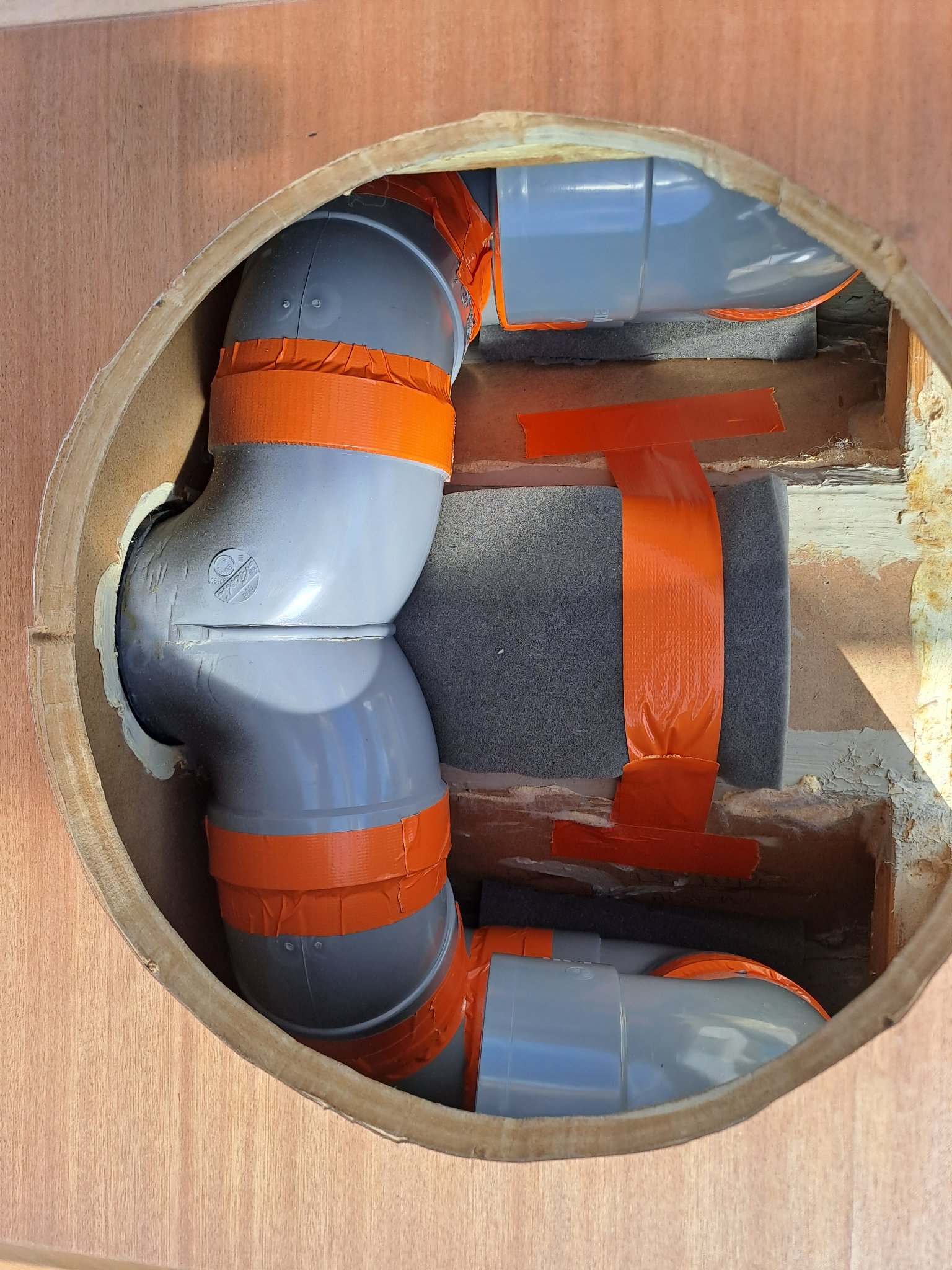

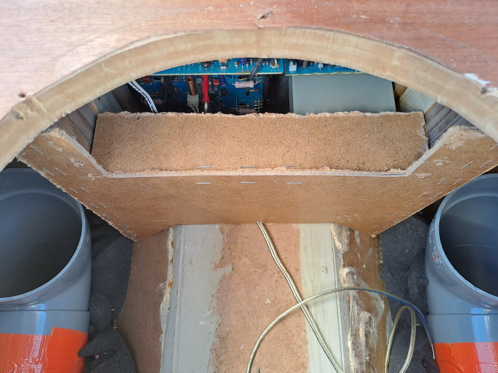

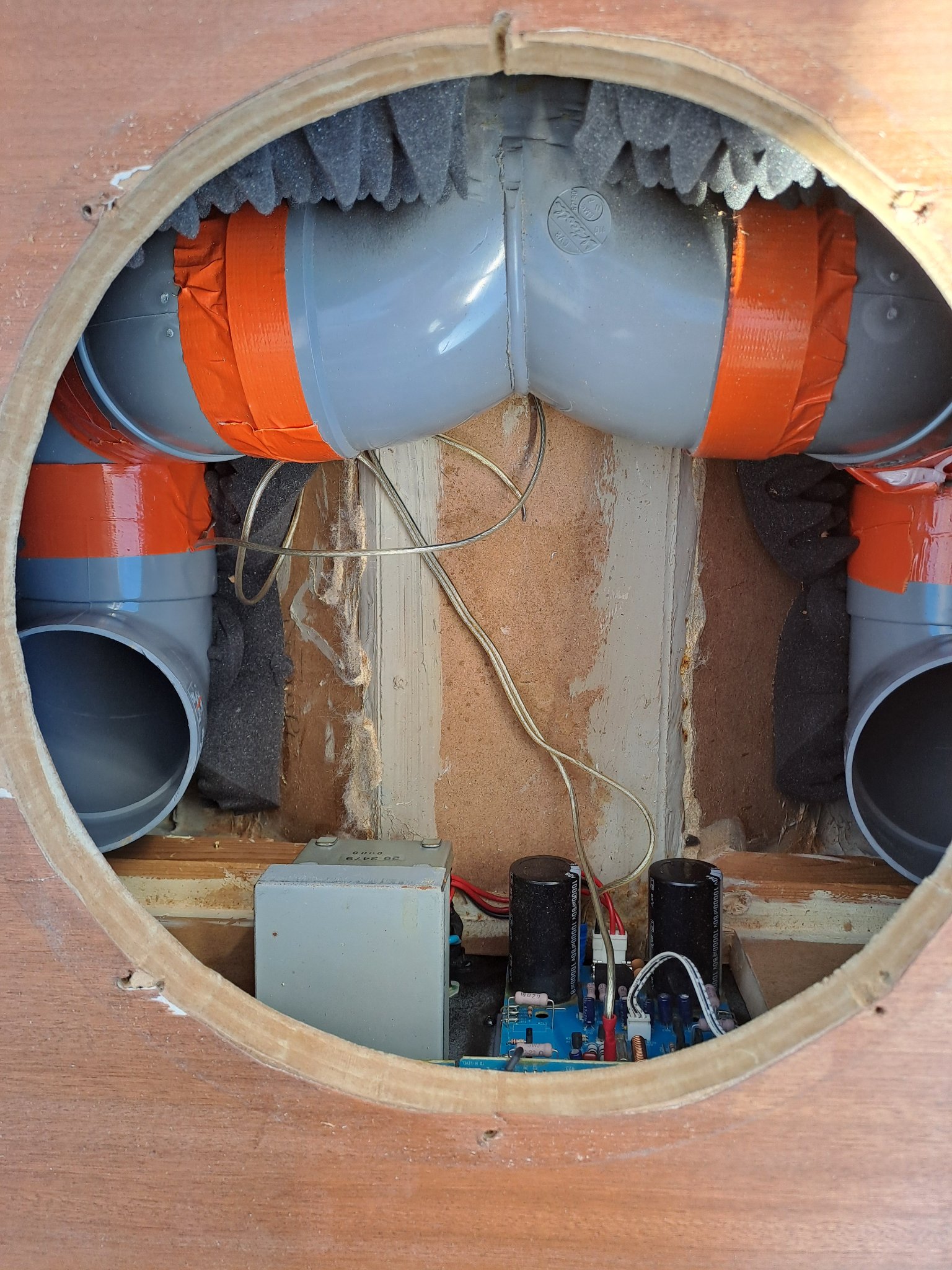

You have got a reflex tube, that has a "Y split" right at the exit of the port? How do you calculate the resonance frequency?Bonjour à tous !

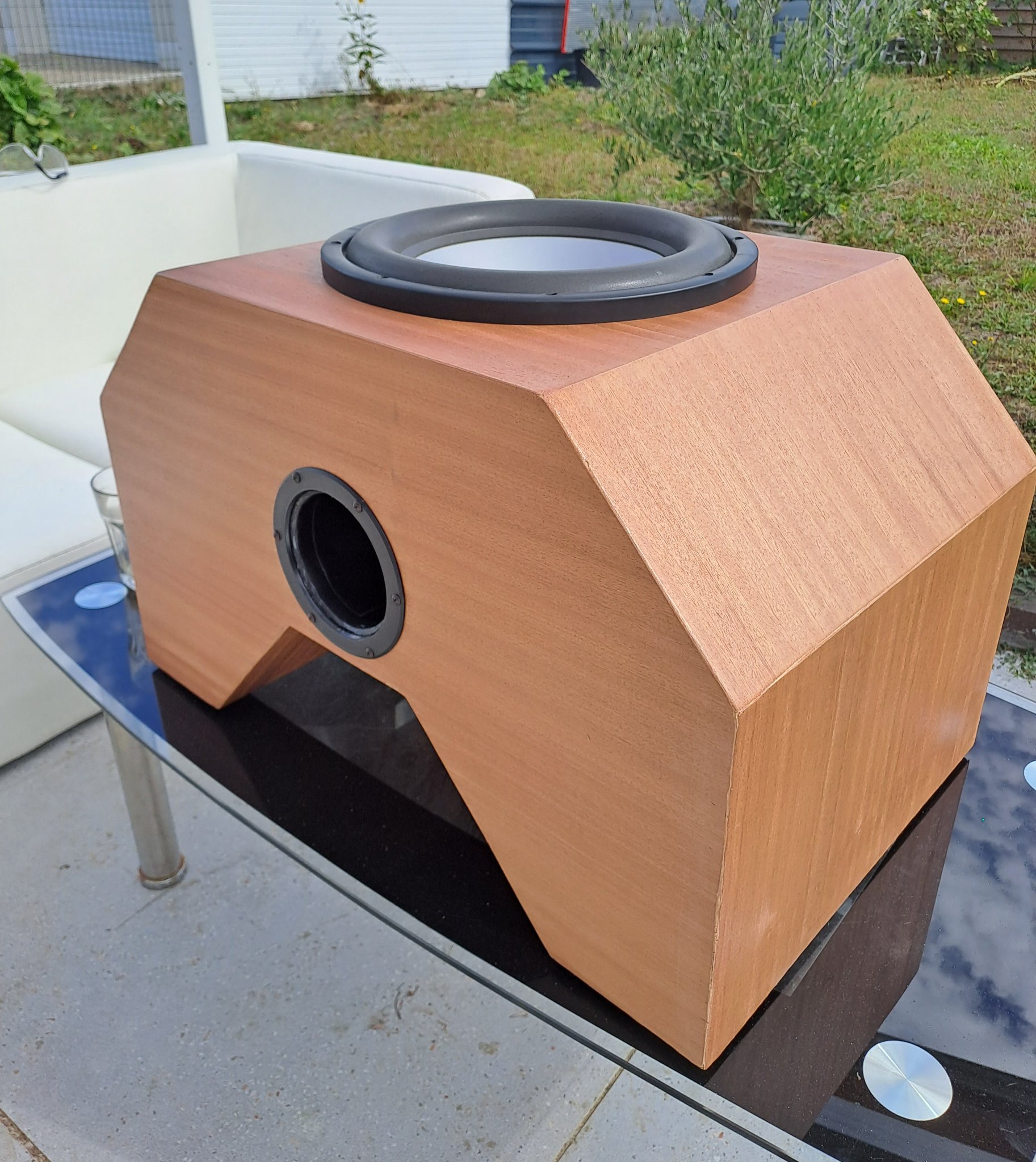

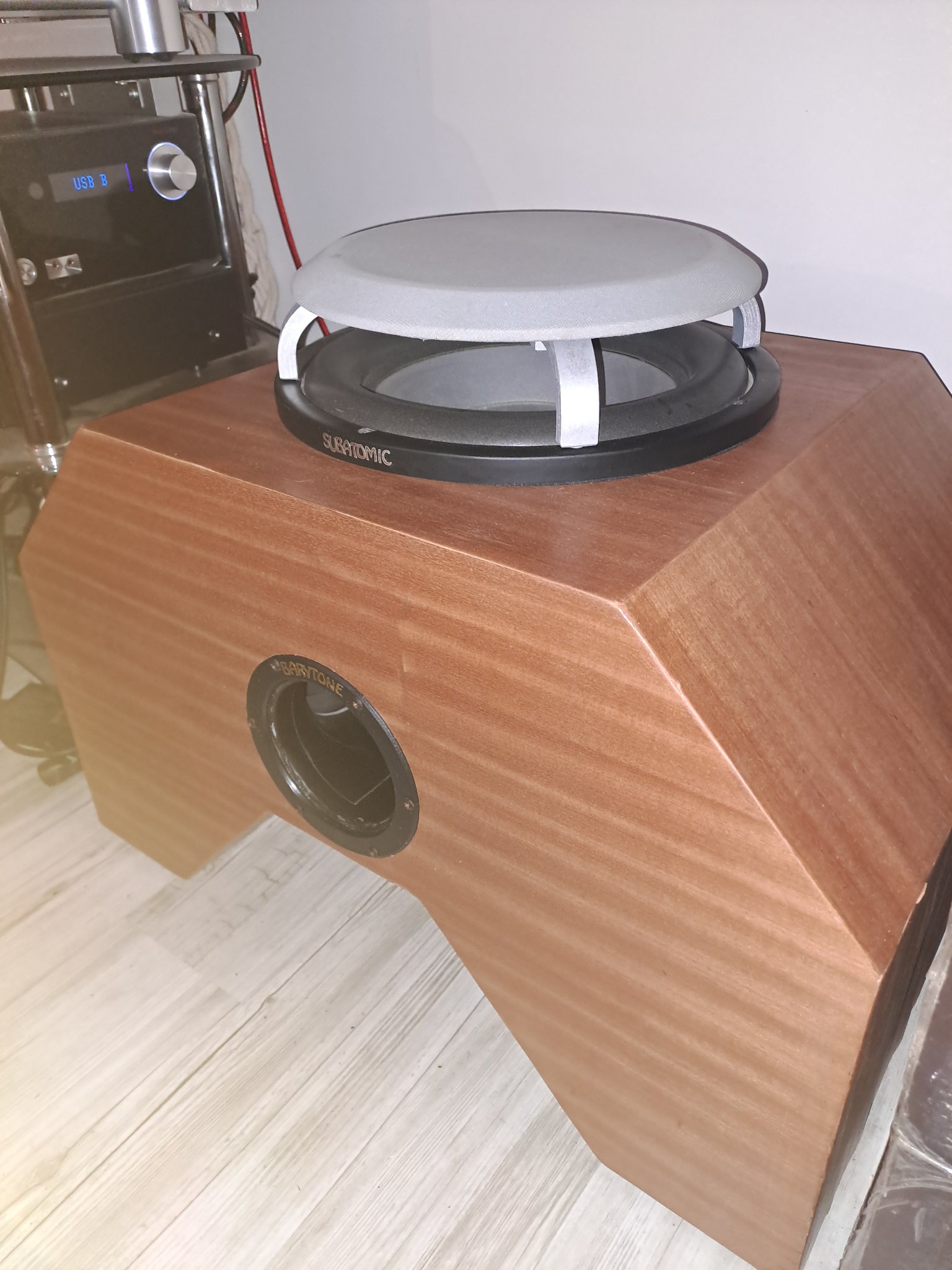

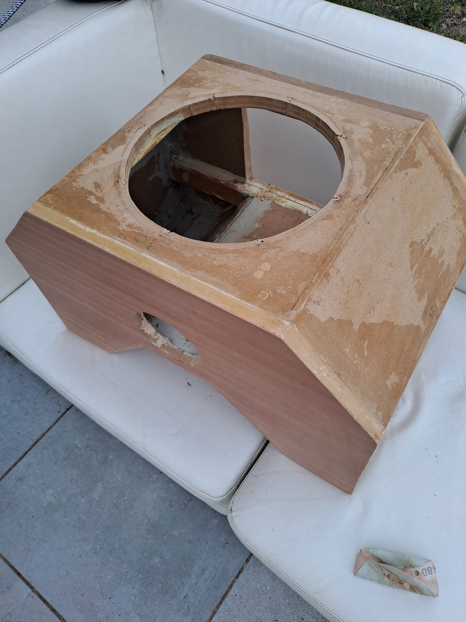

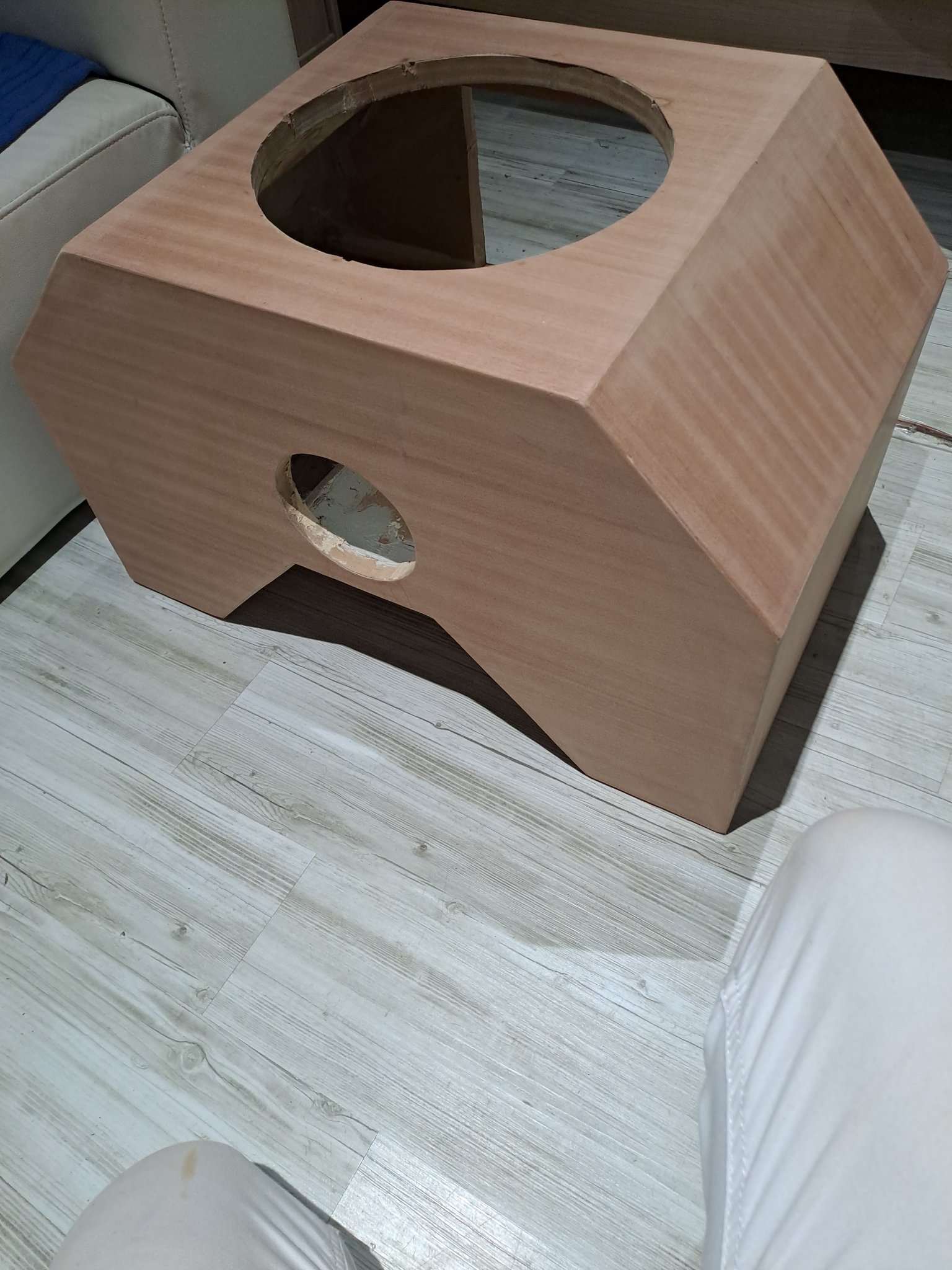

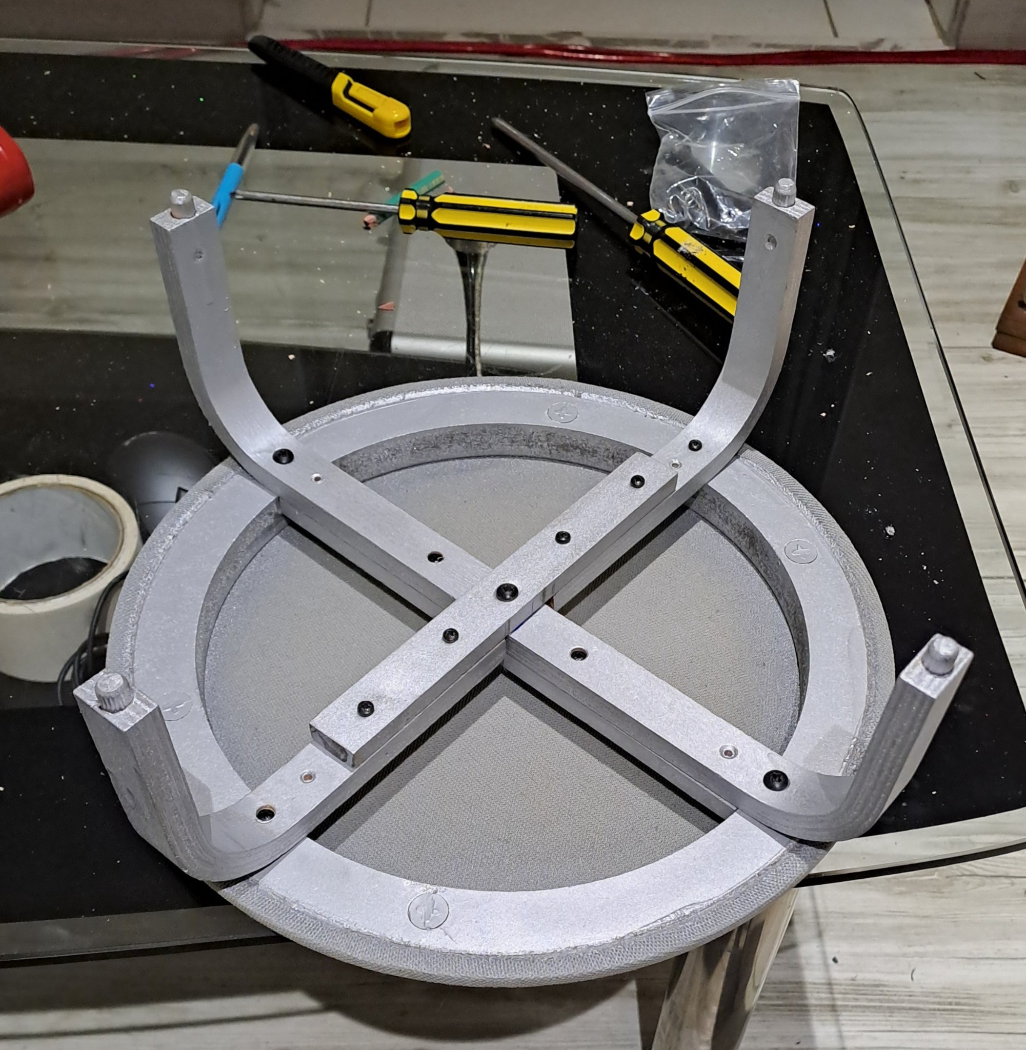

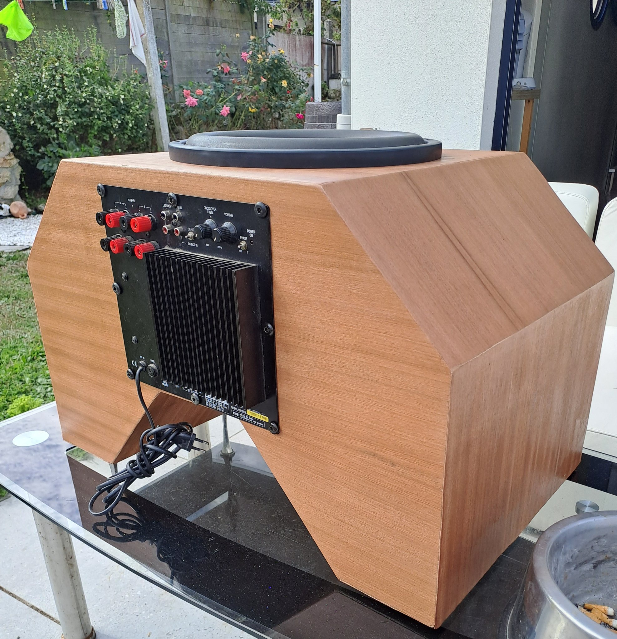

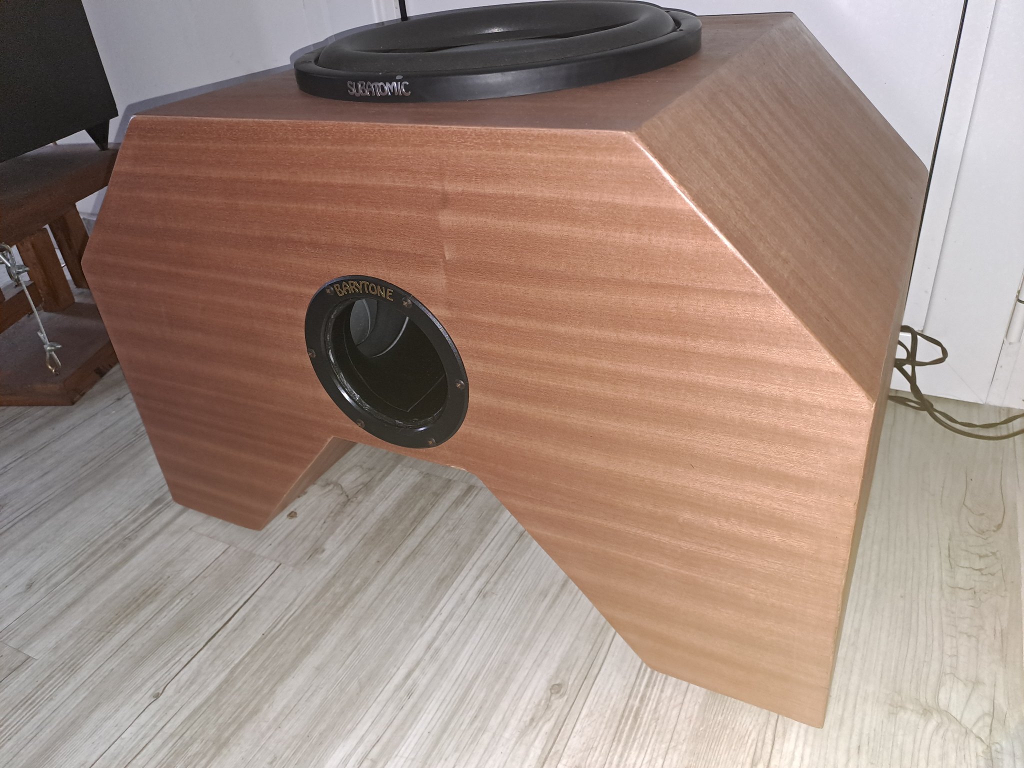

c'est mon caisson de basse :
View attachment 1419586View attachment 1419587View attachment 1419588View attachment 1419589View attachment 1419590View attachment 1419591View attachment 1419592View attachment 1419593View attachment 1419594View attachment 1419595View attachment 1419596View attachment 1419597View attachment 1419598View attachment 1419599
Good night ! 😉
Hello Jukkam,
I chose the lowest possible resonance frequency, like a "ripole" subwoofer.
My subwoofer goes down to 12 Hz.

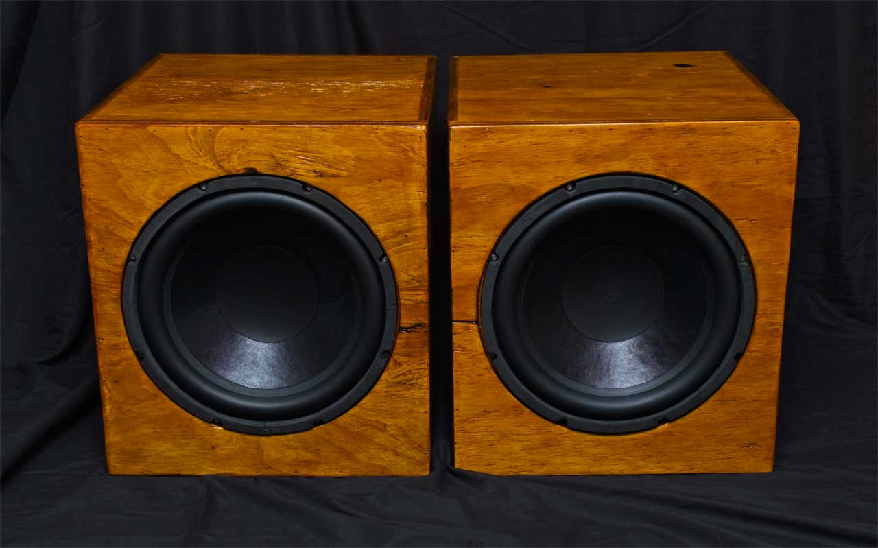

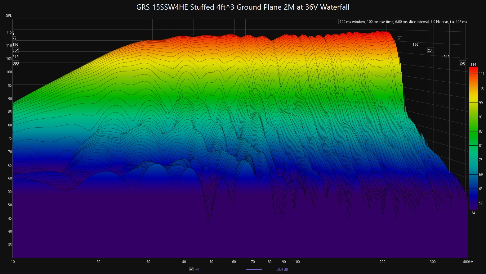

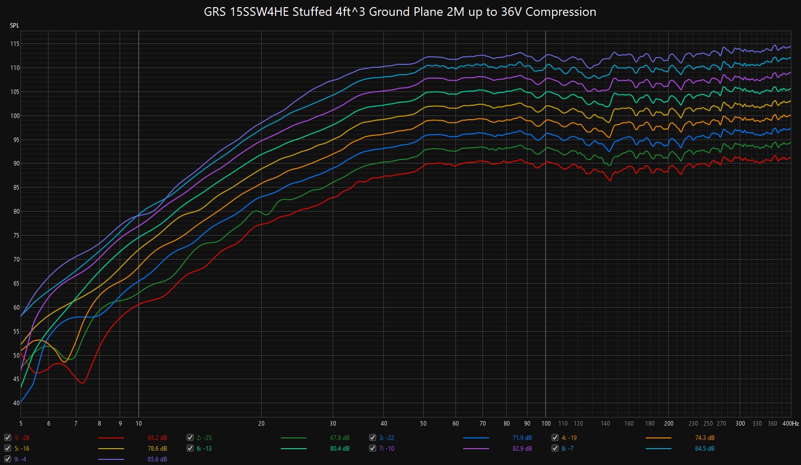

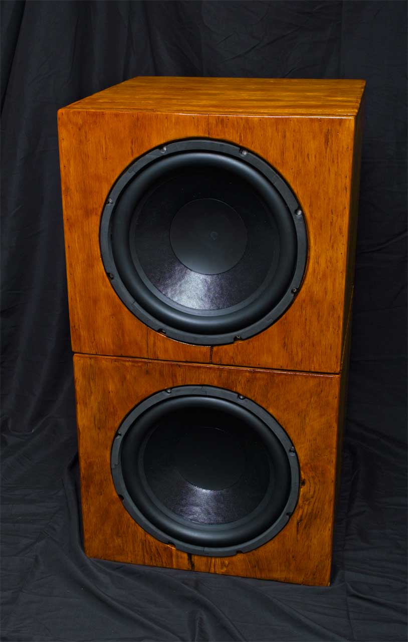

Finished two more stackers.
GRS15SSW4HE drivers
4 ft^3, 4lbs stuffing (polyfil)
21" x 19" x 22" (15mm pine rough cdx plywood; stud bracing)
57lbs each
Metrics are from a single woofer, ground plane, 2 meters, to compression at 10~16hz.
Very best,
GRS15SSW4HE drivers
57lbs each
