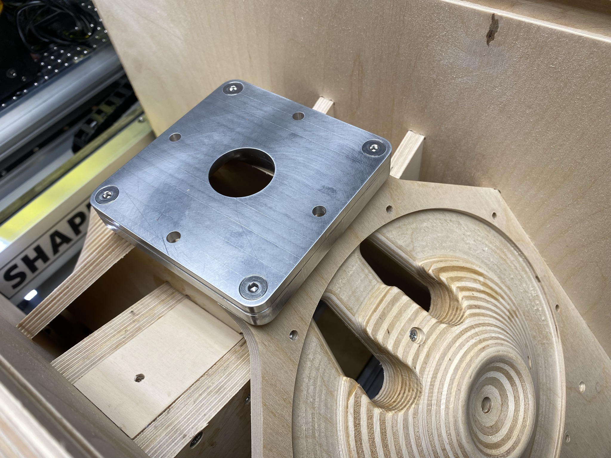

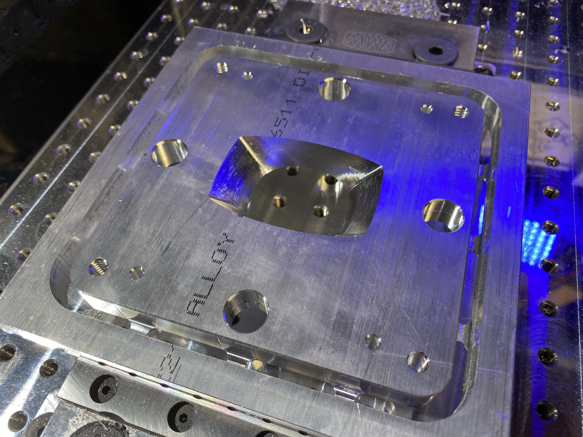

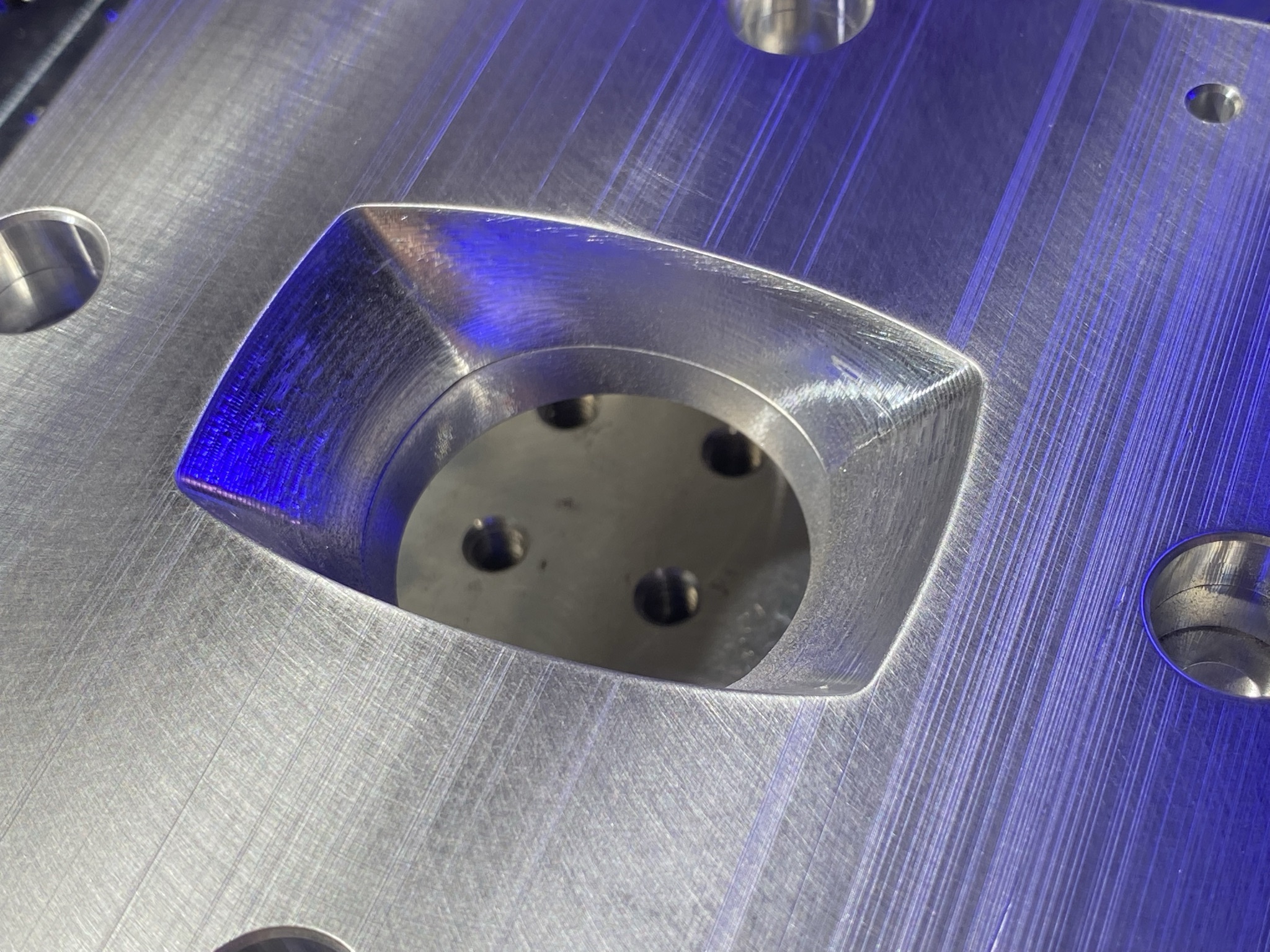

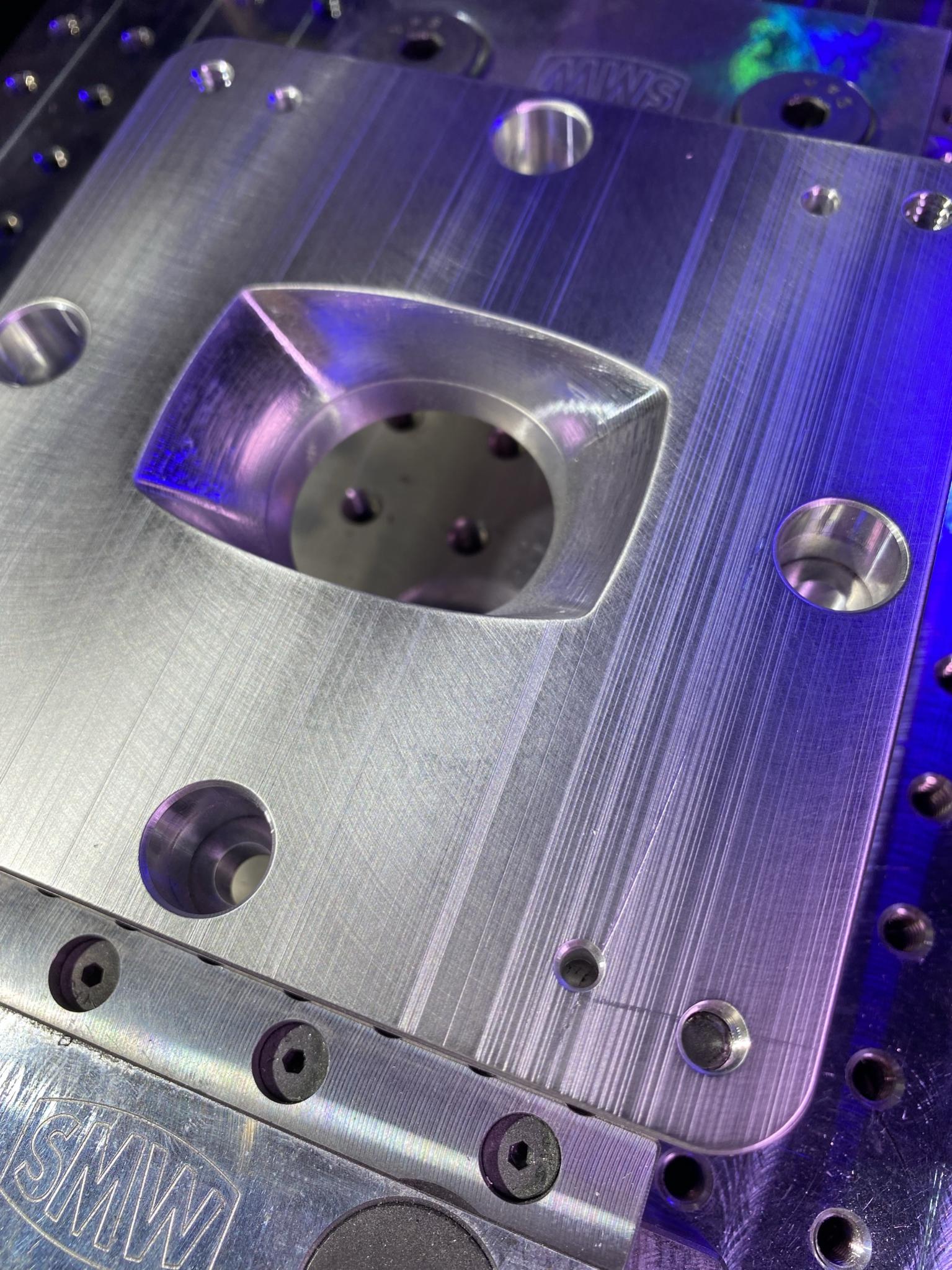

Over the past few weeknights I created the toolpaths for the throat adapter plate. I also went on a little side quest and learned how to use the CNC to do thread milling. That was an adventure. The 1/4-20 threads that mate the two plates together were milled on the CNC using a thread mill, first time I've ever tried doing that.
In retrospect, I could have made the forward half of the throat adapter plate out of baltic birch instead of aluminum and it would have made the whole thing lighter. But I've been enjoying working with the aluminum and weight is not as crucial a factor in my expression of the SynTripP design.
Eye candy attached.
Eye candy attached.
First. Very nice work! You are making me think about making this just to listen to it! I'm partial to Planars for the high frequency so I may do that instead. Are you considering posting your files? I wouldn't blame you for saying no. It's a lot of work to make these up.
Second. BB takes a wonderful thread and the thread has greater pull out resistance than even a screw. I use BB to make many jigs and fixtures. Machine screws are wonderful to use to assemble and take them apart. And holes sized for 100% thread cutting are the key to this. A little paraffin wax on the threading tap and you are whistling through them with a drill.
