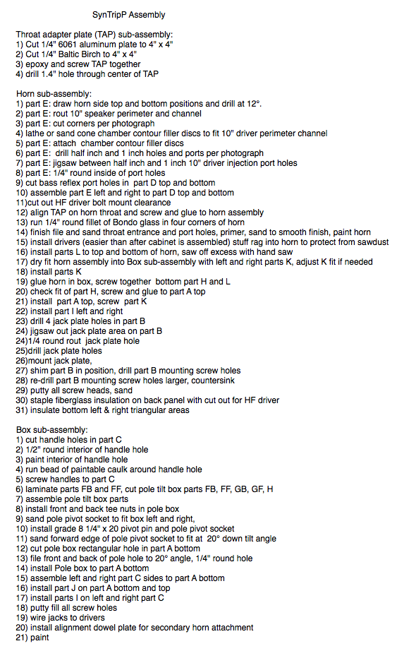

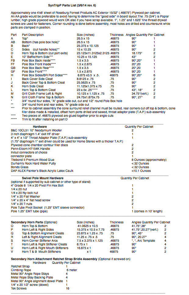

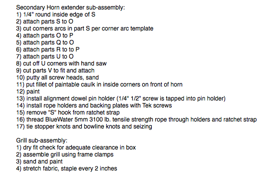

Completed parts lists and assembly instructions:

FinBot,
I allowed .125" space for clearance, after painting both parts with Duratex there is little space left between the parts. Depending on your level of accuracy, paint type and technique, less space may be required.

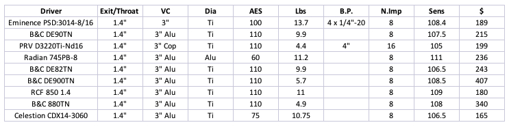

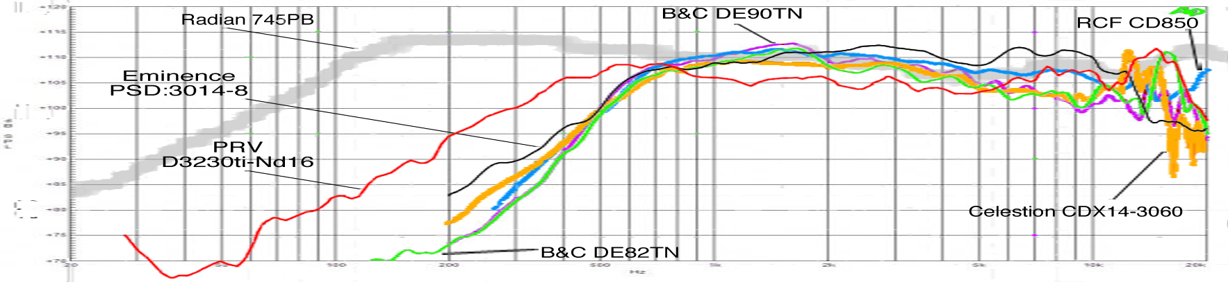

I searched for compression drivers under $300 that fit the recommendations of this build (1.4" exit, 3" diaphragm, etc). I re-scaled their factory frequency response plots (found on their respectable spec sheets) to match one another's scale. I also compiled a simple spreadsheet to make other comparisons (i.e. AES power, approximate cost [of course this will vary depending where you order from], nominal resistance, sensitivity, etc), just to reduce some "spec sheet sifting" time.
If anyone would like me to add or remove a response trace (it is a little cluttered as of now) for better viewing/comparison reasons, I am willing to make edits.
See below:

I am starting to 3D model these now, with a view to end up with cut plans.
See below:
How about this new Eminence 1,4" driver:
Driver Detail | Eminence Speaker
The N314T8 driver looks like an excellent deal.
Though I am pleased with the response of the Celestion CDX14-3050 drivers used in the SynTripP, for the cost I had expected a closer match between drivers than what I measured.
The Eminence HF drivers (PSD 2002 and APT) I have owned have had unit to unit variations of as much as 6 dB at various frequencies, hopefully these new drivers have better quality control. Eminence AES ratings are always indicative of their power handling, at 100 watts 800 Hz 12 dB crossover the N314T8 is certainly up to the task.
Art
