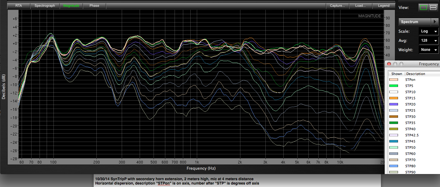

The chart is the SynTripP with secondary horn extension horizontal dispersion measured at 2 meters above ground, mic at four meters. Ground and building bounce makes the response look quite a bit rougher than later tests done at four meters high.
  • 10:30:14 SynTripP with secondary horn extension.png
