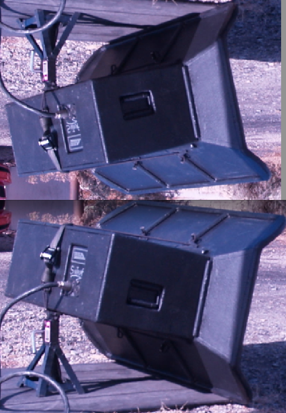

SynTripP: 2-way 2-part Virtual Single Point Source Horn

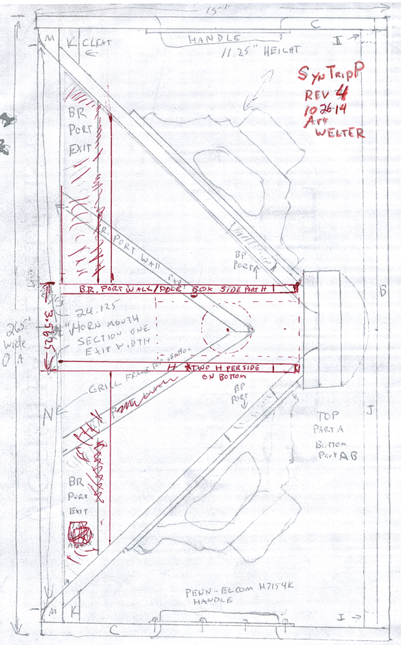

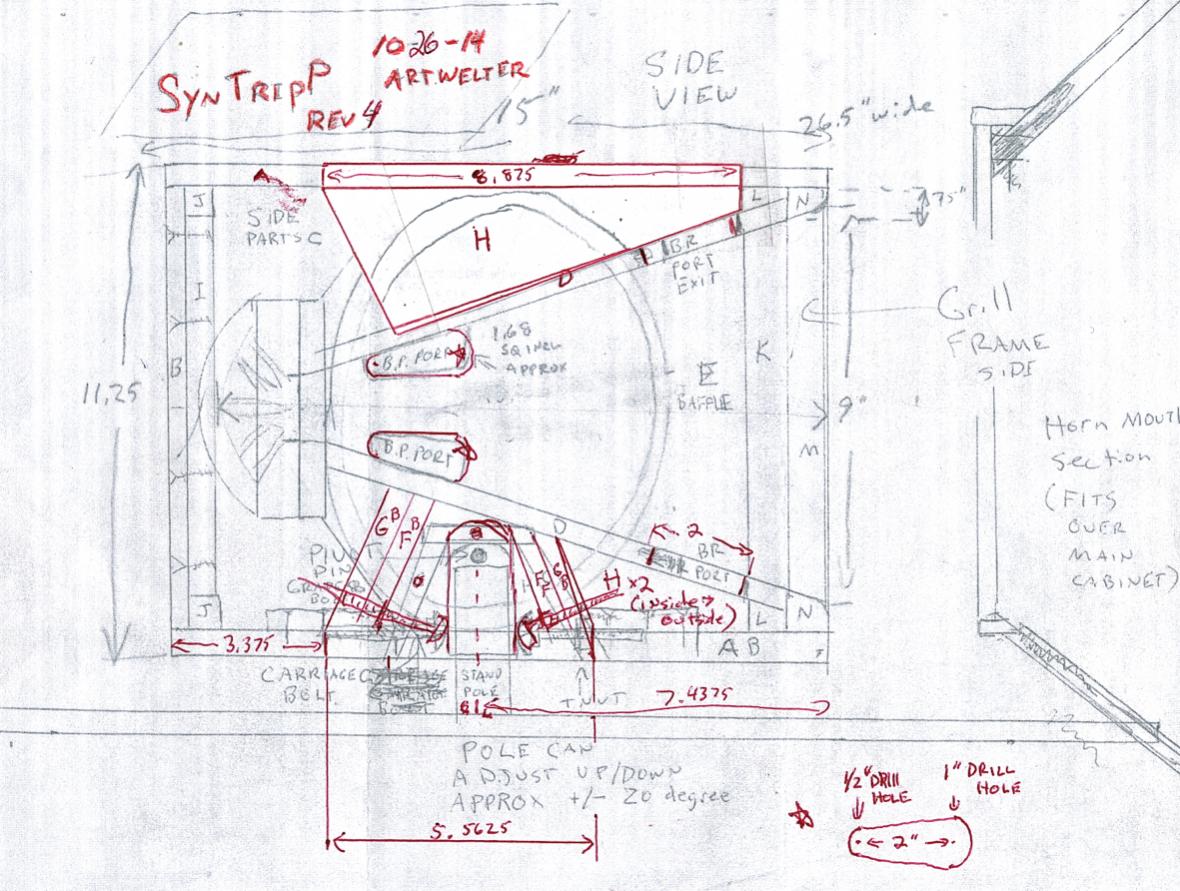

There are six of the 1.4" aluminum/Baltic Birch throat assembly parts (difficult to make with typical woodworking tools) available for sale in the "roughed in" state.
Art
  • SynTripP Side View Rev4 10:26:14.jpg
  • SynTripP Top View Rev4 10:26:14.png

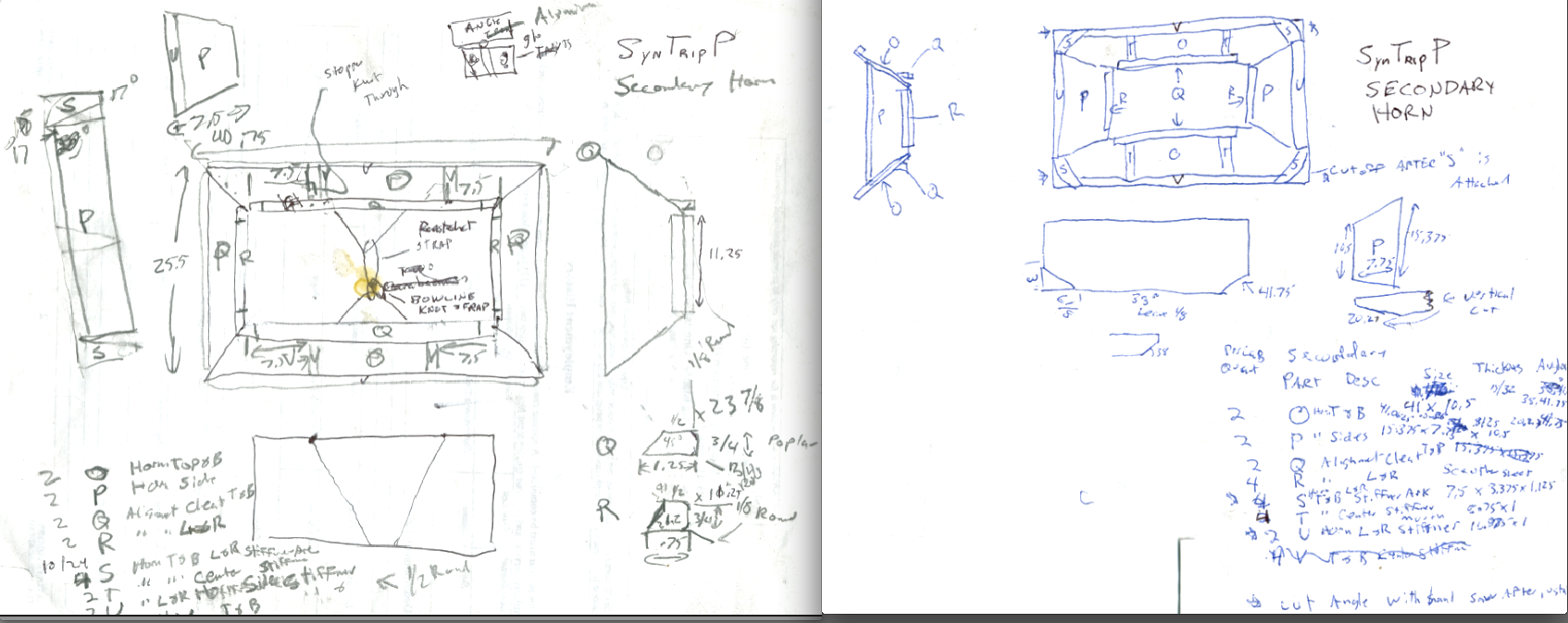

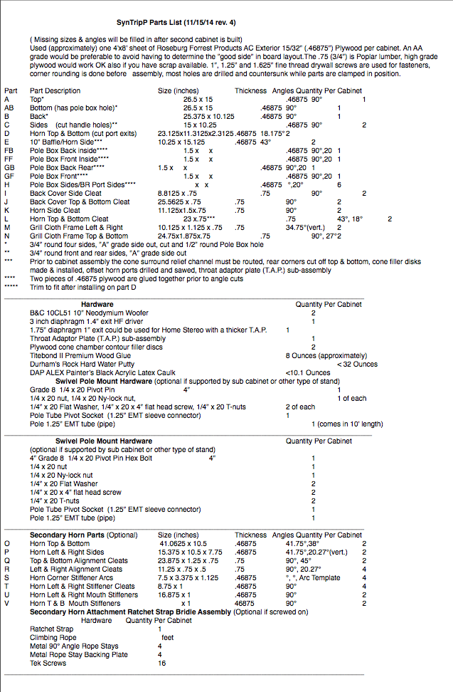

  • SynTripP Parts List (11:15:14).png

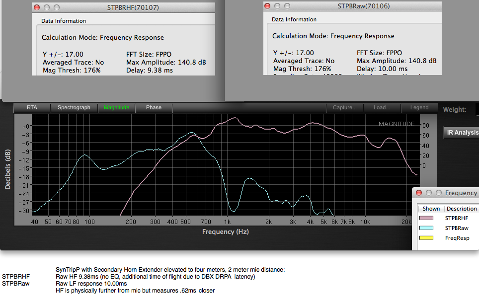

@ weltersys

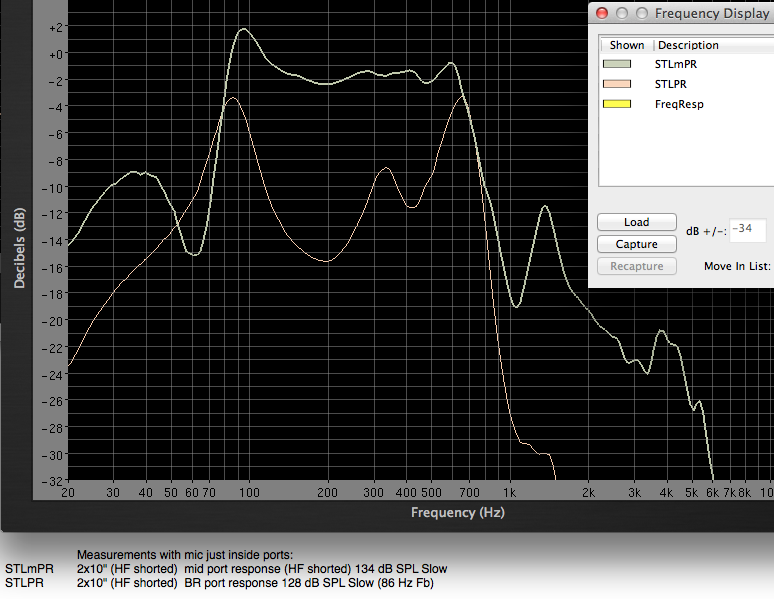

An F3 of 82 Hz is excellent, but how is that achieved with such a short path length ?
Also, what are the 1st etc port resonance frequencies, & how have you tamed them ?
Is the 0.4mS HF delay to better integrate the drivers @ the Xover point, due to them having different characteristics etc ?
Weltersys can answer with specifics but bass reflex assist (re-injected into horn near mouth opening) is used to go below 100Hz. The port resonances (circa 1kHz) of the main bass injection ports are above the XO point (circa 800Hz) by careful design of port area, location, and driver chamber volume, through models and simulation in AkAbak and lots of testing. See development thread for details. The bass reflex ports if not carefully done (too long for example) can contribute a negative port cancellation peak around 600Hz that can be avoided by keeping port length shorter.

1)An F3 of 82 Hz is excellent, but how is that achieved with such a short path length ?
2) Also, what are the 1st etc port resonance frequencies, & how have you tamed them ?
3) Is the 0.4mS HF delay to better integrate the drivers @ the Xover point, due to them having different characteristics etc ?
Zero,
1) With the large secondary expansion, the SynTripP horn has a DI (Directivity Index) in the range of 11.25, it loads down to around 100Hz. The BR (bass reflex) ports add 3-5 dB gain in the Fb (box tuning) region, and also reduce excursion considerably compared to sealed. Clean LF output capability ported is around 10 dB (about twice as loud) more than sealed. "Normal" operation with the 4 BR ports open results in an F3 of 82 Hz, in "step down" mode with 1-3 BR ports covered, or all four ports covered (sealed) results in 5 different responses which can be seen in the chart labeled "SynTripP LF Raw +0=98.6 dB" in the OP.
2) The rather unusual port design "tamed" the port resonances, their response can be seen in the chart below. The upper BR resonance peak is at 700 Hz, when the mic is moved out from the BR port cavity, the peak reduces compared to the Fb BR peak so much compared to the horn output it's effects are quite minimal (under 1 dB) on the response.
3) The .4 ms delay is used to compensate for the "time of flight" difference between LF output and HF. Though the HF driver is physically further from the measurement mic, it's output arrives .62ms before the BP (band pass) LF output. The .22 ms delay difference between .62 and .4 result from the analog style EQ and crossover filters used, and the underlap (800 Hz BW24 LF, 950 Hz LR24 HF) in the electrical crossover required to achieve the desired acoustical crossover.
Art

So it's the re-inject trick that helps it achieve that. Some time ago on here i posted a pic i drew of doing that, & wondered what the result might be. I don't "think" i got a very positive answer, @ the time ! It wasn't on a horn though.
@ weltersys
1 - I understand about tuning boxes, having done it many times over the years. It's the shorter path length, compared to a "typical" horn, which achieves that f3 that intrigued me.
2 - OK
3 - As i thought, & what TD "sort of" mentioned in other threads, about his xovers/alignments.
All the best with your continued nice designs & builds, & Thanx to both of you 🙂

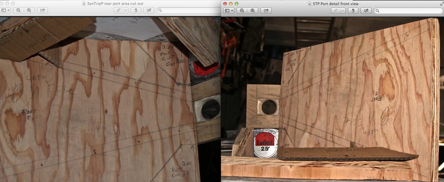

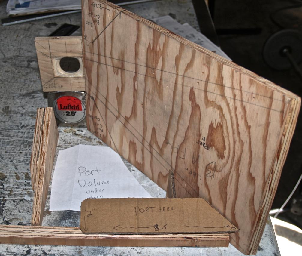

Bob,
Domestic life has thus far precluded a detailed "build guide", but the plans in post #41 are near complete, the change in the port from the original is in red ink.
The pictures below give sizes of the BP and BR port entrance and exits.
Art

  • SynTripP Port area:volume.jpg

Part E

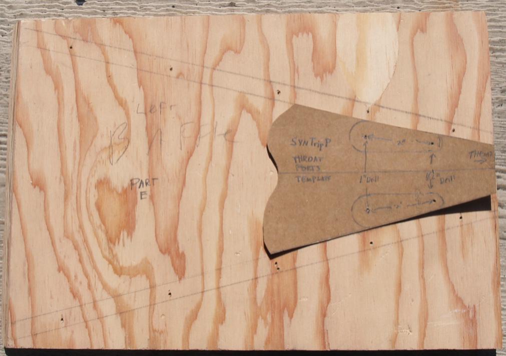

Hi Art.
Is the 10" baffle, part E, a squared shape that the entire driver is mounted against?
Are the E pieces in the pictures above finished, and there will be no more cuts applied to them?

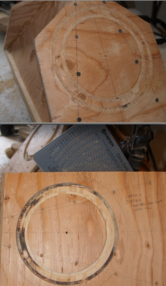

The rear corners of part "E" are cut off to allow the proper port entrance size.
The center picture in the previous post shows the cut off penciled in, the picture below shows the channel routing which must be done before assembly.
