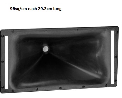

The BMS 4594HE on a RCF HF950 has measurably better polar response than the SynTripP or any of the basic "Keele break" straight sided two-part conical horn designs. It also appears to be measurably smoother, requiring less equalization to remove peaks and dips.
The slightly "pinched" throat does cause some diffraction issues, but that goes with the territory of wide dispersion and a 2" throat. The smooth transitions employed in the RCF HF950's flares are a far cry from the hard chines on the original constant directivity horns of the mid-1970's, a practice that still continues on many designs today to reduce costs.

The location of bass reflex ports as depicted in white on the sides of the JBL 2384 would have little effect on it's polar response.

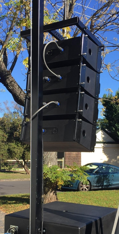

Footage from hosting 3000 people on our mobile artcar. Two main SynTripPs running somewhere near RMS, and two for filling in front at -10db.
Bass provided by two XOC1 TH118 with B&C 18SW115.
