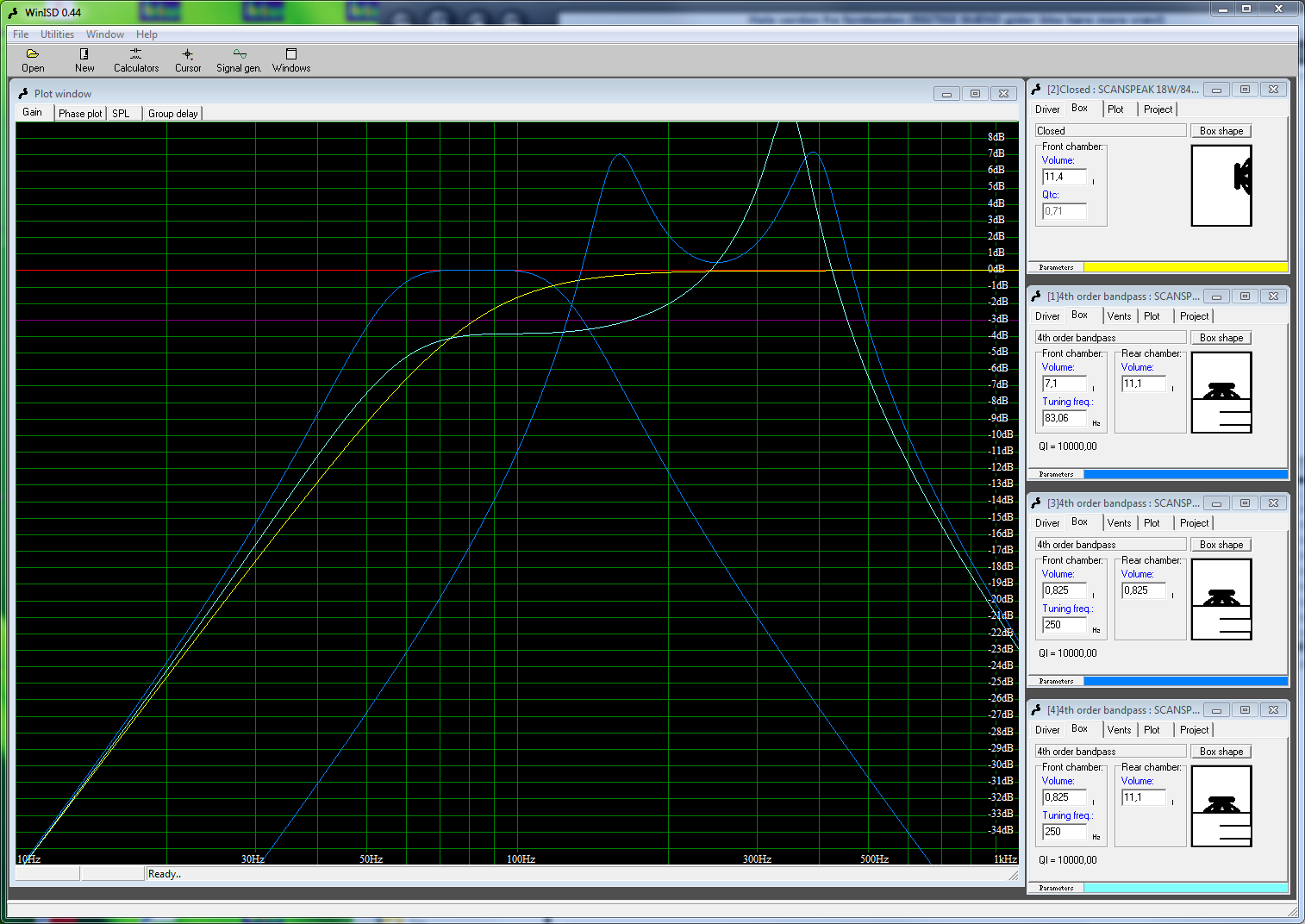

question on sound through holes, i am wondering if there's a level penalty for the remaining passband? the few lowball experiments i've tried confirms the acoustic lowpass effect but it seems there is a slight difference in level compared to the same driver mounted on a baffle with the full driver exposed. i used an active crossover to filter higher frequencies thinking that their contribution was what was accounting for the difference in average spl but still see a 2-3 db difference between the two.

i am going to go over what i've done in order to see if i can figure out why i was seeing an apparent difference. i may be thinking incorrectly but when i first noticed this i thought it was akin to insertion loss like an electrical filter.
Good old WinISD 0.44 can simulate 4th order band pass and looks like its a balance thing, what i mean is when for port we begin to ask for higher extension we make front chamber smaller and tuning frq higher but front verse rear chamber and tuning frq verse port band width all have consequences. As can be seen below using same driver for all examples yellow is the reference SPL using a simple sealed BW2 box, port band width asked of the two dark blue band passes can happen without any SPL punishment, but bablance of front verse rear chamber plus tuning frq asking for port band width in the light blue example have consequence on final SPL.
One thing that might not be immediately obvious, is that you can raise the overall output of the loudspeaker by tinkering with the volume of air in the back chamber of the midrange on the horn.
See how a sealed box 'peaks' as you make the back chamber too small? You can use this to your advantage on a horn. Basically the small backchamber raises the output on the LOW end, and the horn raises the output on the HIGH end.
If you juggle this carefully you can get overall response that's flat, even though the Q of the sealed chamber in the horn is very high. IIRC, the Q on the Misco midranges used in the original Unity horn is something like 1.5. (0.7 is generally regarded as "ideal.")
Long story short, if you're willing to sacrifice some low end, you can have a horn speaker with overall output that's quite a bit louder than the same driver in a sealed box, even if the horn isn't sufficiently large.
