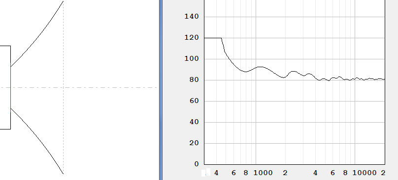

I had the thought to model it in hornresp and compare the relative power vs beamwidth to maybe identify whether any power is being lost through cancellation.
I'd have to isolate driver bandwith related effects, acoustic impedance effects, and separate the axial mode from the alleged higher order one (or more), and it's enough to put a person off their lunch.
The way I came to suspect this is by viewing wavefront simulations such as the sandbox in hornresp but I don't find it conclusive.
diyAudio Moderator
Joined 2008
I can get apparently good results with a hypex T=~3. I can supply an appropriate throat wavefront shape.. but what will work for this particular aspect, will be a profile that permits me to terminate it onto a flat baffle without pulling the shown beamwidth plot apart.
I've considered going sharply onto a baffle (bandwidth for this horn is 200-700Hz), but I'd rather look for a smooth profile that achieves this.
