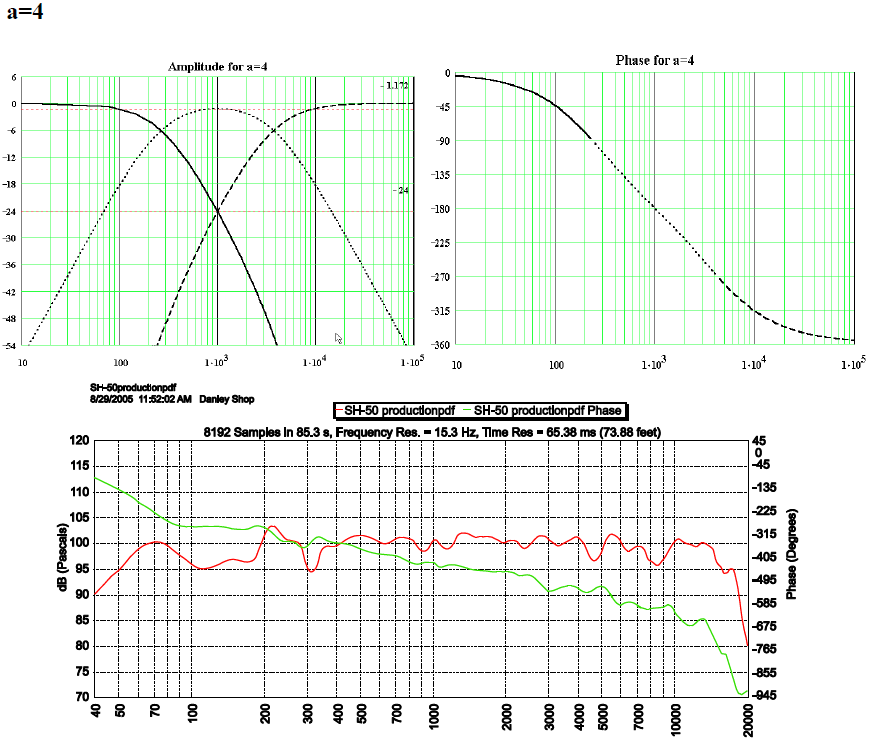

.....I guess what I'm saying is don't focus on the geometry of the Synergy horn; focus on the crossover. I have a hunch that you could use the same driver arrangement as an SH-50, and it wouldn't sound the same unless you got the xover right. And I also believe that you could probably get a lot of the same performance out of a humble coaxial if you understood what's going on in the crossover.
A qualified guess what is going on for SH-50 is ala Duelund XO paper (pdf-file attached below) with a set value for "A" parameter in area 2,8 up till 4,0.
As seen in attached picture XO blending adds 360º phase turn but as a more strait line than more traditional types, add to this two times 180º because of system stopbands and we now at 720º phase turn sum for system. Looking SH-50 datasheet think also show this particular strait line as phase turn over hole audio band, and that HF phase past -720º drop off further is because slope is a lot steeper than second order.
As i understand to get XOs from paper perform in real world one need to precisely hit those slopes acoustic on design axis and have LF/MF/HF displacement right. To get this right one need target curves for measurement program and here a link to calculator that returns a txt-file target curve for LF MF and HF target slopes http://pro.speakerbuilder.dk/synkron/ (import to measurement program).
I kind of agree? (And somewhat disagree.)
The crossover and the geometry have to be good. There's more wiggle room in the geometry....you can give up horn loaded for waveguide behavior etc. Give up too much, (1/4 wavelength spacing) and you won't be able to negotiate it in the crossover.
