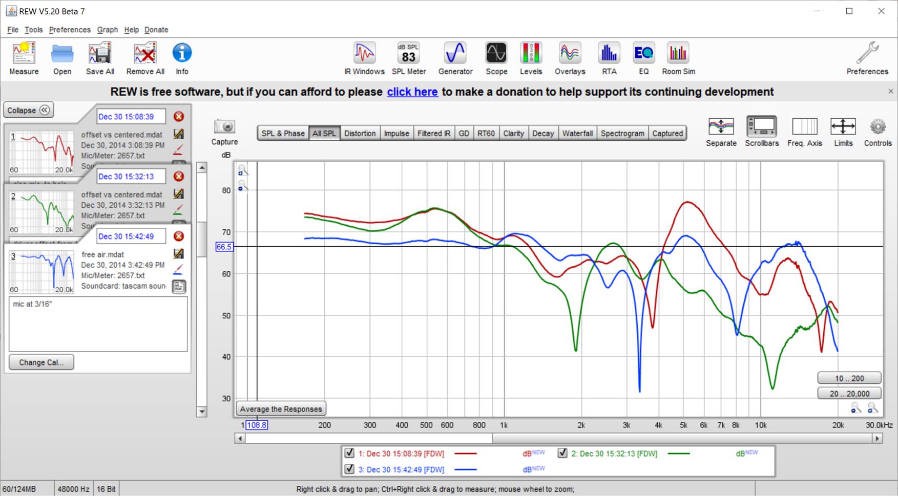

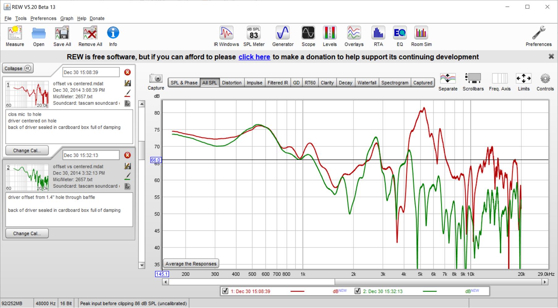

True, destructive combination starts when the distance exceeds 1/4 wavelength but because that distance in this case is only to a small fraction of the cone area, it doesn't become significant until the distance is quite a bit larger. That is a judgement based on experience - back in the day I got 8" midwoofer with an edge located port on a synergy to respond usably well past 1 khz.
But don't take my word for it - do a 10 minute experiment. Mount your woofer against a large scrap of plywood with a hole in it and do a close mic frequency response at the hole. Do this with woofer centered on the hole and offset.
attachment.php
the above data taken almost 5 years ago is for an 8FE200 which has an Sd of 191 cm2 for an effective diameter of (only) 6.13"
The offset driver peaks at 1078 Hz while the centered driver peaks at 1104 hz. Interesting that the curve for the offset driver is smoother, symmetry is not our friend!
Reactions: deanznz
...the above data...is for an 8FE200 which has an Sd of 191 cm2 for an effective diameter of (only) 6.13"...
Thanks for the real data, almost too real because there seems to be some cone break up, cancellation and cavity resonances, hard to sort it all out.
The peak at ~ 1100 Hz looks like a resonance of the speaker itself since its almost independent of the port details.
The port itself is not a point source and the maths is complicated because we are not in the far field where the maths becomes simpler.
If the offset port centre is about 3" from the centre of the speaker then we expect 1/2 cancellation at ~ 2.2 kHz and it should start to roll off at 1/4 WL = 3", say 1.1 kHz.
This looks about correct, with the earlier mentioned speaker resonance also near 1.1 kHz superimposed.
I calculate the first null is actually a little less than 1/2 WL so the fact it is just a little less than 2 kHz rather than 2.2 kHz makes sense.
Or it could be luck with the estimates!
So I think the 1/4 WL rule of thumb looks pretty close.
...the curve for the offset driver is smoother, symmetry is not our friend!
Yes, fair point, "ideal" position to minimise cancellation is not the best for smoothness.

Thanks for going through the arithmetic. I was just happy to find the measurements. A 5 cycle FDW cleans up the picture. I added a clos mic of the unbaffled driver there for comparison.
attachment.php
So 1/4 wave rule successfully predict where it starts to roll off but that is not the highest possible XO, depending on several other constraints that would exist and that was my initial point. The rolloff due to this effect is gradual and can be equalized up to a point in order to make a design "work". In this picture you can easily see how much eq would be required to make up for this rolloff. Tuning of the bandpass chamber might also be effective in this regard. In fact, bandpass chamber acoustic low pass filtering might have some responsibility for the roll off that we see.

...A 5 cycle FDW cleans up the picture. I added a clos mic of the unbaffled driver there for comparison.
Yes, that helps quite a bit, demonstrates the ~1.1 kHz speaker resonance I expected, and the fall off from ~1 kHz to a 2 kHz null with the offset port.
Really nice fit to the theory.
So 1/4 wave rule successfully predict where it starts to roll off...and can be equalized up to a point.
