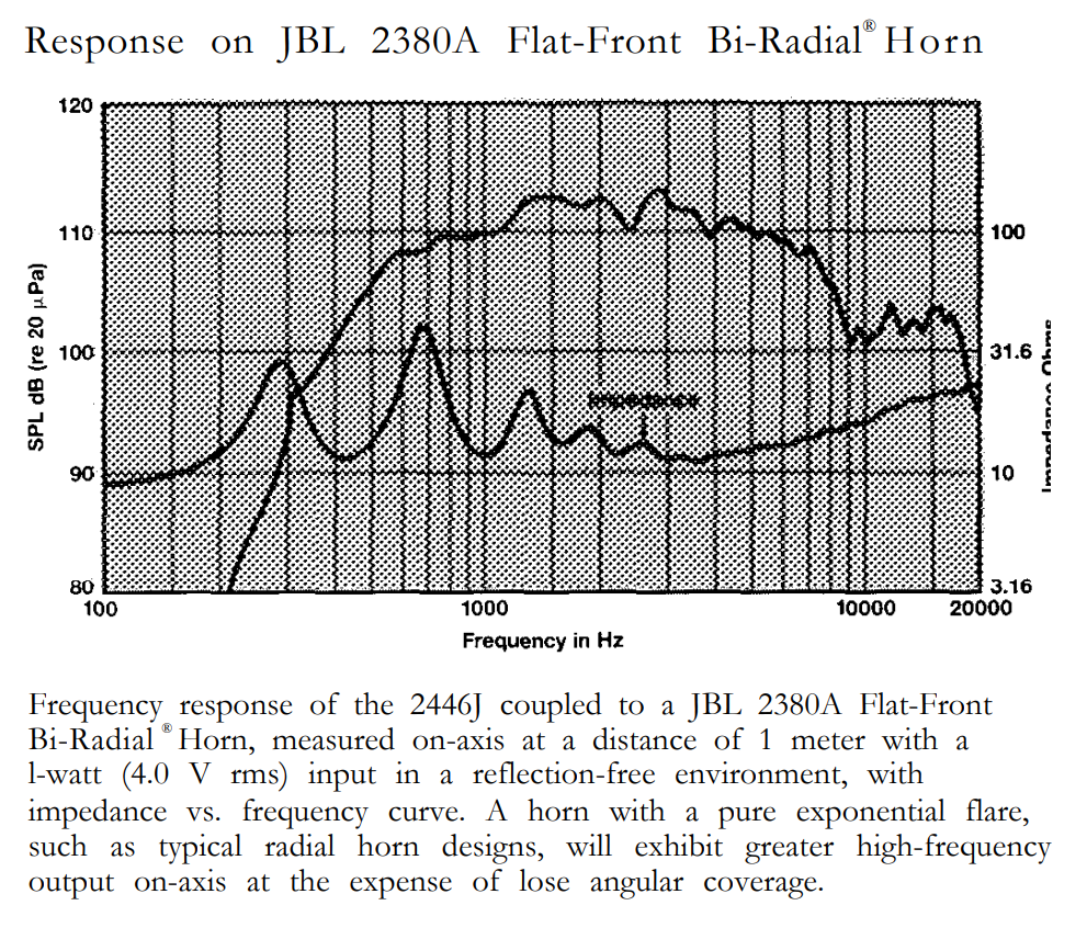

Maybe some extra info is warranted about the design, as most you actually raise some very good points.
1. I'm using the JBL 2446, which is a fine driver and very powerfull. On the other hand I'm not sure it's gonna be the driver I'm gonna end up with. If I do keep it as the permanent driver it's gonna be Be upgraded. It has a -6db point of 550hz.
One of the main reason why I designed for a 650hz crossover is when looking at one of the drivers I really want to end up with, the Radian PB951. It has a natural -6db point of 650hz. I mean 'natural' because I plan to push them to their max at certain points.
The coaxials do remarkably better, and can easily use a 500hz (maybe even 400hz -6db) crossover.

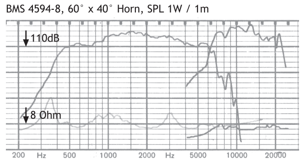

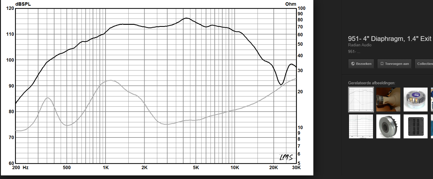

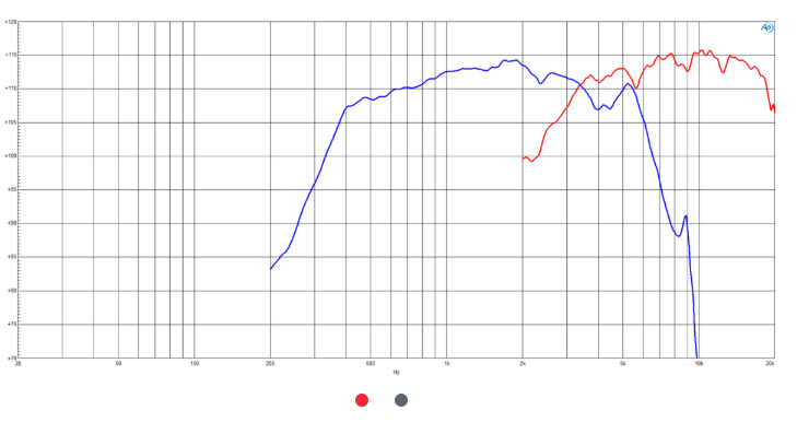

..the JBL 2446, which is a fine driver and very powerful...
...Could move up the crossover of the JBL 2447 and of the Radian PB951 pretty close to 500hz.
I started with a JBL 2447, similar to the 2446 but improved, and also think a 650 Hz looks feasible for that driver.
But there is some complication, if you want to keep the crossover low then you need an exponential(ish) horn to load it well.
This leads to the usual trade offs - polar patterns, diffraction slot anomalies and increased depth, with consequent time offset and space restrictions.
(I went to the newer neodymium JBL 2453 driver just because it was much smaller so I had more depth to trade.)
The coaxials look better if you are determined to have a 15", this is what Chris uses for his K402 15" MEH.
If you don't use a coaxial then the JBL 2169 is purpose built as an MEH driver to match with a CD, used in their top of the line tour system.
