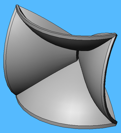

come to think of it, that 15" woofer horn had an offset driver with an offset (from the center of the cone) port, so maybe the thread will be of interest

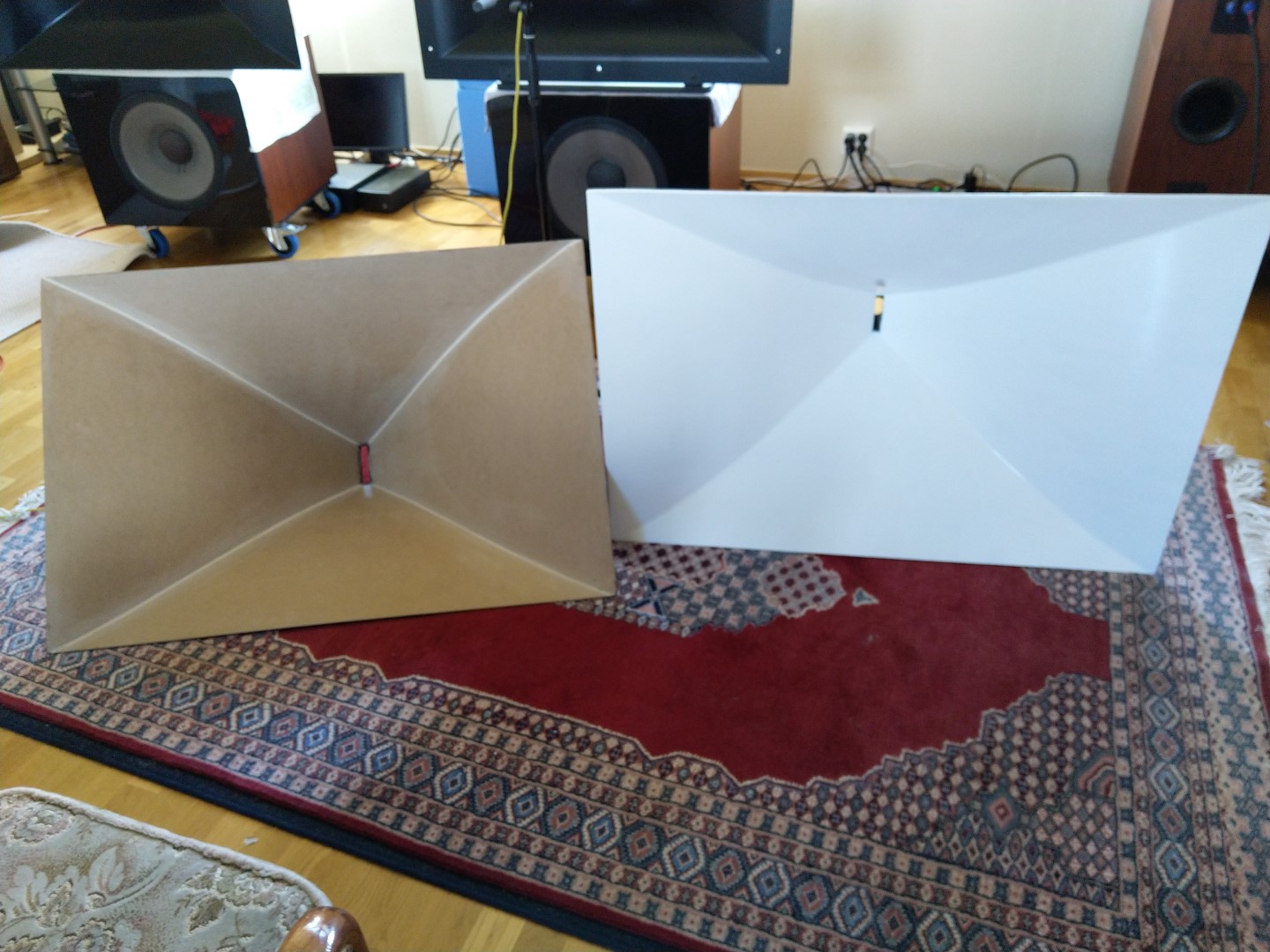

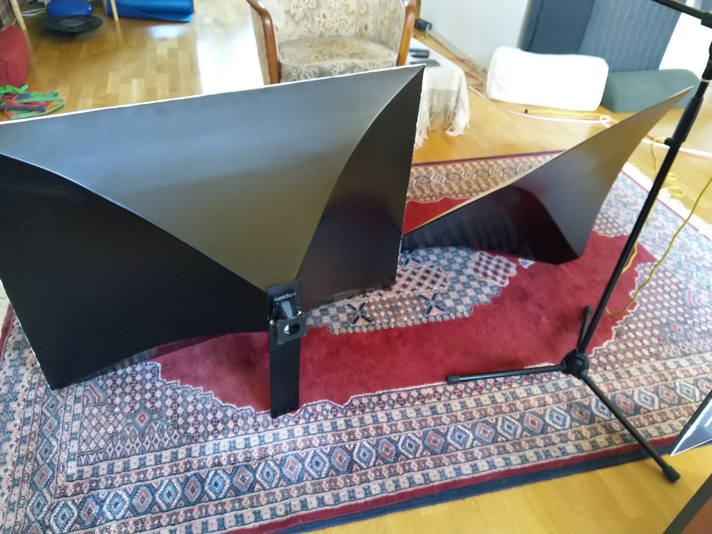

It's a large "bi-radial" horn based on the K402, designed by Omholt and Don Keele. I have the first pair ever build (the actual prototype).
They will not be sale to the DIY community, as they will be sold as a complete unit together with a brand new midbass horn.
"bi-radial" horn based on the K402...
The sales pitch for the K402 emphasises that it's not bi-radial, so it's not clear to me what you mean.
A bi-radial horn based on more-or-less the opposite?
Can you post a picture?
If no picture then could you describe it compared to a JBL 2360?
That's more what I had in mind, bi-radial, about the same size, and in the Don Keele tradition.

Hopefully I can clear things up a bit. It's bi-radial in the sense that it has a diffraction slot, a description that was also used for several JBL horns. Actually JBL never had a true bi-radial horn. Their so-called bi-radial horns were either only radial or curved sides and top-bottom extruded. But they had a diffraction slot.The sales pitch for the K402 emphasises that it's not bi-radial, so it's not clear to me what you mean.

The correct description for this "Keele & Omholt Tech." horn would be flat front horn; extruded sides and top-bottom with a diffraction slot.
Droco's horns were the first prototypes. The next pair had some modifications with better build, stiffer and a slightly more gradual exit. It measured a tiny bit better on-axis.
The goal was to build a horn that was better than the Klipsch K402 which were used for reference. I believe we achieved that goal after hours of AB testing besides some directivity measurements. The horizontal polars Droco showed (which he wasn't allowed to publish by the way 😉) were indoor measurement where the room contributed. The beam width of the polar of both our horn and the K402 is wider than it actually is. Other than that, they might be quite accurate.
Droco mentioned that the horn would be used in a complete horn system. That may or may not happen. We're working on a second horn now that will be a true bi-radial horn by the strict definition. Or we're calling it a dual radial horn to avoid any confusion. The drawing below isn't the final product by any means but it gives an idea.
