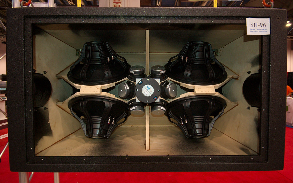

Also, yes! Copy Danley 🙂 It's because the woofers are placed so far away from the taps that I figured it be at least possible. Just want to know what to take in account when doing this. Need to know the things I'm giving up to see if its worth it (placing them to the side of the taps allows more woofers).

I actually already did all the modelling on the synergy, it's just that the woofer location vs the tap placement is something I cant model. Tap placement is fixed on the horn (also I think it's the edge of the tap to the reflective surface), and will be at 13cm (~5"), as this gets me the aucoustic crossover I need.
Then I need to decide how to place the woofers over the port. Just 1 woofer with 2 corner placed elongated (aka rectangular) slots which would mean a symmetrical placement OR 1 slot located to the very side of the woofer, which means being able to use twice as much woofers which gains me 6dB. The woofers are too big to place 2 on the same side of the horn (so 4 woofers in total) AND place those slots symmetrical over the woofer.
That is what all this is about. As you can see in the picture from the SH96, you can see the 15" woofers only overlap on the very edge with the horn, where their elongated rectangular slot is.

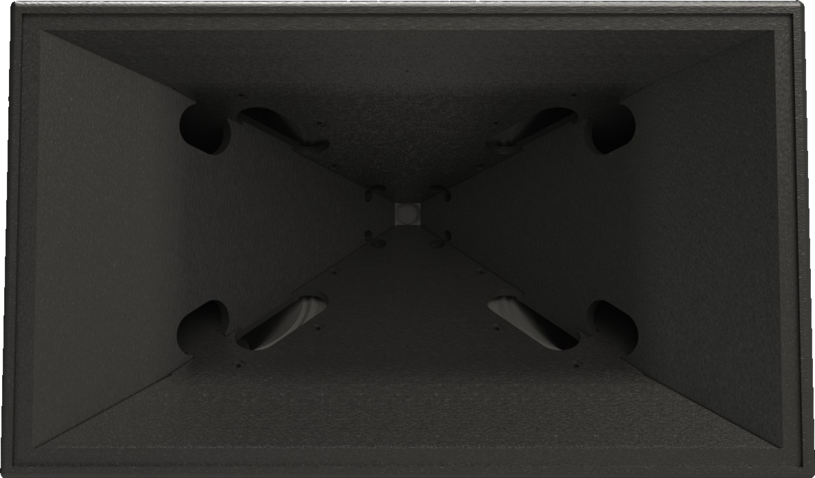

See another example of the SH96 where you can clearly see the woofer only has its edge placed over the tap, not its center.
True you can't simulate the effect of the tap location relative to the center of the woofer cone in HR. Experience shows you won't have a problem unless the furthest distance from the tap to any point on the woofer cone approaches half a wavelength. If you are in the "approaches" region as opposed to "exceeds" it likely still works, just causes you some gain near XO, which should be no big deal as you are targetting an acoustic output curve for the woofer that is -6 db down at XO.
