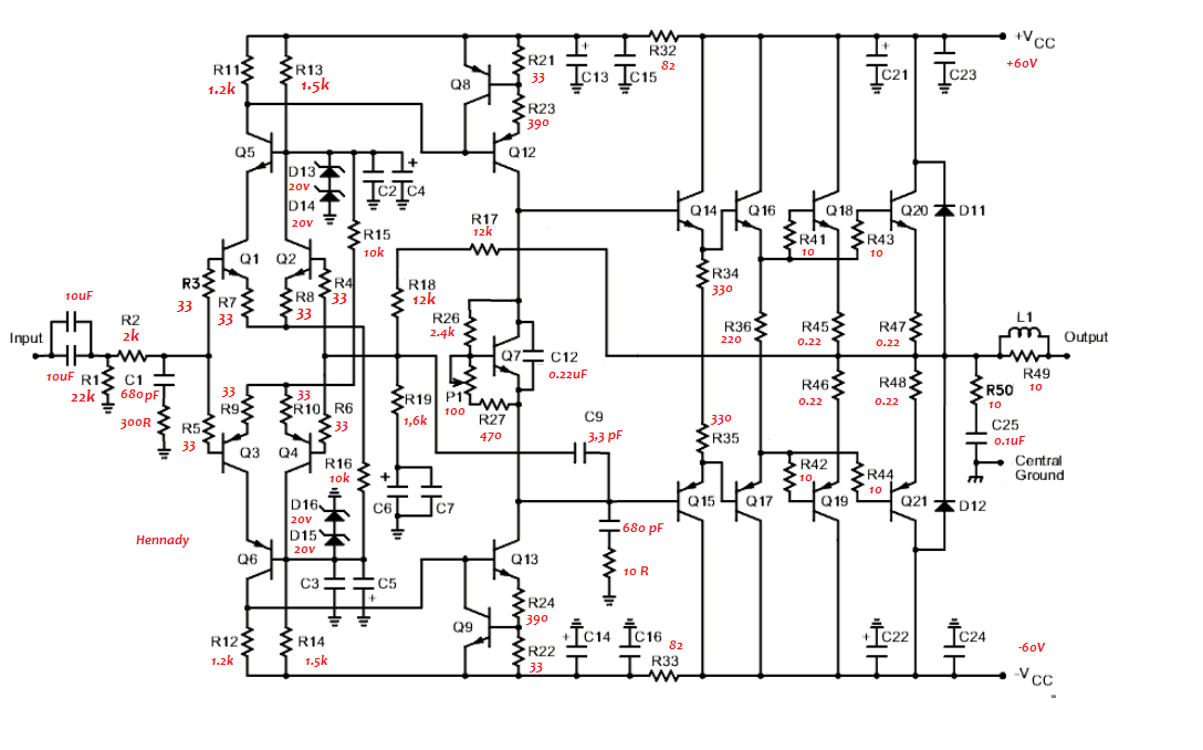

ok, here is my vision of the correction of this amplifier.
P.S. the initial current of each pair of output transistors is 110 mA.

The article is describing a known weakness of emitter followers: they are bidirectional. Some output gets fed back to the input.Bonsai said:See pages 19-23 in the link below. Although this mainly concerns itself with small signal buffers, the theory applies to power buffer stages as well, and especially in the case of EF2/3 and CFP.
https://worldradiohistory.com/UK/Wireless-World/00s/Electronics-World-2003-10-S-OCR.pdf
You, me, and Rotel all fixed the Leach amp in similar ways.Hennady Kovalsky said:ok, here is my vision of the correction of this amplifier.

Quasi complementary stages and CFP stages issues to note, the funky business around Q4. 390pF on R27 should take care of it
Who can make an educated guess at what was found to have caused the 8MHz oscillation, quite interesting find, and no its not the Zobel, video loading soon
On my own amp experiments, I suspect that mounting the outputs (and the drivers) on the same HS may cause (another) unwanted parasitic C, so I make changes in that regard....
Also, big C near the outputs may cause big currents to run on G and couple to other paths--> I decouple the G to HS.

Thanks @maxlorenz, good ideas there that actually work great for CFP, yes the grounds are decoupled.
