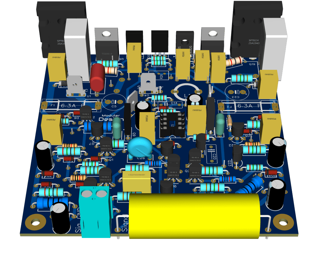

The last step is canning the output transistors, bridge rectifier, transformer and shielding the high current conductors

Hear a 2n5551 sing its linear heart out. Class AB is probably eternal, which row in that eternity symphony occupies? time will tell
+/-55VDC,16400UF*2, 4ohm, cant do 2 ohm cause single pair on prototype

Output stages are quite interesting the choice of using a lower ft and lower gain bjt as output comes into play, will it be more stable? Output stages are a world onto themselves and one has to consider local vs global feedback, ef stages are simpler but working with quasi stages brings out the nuances of output stages
Are these the most stable combos for output stages, where we move from high ft to low ft and from high hfe to low hfe, now to to keep that phase at -6db zobel no load 180 degrees, but with the MJL we have to loose those base stoppers for the pre drivers, the dilemma we face with high gain or high transconductance is stability even a sneeze can set off oscillation, this high gain also comes with higher distortion as seen with Darlington's or mosfets, would 5200 and 1943 and other high gain high ft types be better suited for simpler 2 stage outputs? Output stages are a world onto themselves and now this output stage is starting to look more like a Bryston distant cousin output stage although that one has some voltage gain

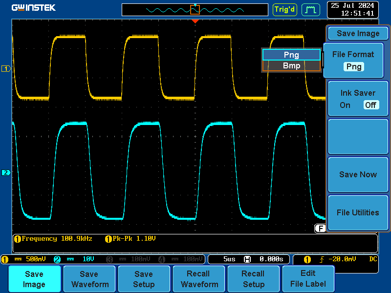

The prototype used 5200 safely and happily did 100kHz with no hint of oscillation as seen in the scopes in first thread link but can be adapted with changes to use other output bjts
To prototype and also enjoy this lovely amplifier, let me know what you hear, is your other amplifier as addictive? please use quality parts, the BOM is a guide only! substitute some generic parts with better parts, check first post https://www.diyaudio.com/community/threads/symphony-amplifier.408203/post-7576197
I have shared the economy BOM and economy PCB in the first post, this should put the project within the reach of many but not all, what's needed is soldering skills alternatively for a small fee usually the price of a subway sandwich, the board house can solder parts for you
What the BOM and gerbers get you if you can solder is that you can keep your expenses in range of $80 for two channels, this will place you in the ball park to compete with off the shelf $1500 amplifiers
