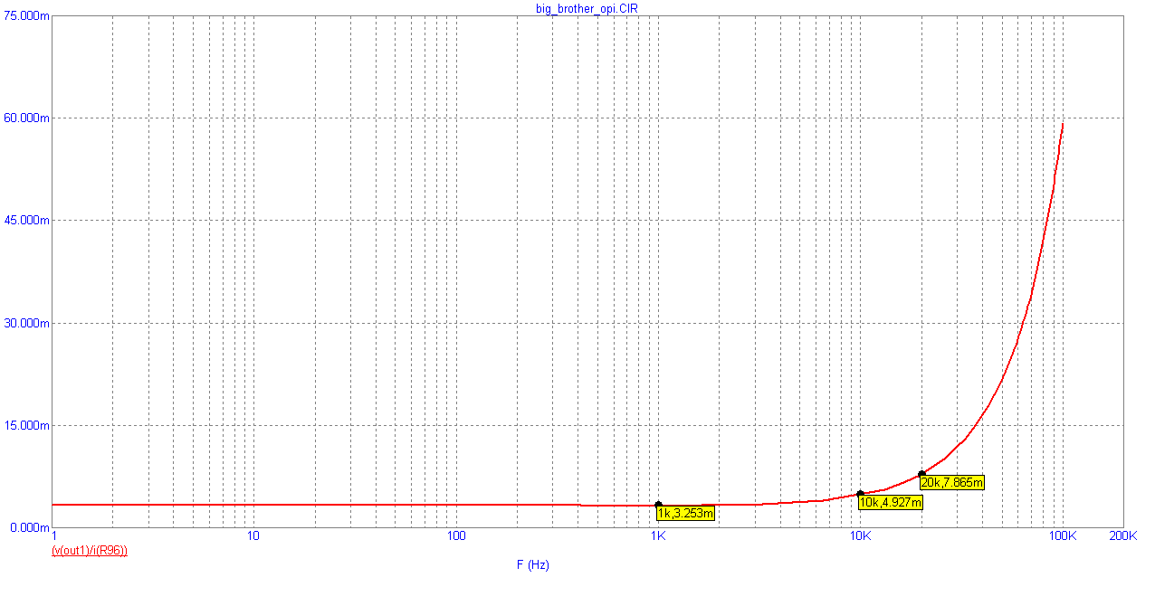

Flat output impedance is not exactly possible , since
most, if not all , of the amplifiers have an open loop
frequency roll off that is well under 20khz , so the
output impedance , modeled by the negative feedback,
will start to rise symetrically to the gain roll off.
That said, a value of 1mR at 20KHZ can be achieved
with a low complexity circuit, and should be enough
in respect of the condition of audibility that you mentioned.
I disagree. Pole-pole-zero compensation with triple EF (and high Ft bipolars), or MOSFET output, allows to get flat open loop gain up to 10Khz or more (60dB of NFB or so), and then roll-off OL gain at more than 6dB/oct to get a not too high crossover frequency (where OL gain mets closed loop gain).
The 0.001 ohm output impedance figure at 20khz is unrealistic. That would be a damping factor of 8000 at 20khz. 400 across the whole audio band is a more realistic figure.

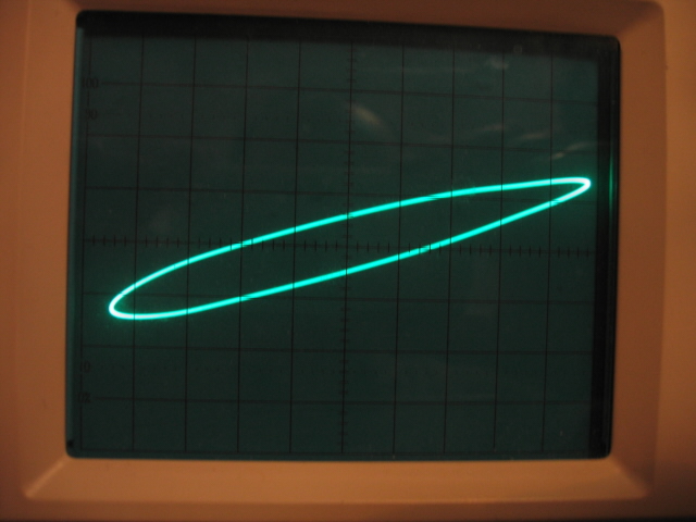

I like to inject current into amplifier output terminals, and to display voltage vs. current then at different current amplitudes and frequencies. You can see crossover output impedance then. This one is for SymAsym amplifier at 10kHz. I do not remember V/div and A/div unfortunately 🙂
