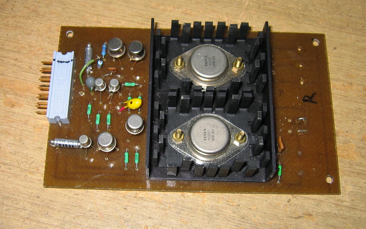

Carlos,
30 years ago I built this. Please look at the circuit topology, I guess you might like it 😉.
Best regards,

Carlos, since you don t understand something, you say that you
are not interested, even you did open this thread and asked for clues..
But you re still asking for clarifications using Hugh as a cover..
Those who designed , or rather copied those amps without having
no clues about how they really work, made both a critical mistake
among others..
Both are not compensated the right way at all..
The first one use two shunt caps of 47pF which are not enough,
plus a 100pF (!) as lead cap , a huge value with catastrophic results.
The second one has no compensation at all , only a 10pF cap as
lead compensation, that s not good either, this amp wil produce
AM modulation when a signal is applied...
Funny that they made the same mistake, but in two exactly
opposite directions !!!....
With such fatal misdesigns , there s not even the slightest need to
go further, i let other people find the remaining issues of these
complete failures...
If you did build these pseudo amps, i now understand why you critisized
my own design on the same topology.
I remind you your own words , that is, build the circuit rather than
using those poor designed ones as equally poor argument to trash
other people s designs...

No need of glasses, even a blind man would see
the errors, but it s true that there s no worse blind that
the one that refuse to see...
Have a nice day....
Have a nice day....
Wahab,
Thanks for the fault analysis. I see what you mean, clear enough. Did you notice the non-equal input bias and series feedback resistors?
On another matter, I have acted entirely independently. Carlos is neither 'using' me (interesting word!) nor are we discussing the thread. He's a big boy, and he can take care of himself. OTOH, this forum is not solving world poverty, aids, or averting war, so I would ask ruefully what the point of all this angst really is. A is cleverer than B perhaps?
I simply like good manners. I make no claim to any expertise, but I do like people to be civil and where possible, positive. I come here for relaxation, and when I see all these warring chieftains, I scratch my chin, but now and again I comment.
Both the faults you raise would presumably be immediately evident on the testbench, which means that they may not yet have been built.....
Hugh
Hugh

Hi , hugh
Glad that you did also notice some drawbacks...
Don t worry , i ve got absolutely nothing against Carlos ,
I just want to shake him a little , so he will improve
his skills , and perhaps will battle those terrible designs
that are spreading in his country , ruining listening experiences
of guys unaware that they are plagued from the start.....
