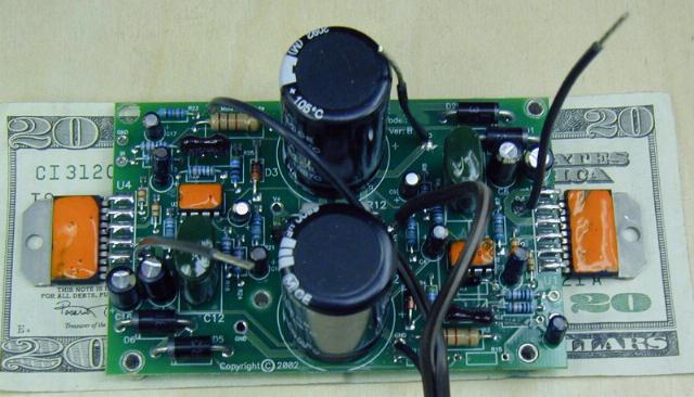

That would be the LM3886-based composite amplifier he claims to have designed and built. Apparently it has 100dB of global feedback at 10kHz and is unconditionally stable into any load, with no output inductor.Excuse me, 125dB at 10Khz? 225dB at DC? Are you sure? It seems quite far from practical. Where is so much gain coming from and how it is made stable?
A remarkable achievement indeed, especially as he claims to have designed it eight years ago, but didn't know what group delay was until last month. See here.
That would be the LM3886-based composite amplifier he claims to have designed and built. [/URL]
And it's not a gainclone, nor for beginners. I've seen LM1875's tucked inside the feedback of precision op amps 20 years ago. Distortion just went away.
I don't know about 100dB of global feedback at 10k, though. It was probably less.
The 0.001 ohm output impedance figure at 20khz is unrealistic. That would be a damping factor of 8000 at 20khz. .
A "little" mistake by an order of magnitude.
But still 8000 below 2khz, the freqency of roll off.

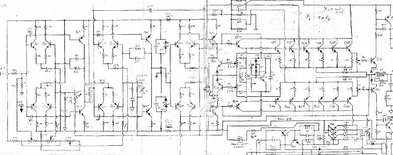

But this is off topic of the symmetric circuit amplifier. The schematic is for an "early" high symmetry amp from the 70's. Highly symmetric and yet today still so very popular.
Not everyone uses the present popular electronic models and formula for calculation of filters and an amplifier is simply a filter with gain. Just because I do not happen to use those does not mean I do not know what I am doing thank you. I am a physicist and not an engineer so as usual for us physics guys- we tend to look at things differently. Physics is the direct study of nature and not electronics in particular.
As anyone can see there is not much to this composite amp with servo. Checked the gain calculation and the LP is set to 106kHz for compensation so the gain claimed should be very close to correct via direct measurement.

The schematic you show is completely unrelated to the thing in the photo, which is what you claim to have designed and are attempting to sell in the commercial sector of this forum.The schematic is for an "early" high symmetry amp from the 70's.
As anyone can see, the schematic you provided is not a "composite amp with servo".As anyone can see there is not much to this composite amp with servo.
Regarding the amp that you claim to have designed and built, you have made it clear in various threads that you are not prepared to show the schematic, you are not prepared to share any technical details as to how it works, you don't have any measurements or test results , and you can't even offer any meaningful specifications.
Is there any point in mentioning it here, other than to bolster your claims of expertise or perhaps promote a sale?
The highly symmetric amp is the thread subject so this early version schematic, 1974, belongs here and could be of interest to some.

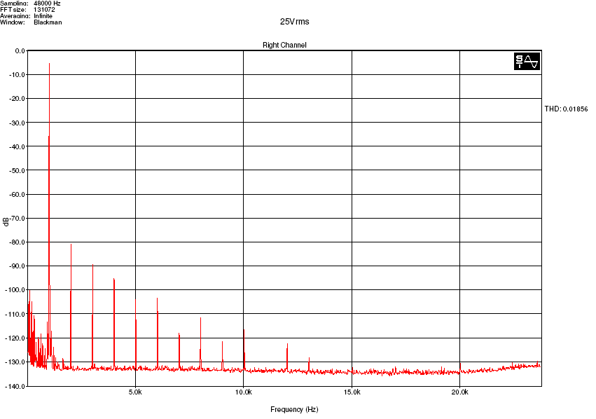

Other test results
Mr. Godfrey, on this same subject of my post in "how good can a chip amp be?" on my LM3886 test results, would you be so kind as to point me towards your post showing your test results of square wave into horrible loads, THD, slew, noise, and so on for all amps you have built and posted results for? Would really like to see those just as you wanted to see mine. Schematics also if you please. I have no interest in simulation results. Real test please. Just answer right here with the post links. That would be great and thanks!
-Sum
-Sum
