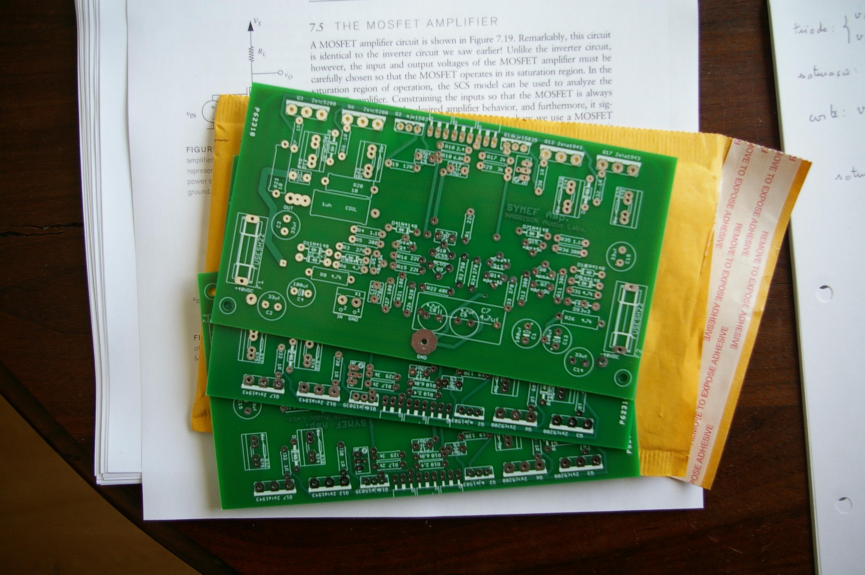

The boards are stuck at customs. In about two weeks I'll receive a letter asking me to send them a purchase bill so they can calculate taxes. They're going to check if the bill is true and then, after about a month, they release the package.
Harrison, you must have very powerfull friends!
The boards were cleared by customs in less than one day! Should be with me monday morning. 🙂
